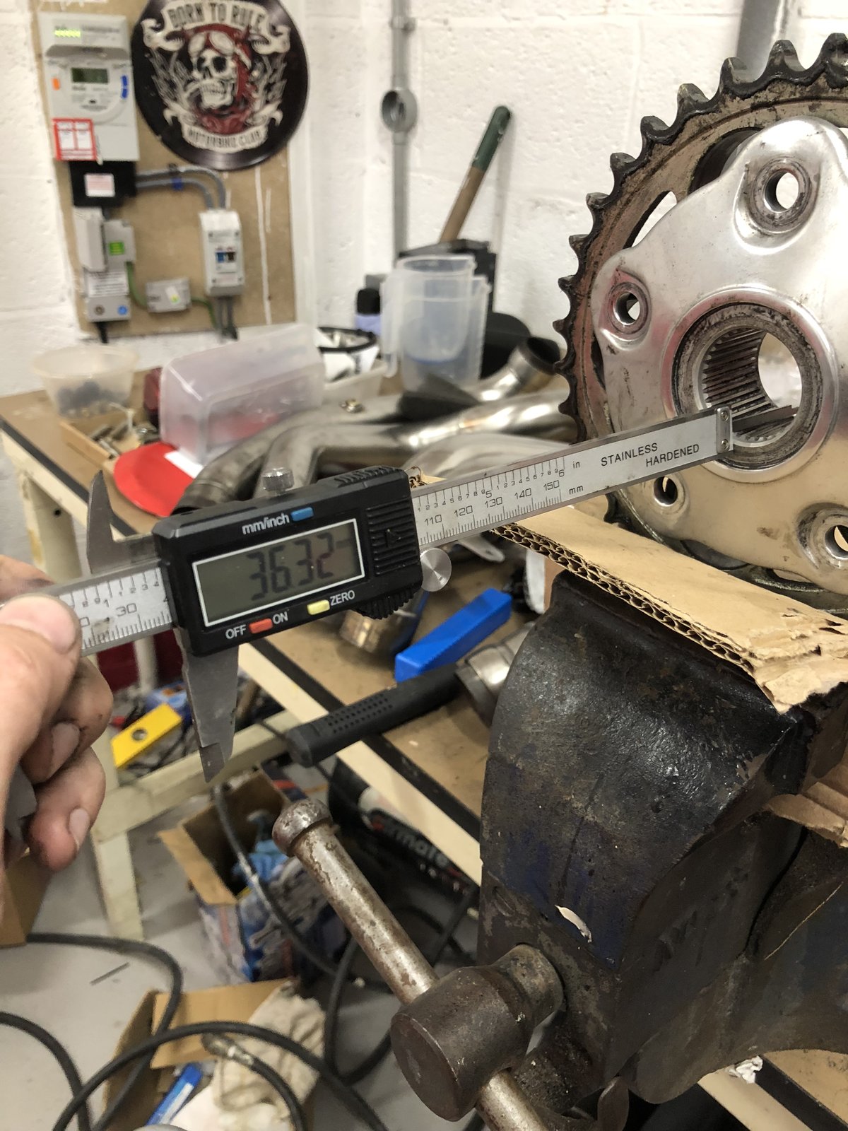

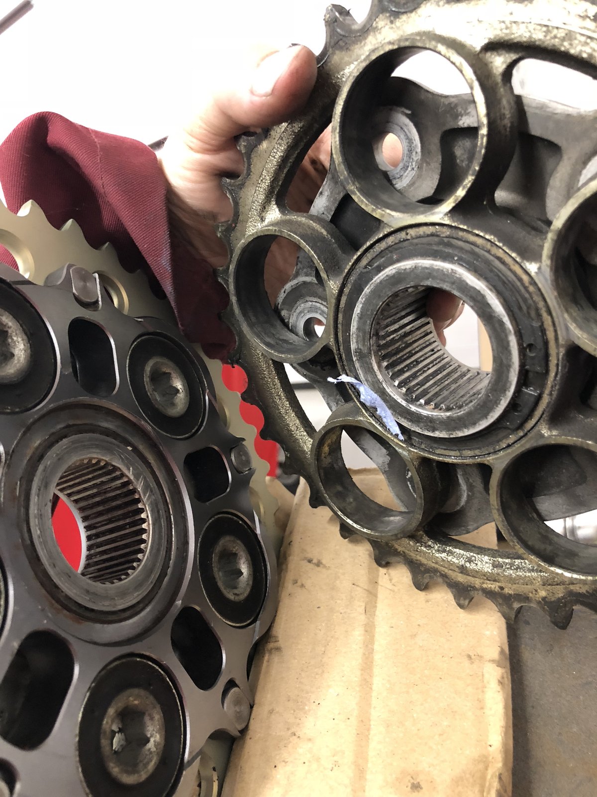

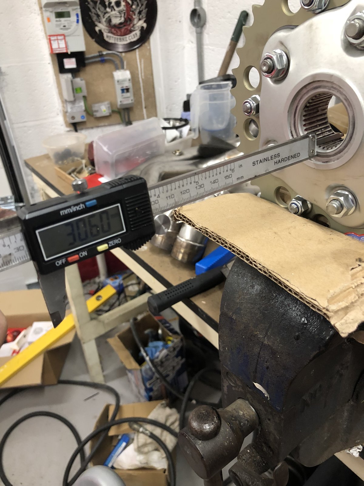

  1. So, fitting up a rental carrier and a better condition carrier from a 998 and I have hit a difference.. as per the pics, the original 916 carrier spline depth is 30mm - on the 998 carrier it’s 36mm. And also the rear of the 916 carrier is held in place with a circlip.
    What’s happening here then?
  2. Also, the carrier hits the chain adjuster - so think I’ve answered my own question here that the 998 carrier is different to the 916 carrier!??
  3. Yep have different part numbers too. Original one 16010211a new one 1601021b

  6. Indeed, my old one wore the circlip groove until the carrier was rubbing against the adjuster.
    As above newer (998) version is compatible with older bikes but needs a spacer. You can also machine the back off an old style carrier to work as the new one, spacer still required though.
    Some pics to show the differences etc.

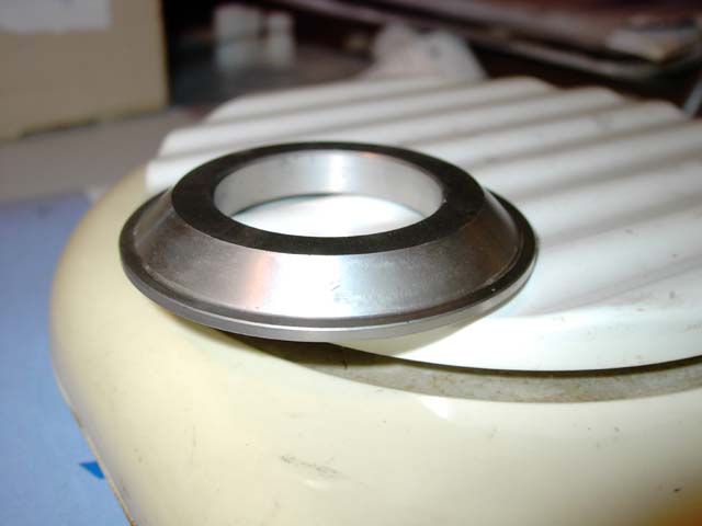

    New style with spacer;
    Spacer
