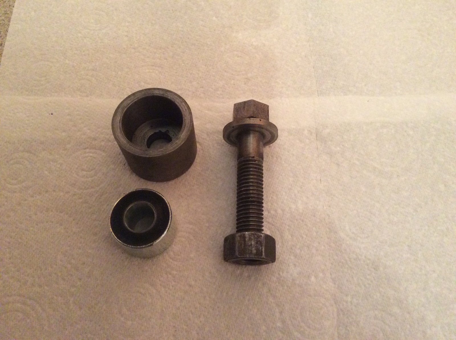

    Method 1: No heat applied. Manufactured extractor used to pull bush from housing. Worked with one bush but failed for other 5.
    Note: same tool used to pull new bushes into housings.

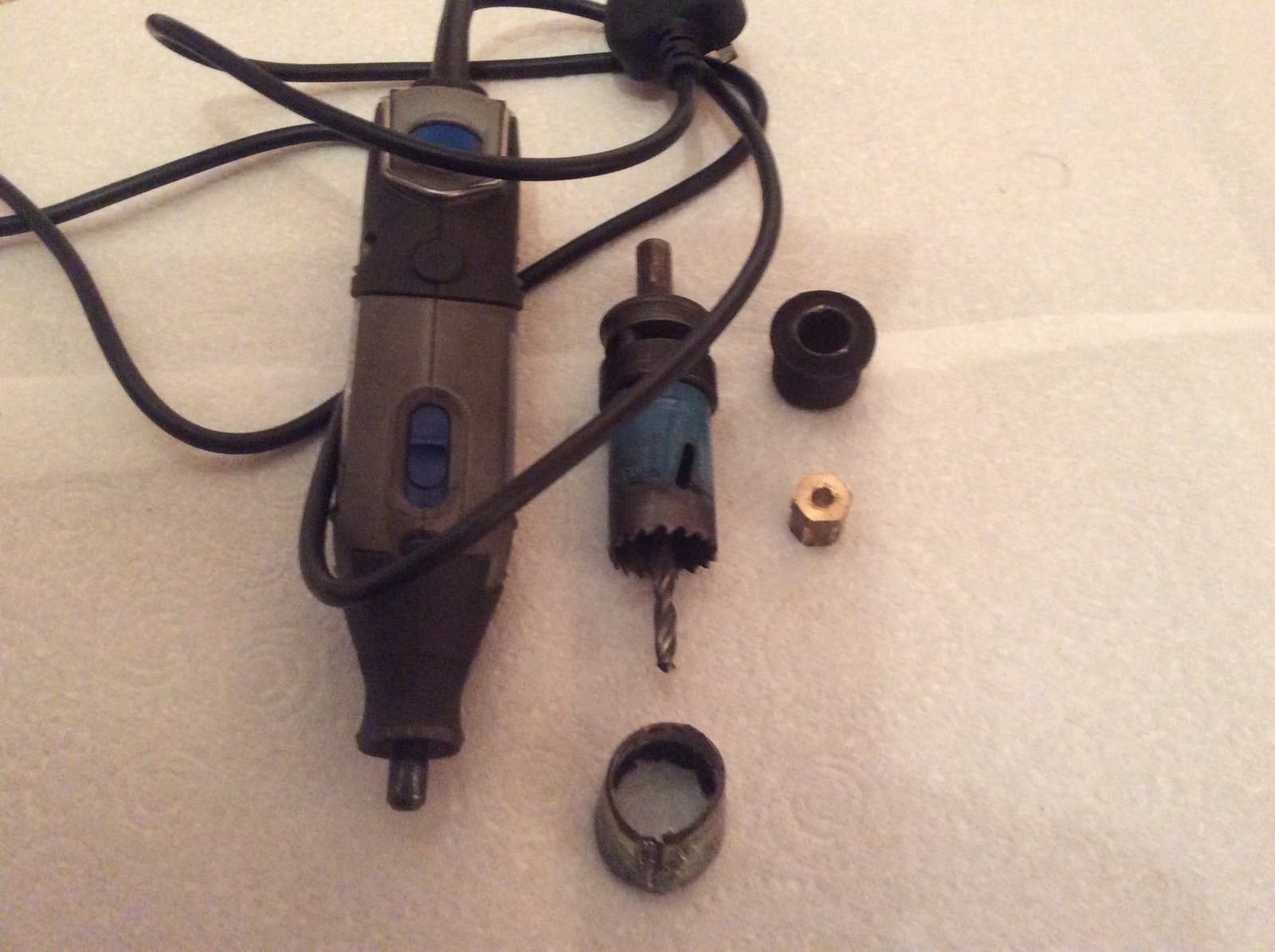

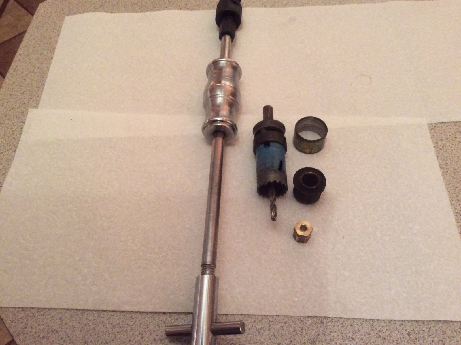

    Method 2: Centering guide turned and used to centre pilot drill for 32mm hole saw. Worked a treat leaving outer shell. Heat applied to hub area and slide hammer used to extract shell. Downside - required heat discolours paint. Not a problem in my case as having wheels powder coated.
    Method 3: Same as method 2 with the exception of heat. In this method I used a dremel or equivalent and cut through the shell at an angle. Once cut through I used a blunt drive to knock the shell out distorting the shell but preserving the paint.

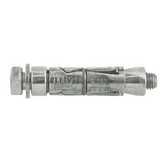

  2. I used these in conjunction with Method 1 on my 999.
