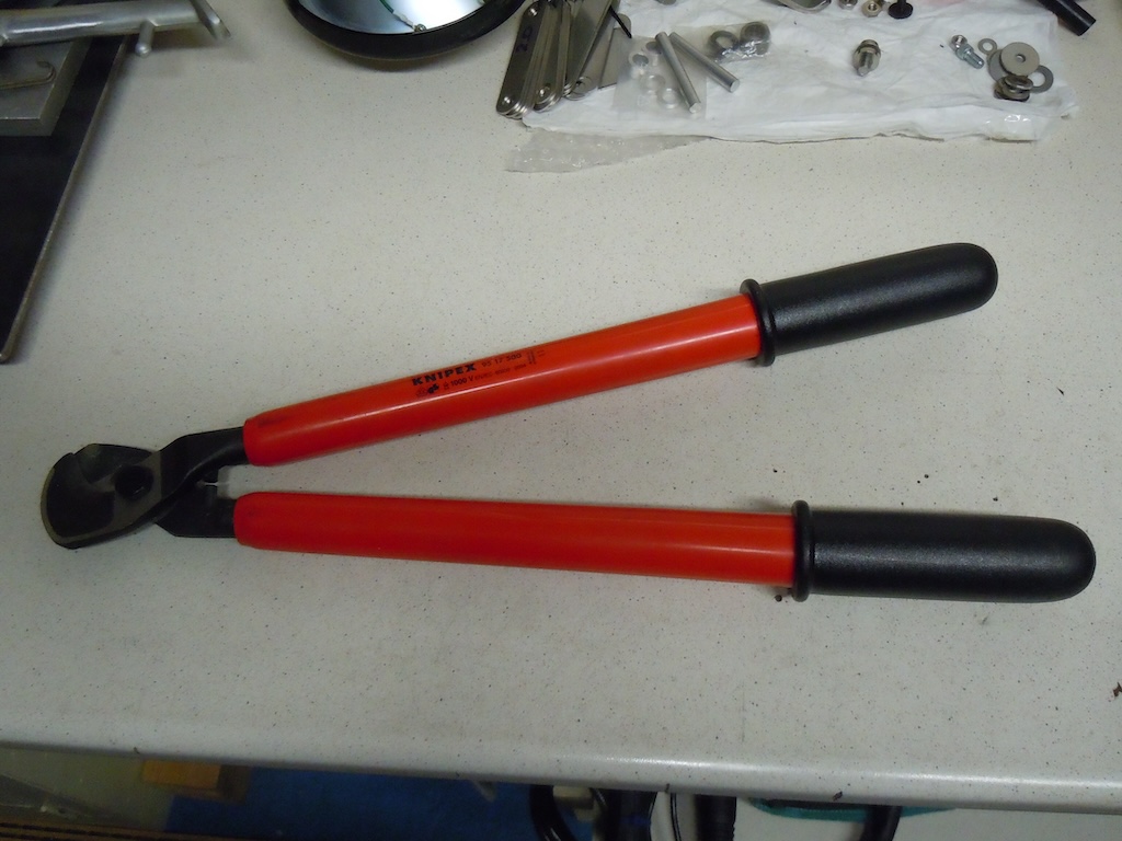

Most professional places have shears similar to those for large diameter electrical cables to cut both rubber and teflon steel braided hose. The best thing to use if your doing just one or five is a thin metal cutting disk for a angle grinder or air grinder. You'd tape the hose where you want to cut it, masking tape is ideal, and then cut through the centre of the tape. Then fit the nuts before removing the tape. Doing that prevents fraying of the braid at the ends.

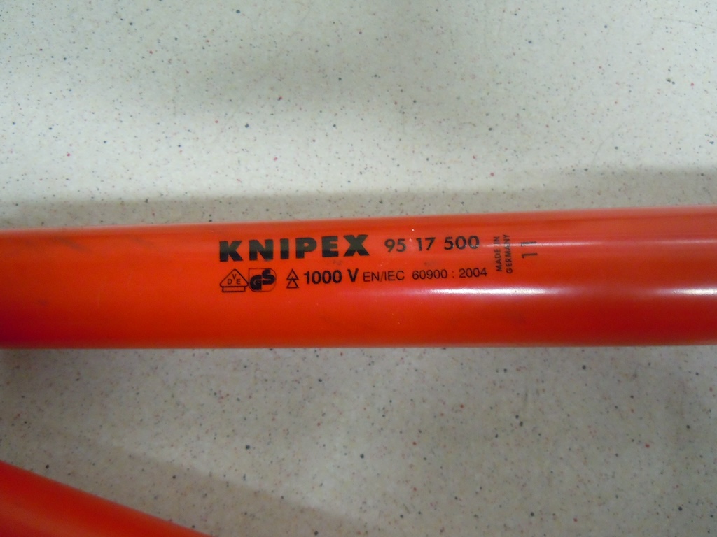

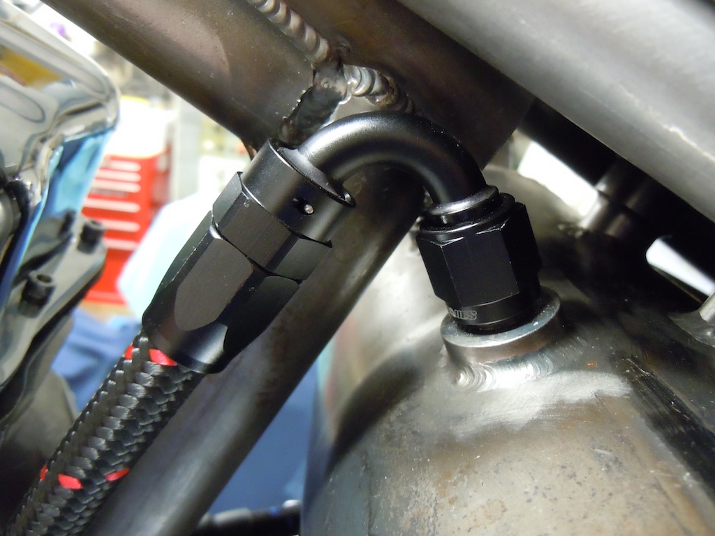

I use a pair of these to cut my hoses, both oil hoses & brake hoses. The oil hoses I normally use is 6AN size & the brake house is 3AN size. Both Goodridge & HEL brake hose is 3AN size. They are heavy cable shears & cut through the hose rubber sleeve & the braided stainless steel outers leaving a "clean" cut. I have seen people use a band saw & a hand grinder with a cutting disc fitted. A hand hacksaw though tends to fray the outer nylon braiding which can make getting the hose into the clamping nuts a bit awkward ! The type of fittings I use for my bike builds are like these & are available is a wide variety of angles & there are a wide variety of threaded or weld-in adaptors too. The 6AN fittings though do use imperial hexagon sizes so you'd need some imperial spanners too, common sizes being 1/2"AF, 9/16"AF, 5/8"AF & 11/16"AF or a suitable adjustable spanner!! Obviously swaged fittings are much neater that the type in the picture above, but you need to be careful when measuring the hoses up. What I tend to do when using that type is to get one end swaged on first & then offer it onto the bike & then cut the hose to length. Then send it back for swaging the second end, that way there shouldn't be an issue with the hose being either too long or a bit short. The bigger the hose diameter the more accurate you need to be with the hose length.
I bet those Knipex cutters were expensive! Some great ideas and tips there so very grateful for your detailed input but I think on reflection I'd be better off paying to get some made bearing in mind I wont be buying any more for years.
