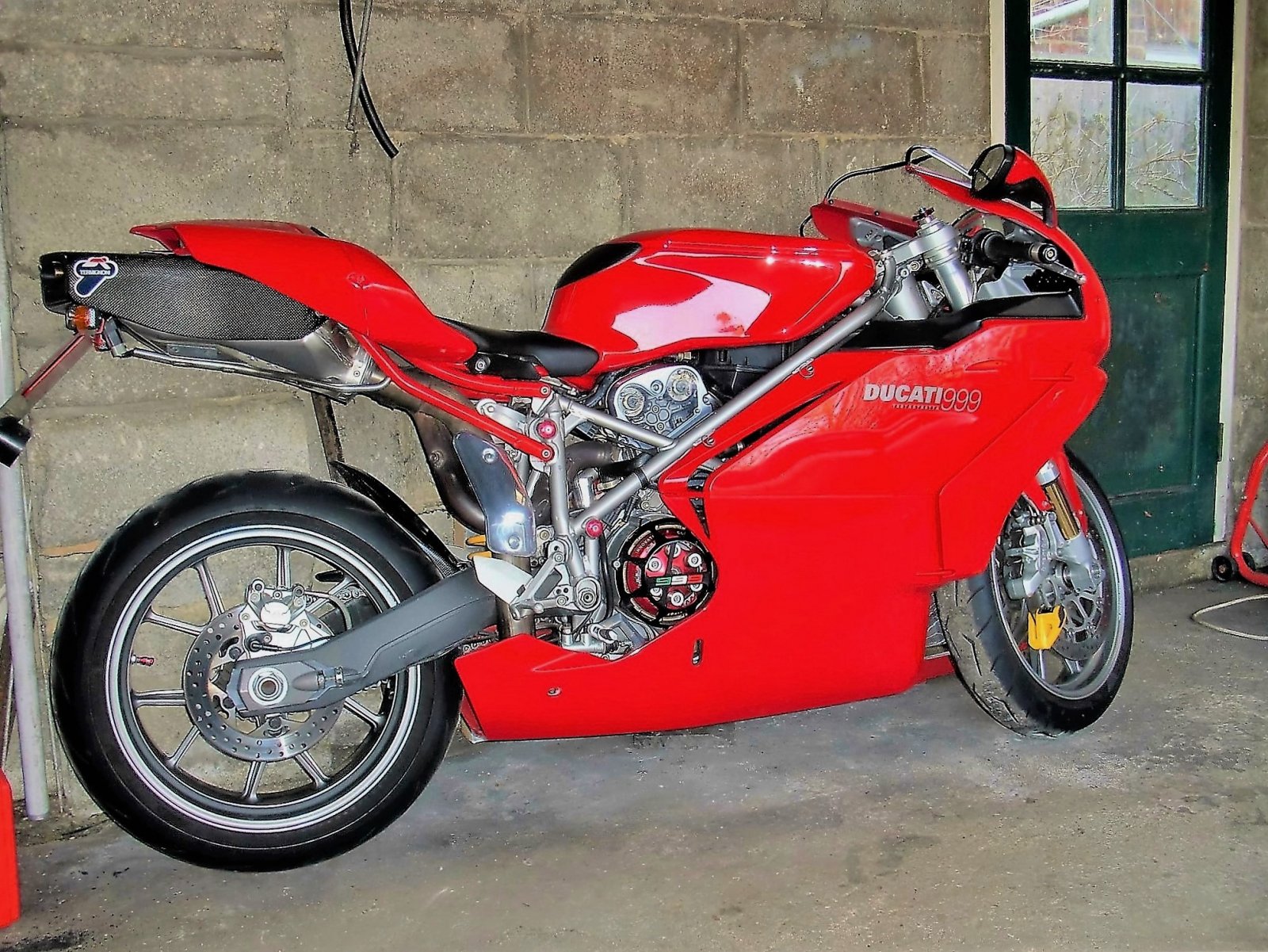

    I'd like to see where your 996 Showa forks are in the top yoke, also would you be prepared to lend me a Ducati ride height tool if you have one... I can provide proof of address and sign for it :)
  6. Sorry mate, don't have one. If the weather ever gets better I'll come and show you the bike, or you are welcome to pop down.

  8. You are welcome to come down and have a look how my 996 is set up whenever you like. I work from home so can normally find 1/2 hour for a cuppa.

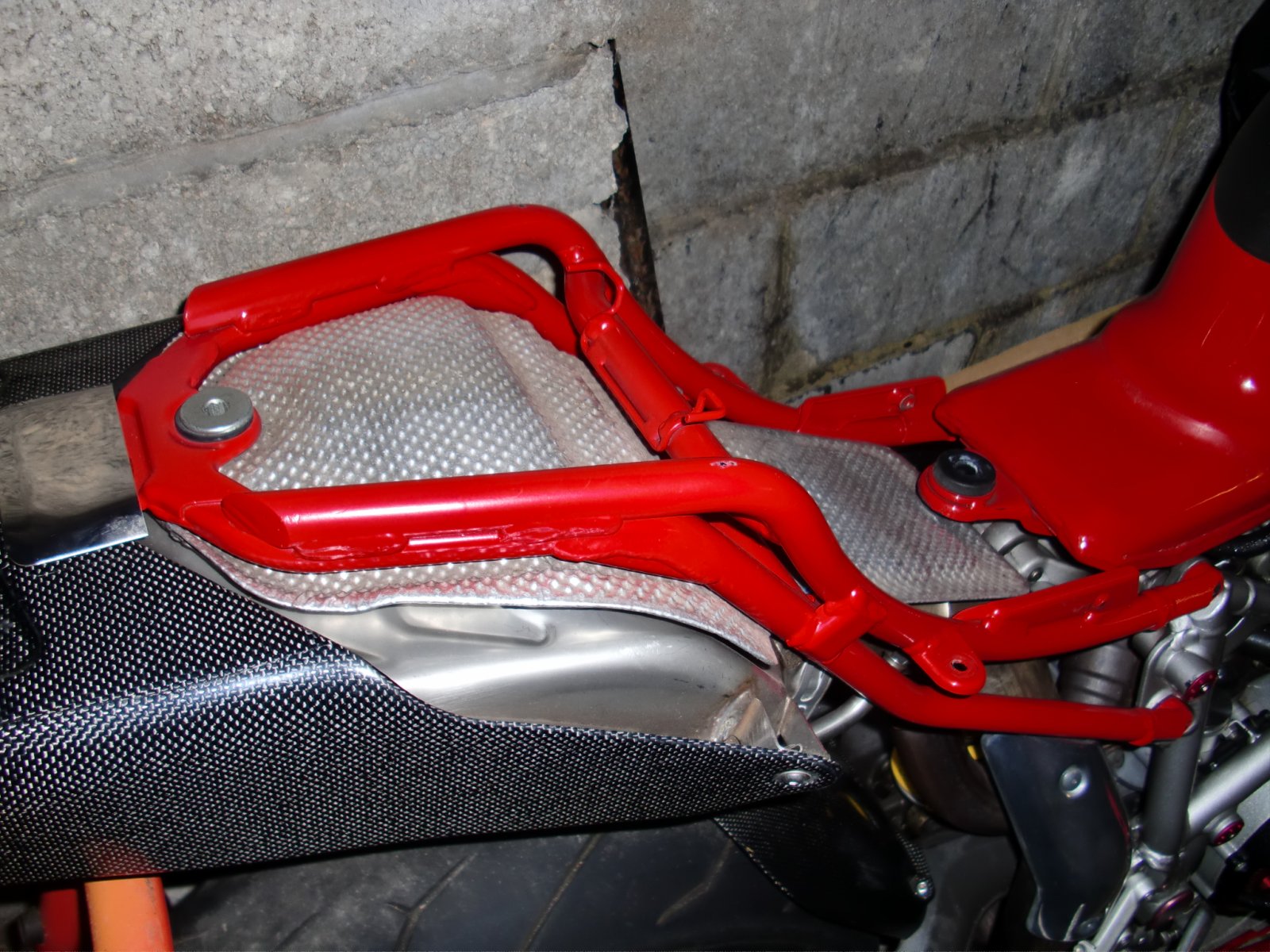

  10. Cr I posted these on an earlier thread, hopefully they give an idea of a possible bip sub frame mod CIMG1032.JPG
  11. Could more come off than that? Looks like you could have shifted some more metal there mate. Hows does it look when all bolted up with the tail?
  12. Perfect.

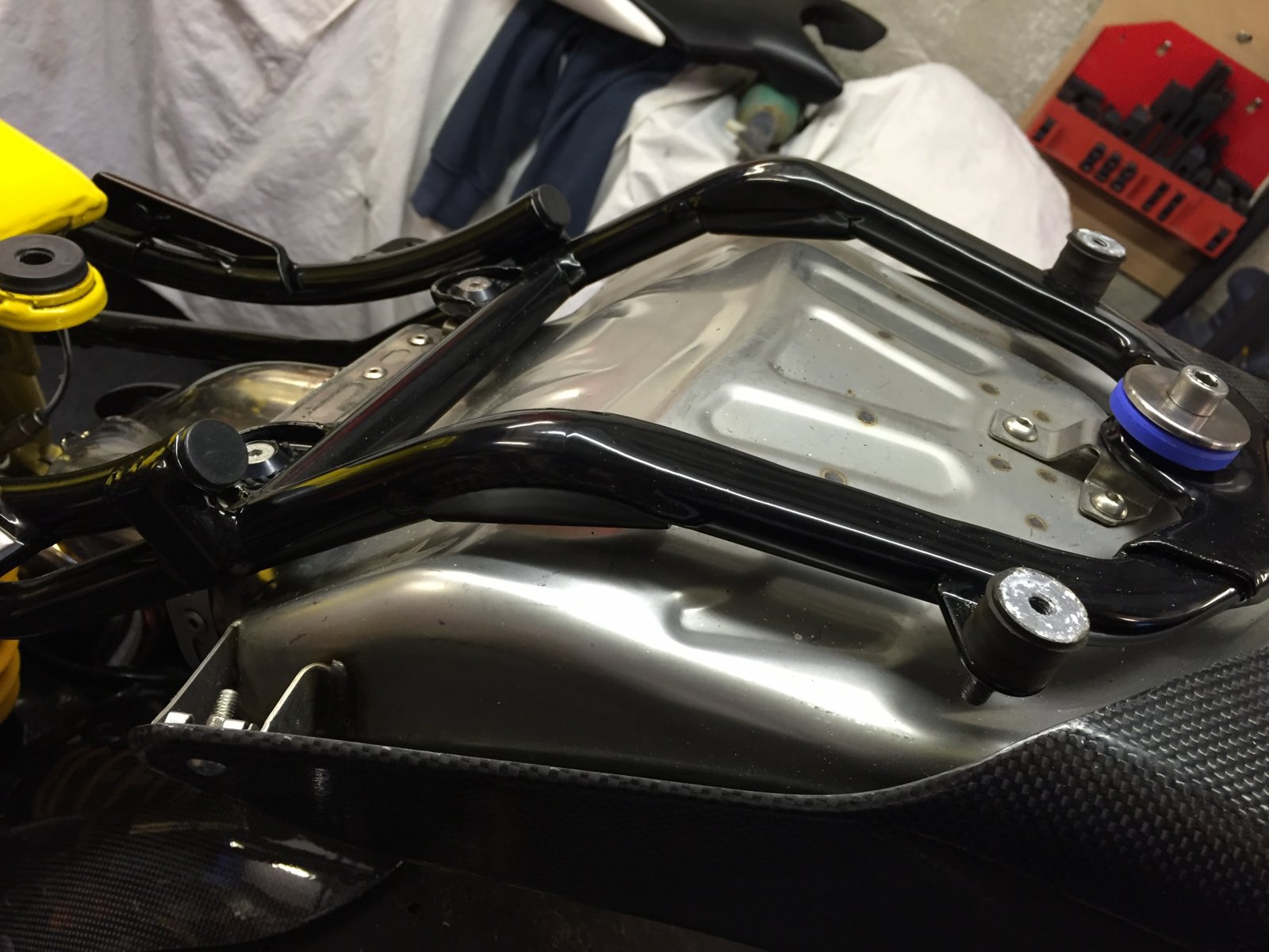

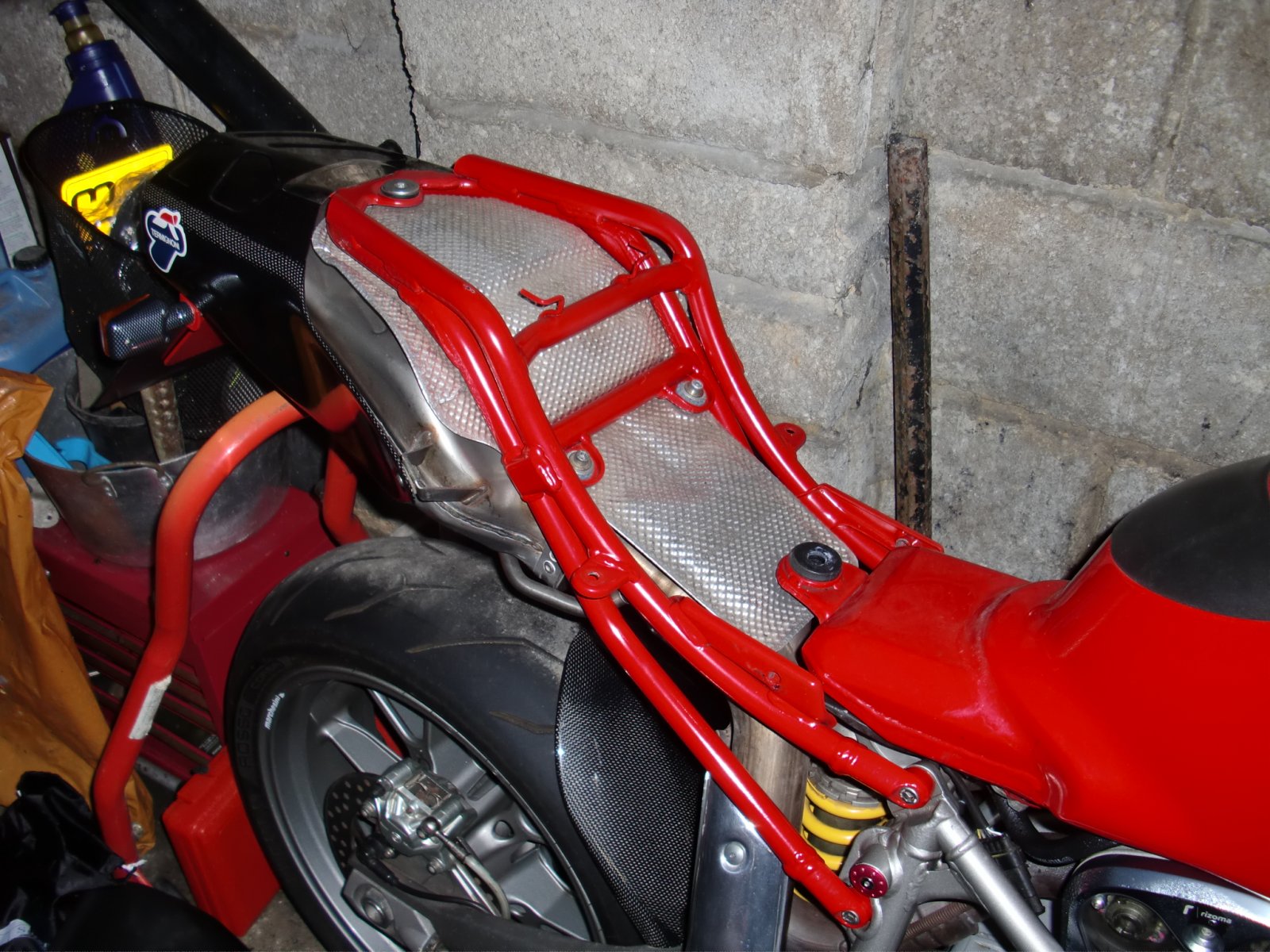

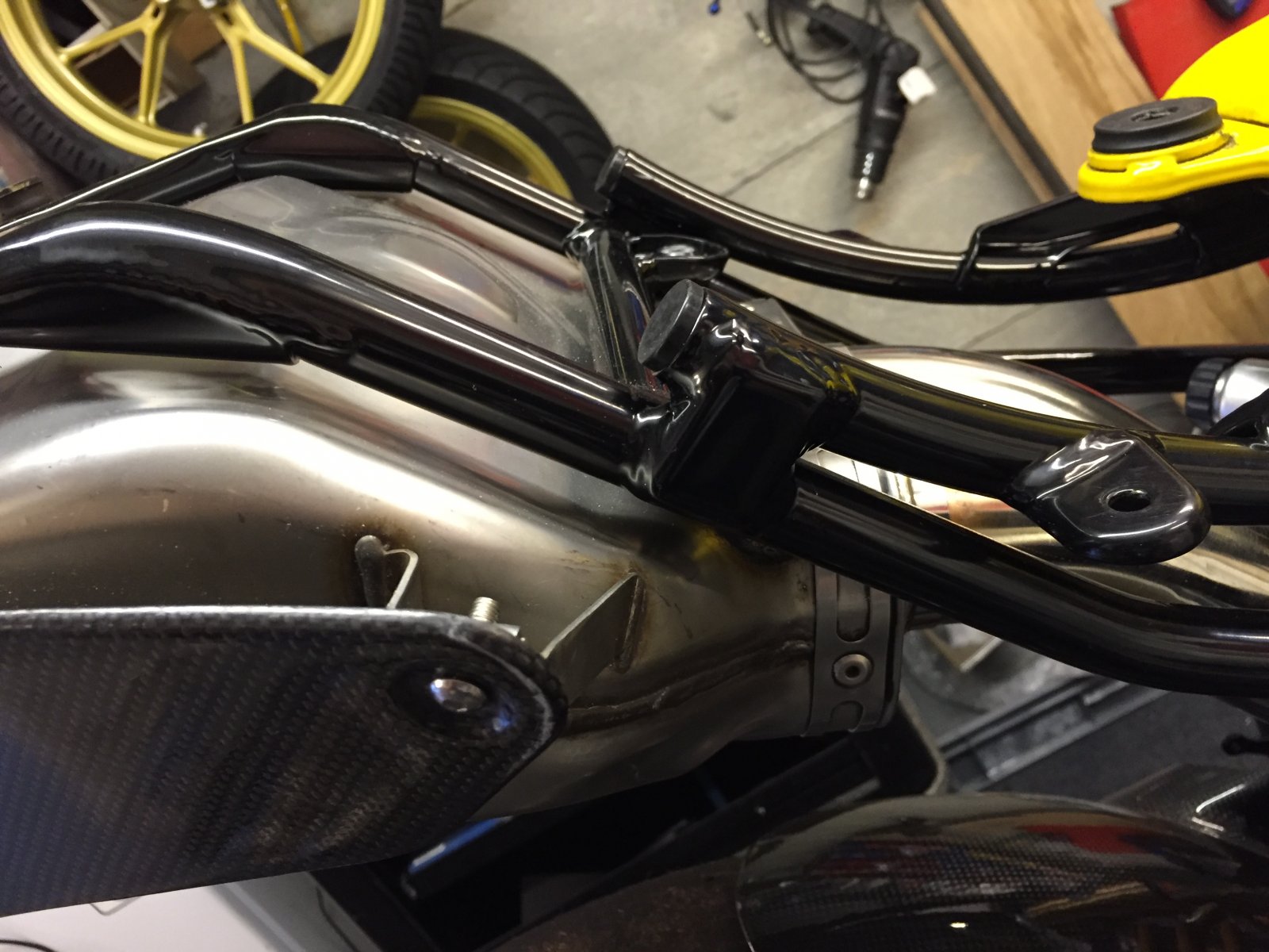

  13. Found these two pictures.
    C__Data_Users_DefApps_AppData_INTERNETEXPLORER_Temp_Saved Images_image(1).jpeg
  14. Ah. Those are the pics of my subframe. I couldn't remember which thread they were posted on.
  15. Nice, thx guys.
