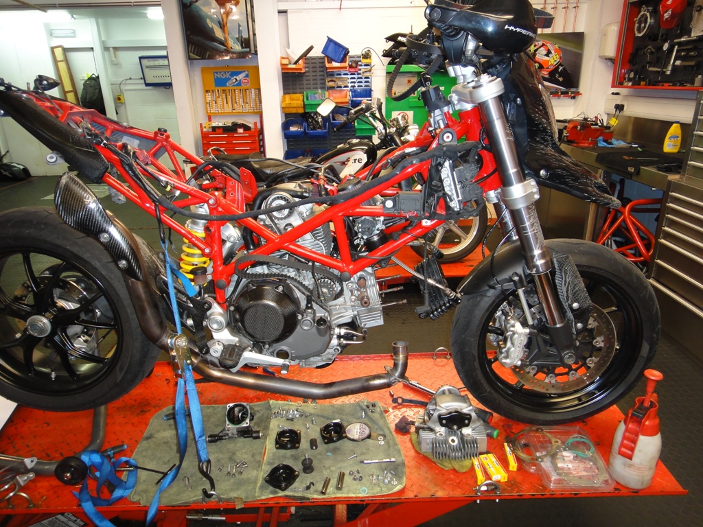

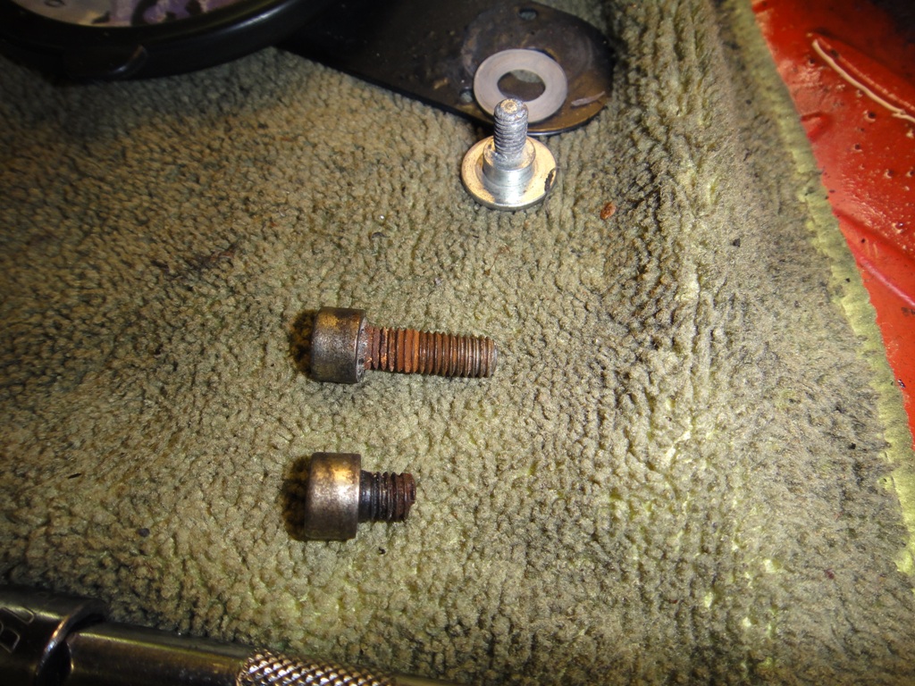

  16. Only pics I have are from the service last year when the issues were encountered whist doing the valves.
  17. That'll be the final job....engine out to get it coated....not doing that til something goes bang though....and yeah that's what most of my bolts looked like...
