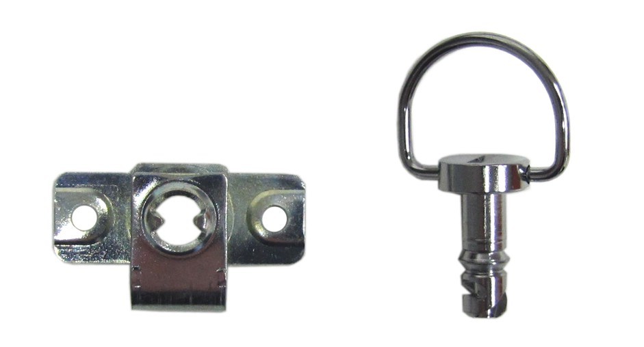

    Can I not just use the sliders like in this picture ?

  12. Ah, that’s entirely different. I have used the slide on spring backing plate on the 1098 body work I’m using as track body work on my 1098R and in all but a few instances there is room for the backing plate. The odd 1 or 2, I made a slight modification to accomodate the backing plate. Andy

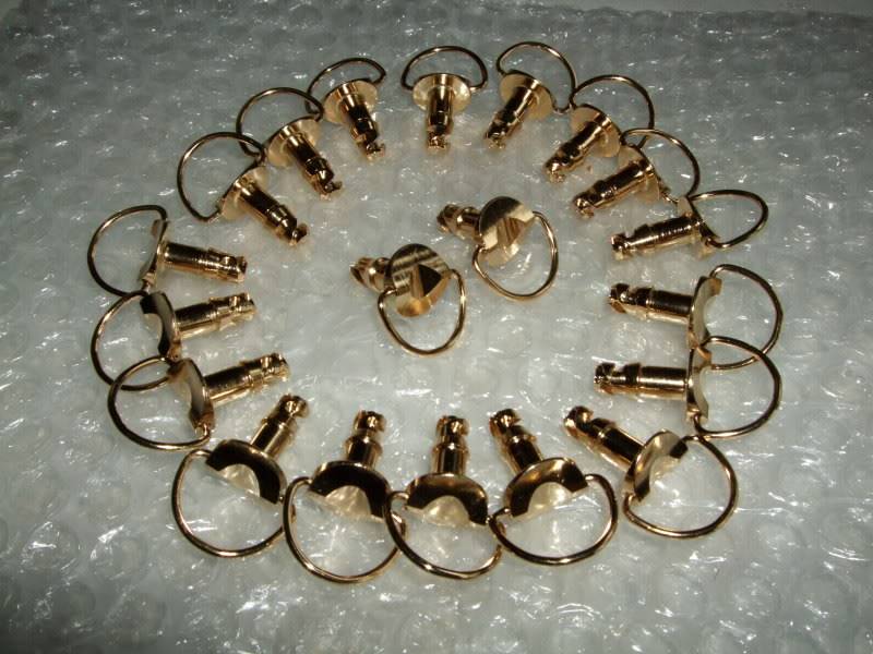

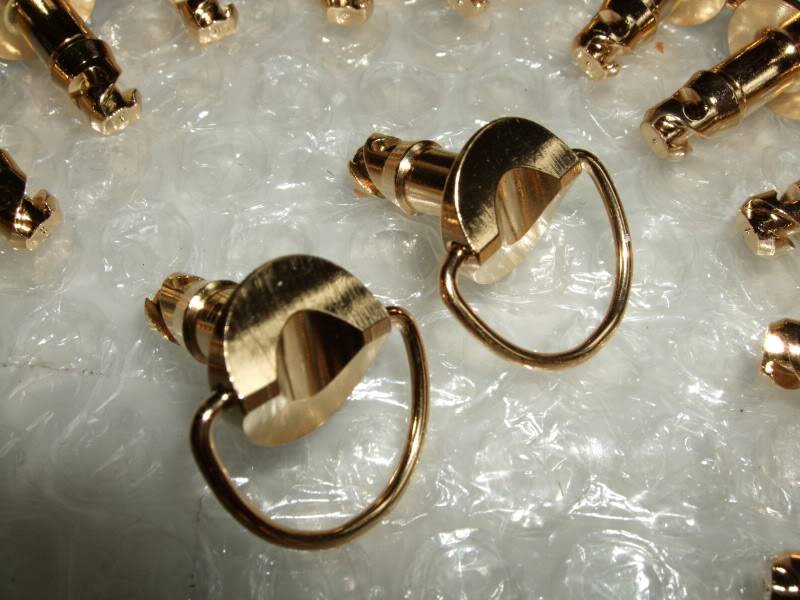

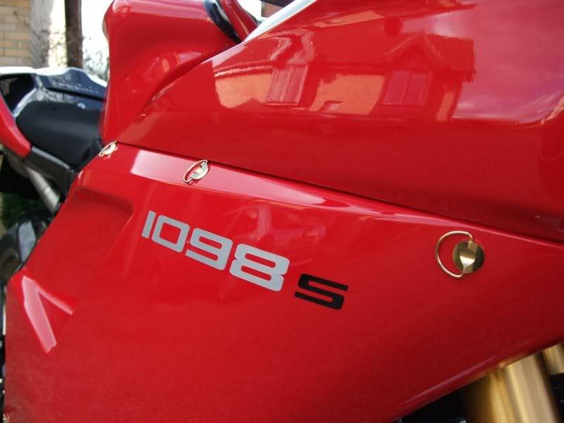

  17. Ditto for Kurvy Girl. Fitted them to my 1098S and had to drill out the the tabs on the frame to accept the larger diameter DZUS bolts for the upper side fairings. Kit also included some cam bolts in place of the stock fasteners for the inboard section under the nose. IIRC I did have to open up the holes in the fairing a little. I ended up changing out the cheese head DZUS bolts in the kit, for some proper scalloped head DZUS fasteners which were the style used by Ducati up to the 998 series. These are a much more flush design due the low profile heads and look a million times better. Pro Bolt sell them but they are not cheap. I had mine 18 carat gold plated (mad yes I know) as I was not a fan of the "plain" stainless steel ones and did not want to have them zinc passivated. Anyhoo, here is what they looked like.

  20. @Topolino were those brass colour to begin with? I have a bunch of the old 916 ones that I bought and look very similar to your plated ones?
