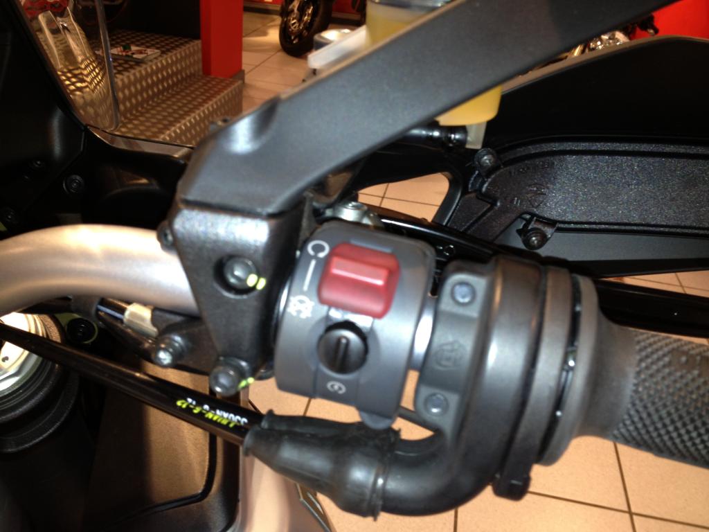

  1. The Multistrada's 1200 specification highlights the "Ride by Wire" technology, Then why do they have 2 throttle cables?, the Triumph Explorer & BMW K1600 along with others have ride by wire and they only have an electrical cable for transmitting the throttle position the the Bikes ECU brain. Just a Thought!!!! :rolleyes:
  2. Do the cables go to a spring loaded potentiometer unit first and not direct to the throttle bodys
  3. there are no daft questions , if no daft questions are posed then expect a hooooooooooooge screw up further down the line ................
  4. The cables will go to the throttle bodies (or somewhere prior to this) and this will have the potentiometers that will then relay that signal to the ECU and then to the throttle bodies themselves. Two cables because one opens and one closes so if the opener snaps then you can still force the throttles closed so hopefully the computer doesnt cause a tizz and you end up in the kitty litter like Pedrosa.
  5. Have Ducati missed a trick here? Would it be better to mount the potentiometer on the handle bar?
  6. That would certainly simplify my effort to sort the throttle post bar riser installation...
  7. It would be even more exposed to the elements. Water and electrics don't mix.
  8. I forget where I read this, but it was in one of the releases when the bike first came out.
    They use cables as it feels more like a conventional throttle. There are two potentiometers to ensure if one fails the bike is still ridable.
  9. The cables are connected to what Ducati describe as a "Throttle twistgrip position sensor" (APS) mounted on the horizontal throttle body. This has 2 potentiometers in it both of which are connected to the ECU. Mounted on the vertical throttle body is a "Starter motor - position sensor / ride-by-wire (TPS/ETV). Basically a stepper(?) motor and a TPS. The TPS also has 2 potentiomters in it, as John W say above, presumably in case one fails you won't lose control. Presumably the ECU reads the output from the APS and adjusts the throttle opening with the ETV so that the TPS output matches that of the APS.
