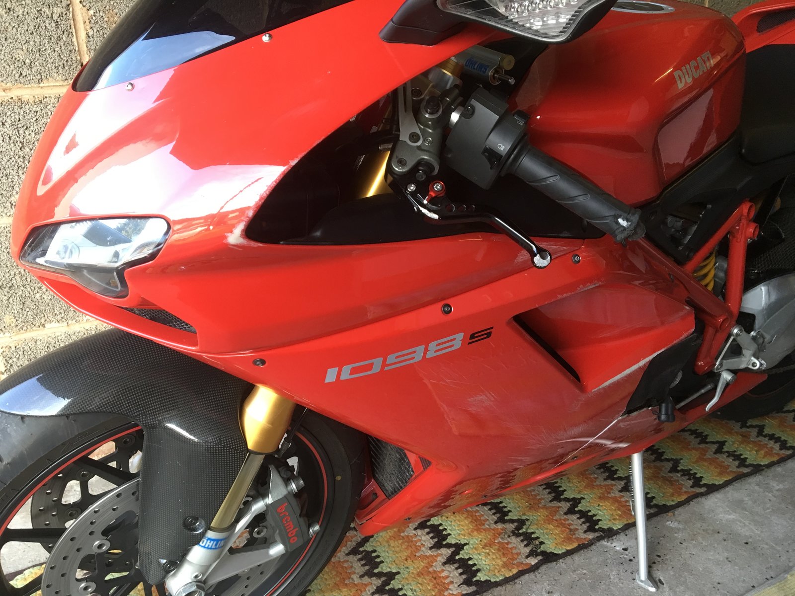

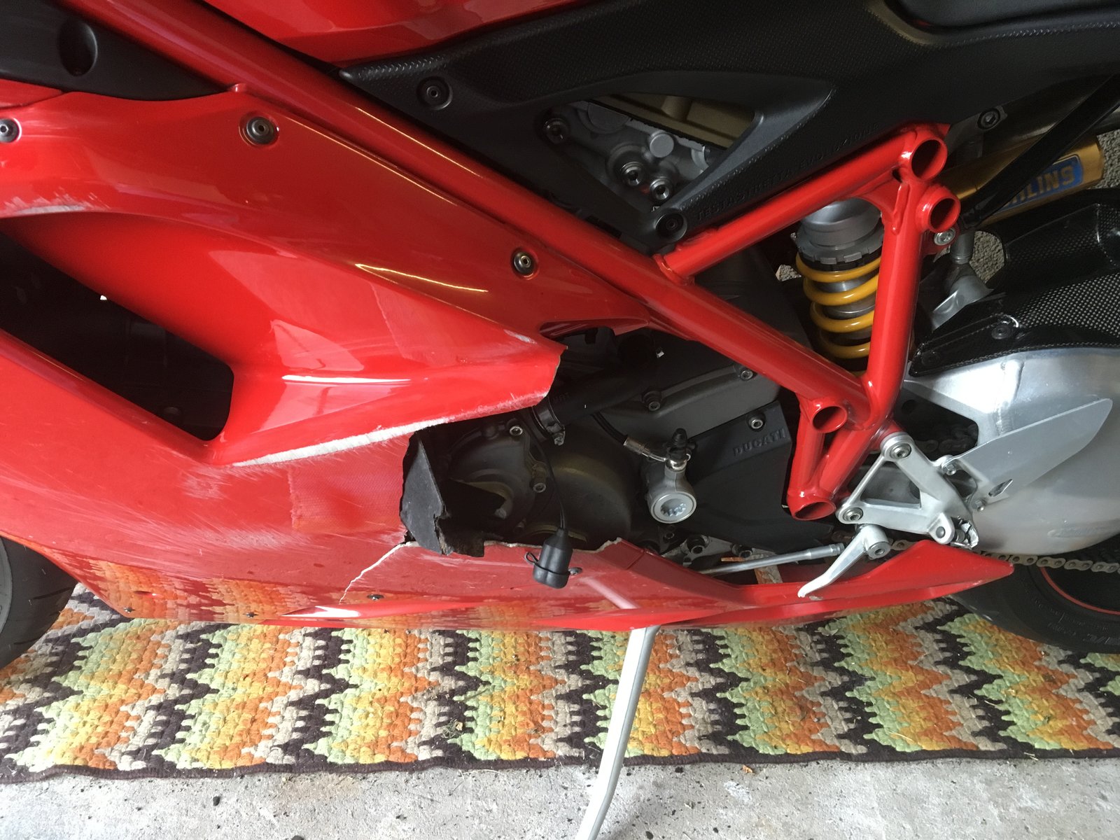

    Not a thread I wanted to be posting but...just dropped my 1098S, blindsided, hit the kerb & flipped onto lh side. Obvious damage apart from my busted collarbone is a broken lh fairing, broken gear lever & lh foot rest. Scratch damaged clutch lever, nose & tail fairing.
    Not sure if forks are damaged but there does seem to be a clicking when front brake is applied.
    So basically, advice please guys n gals. JHP Coventry is my local but anyone any other thoughts/options. With a recent £1000 service, cost is an issue :-(

  11. That is my plan but just want value for money. Fairings, levers & pegs I can eBay. Forks if necessary I’d need proper advice
  12. If you want to keep the bike, repair yourself. Probably 2k worth of damage.

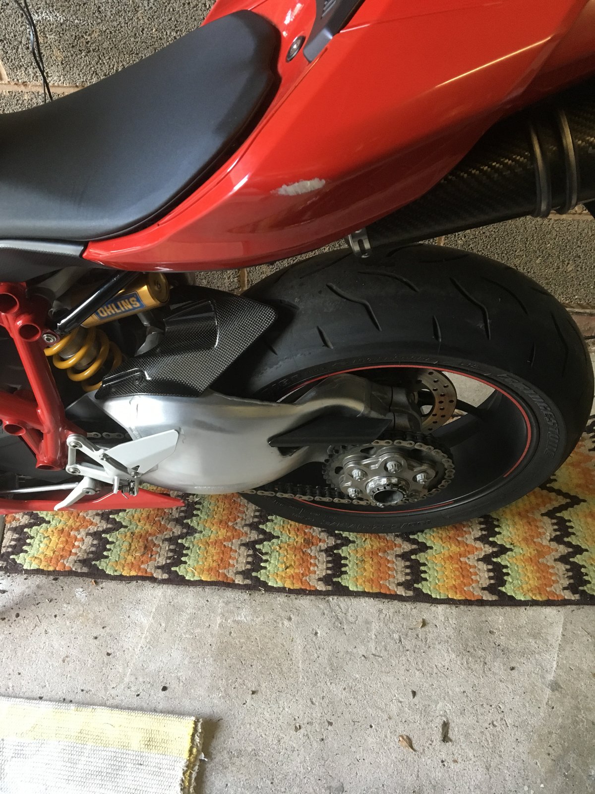

  14. Fairings will be tough to source or expensive to repair. Is the swingarm damaged? You may be able to pick one up for 100-200 but you’ll need to swap out. Depends if buying replacement stuff new, having someone do it for you or repairing and making do and doing it yourself.

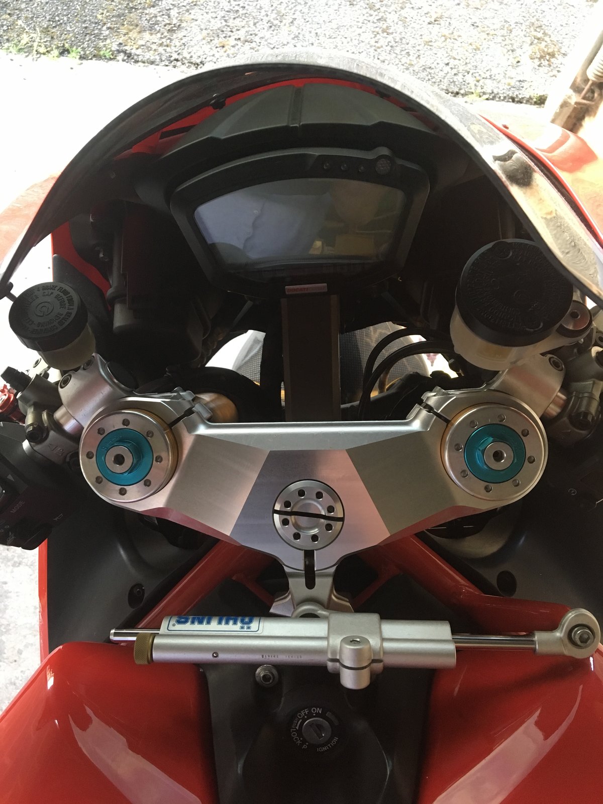

  15. No swing arm looks good, think I can repair scratches in nose & tail fairings but will need lh side fairing, pegs & gear lever. What I’m concerned about is the forks. They look OK but I don’t remember a slight clicking sound when actioned before?
  16. Takes a big amount of force to damage a fork, other than outside cosmetic stuff.
  17. Are the lock stops on the lower tripple ok? I did the same to a Fireblade many moons ago. The most expensive item was a new lower tripple because it twisted during the crash and the clipons and upper clamp were not straight afterwards. The forks themselves were fine.
