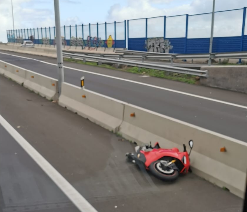

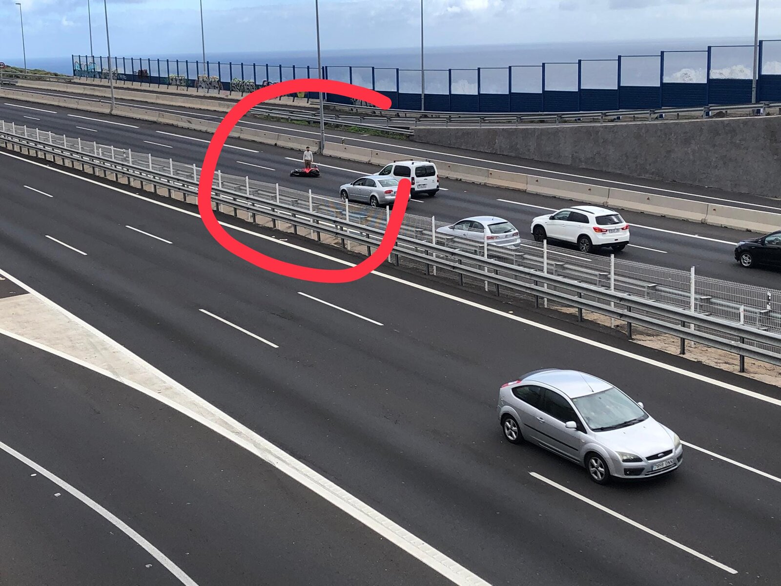

  1. Yesterday at Tenerife a friends bike broke the rear axle at highway, The good thing is he wasn’t going fast when it snapp....
    I think it’s scary..

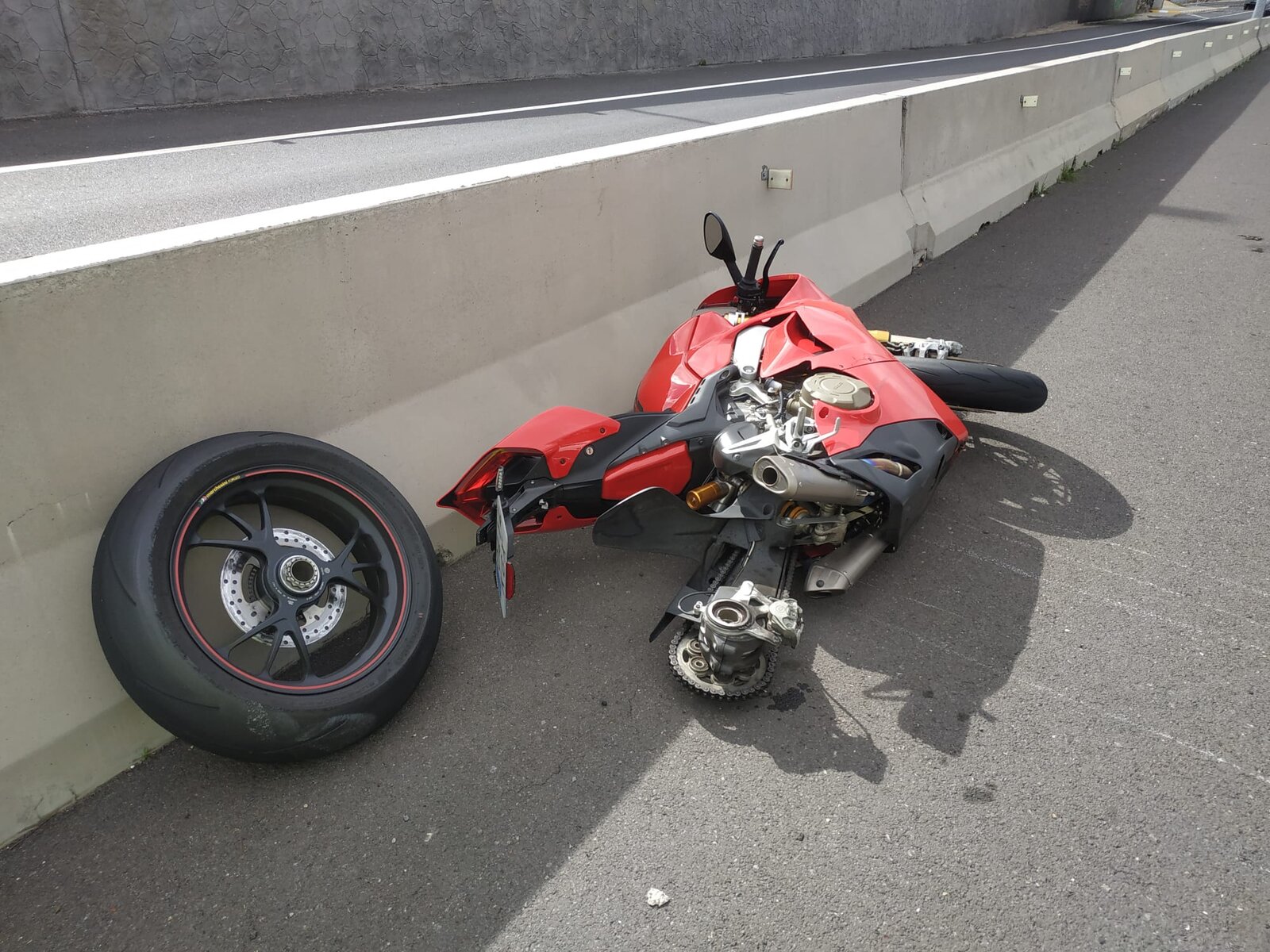

  2. is that an 899? SSSA?
    Damn!

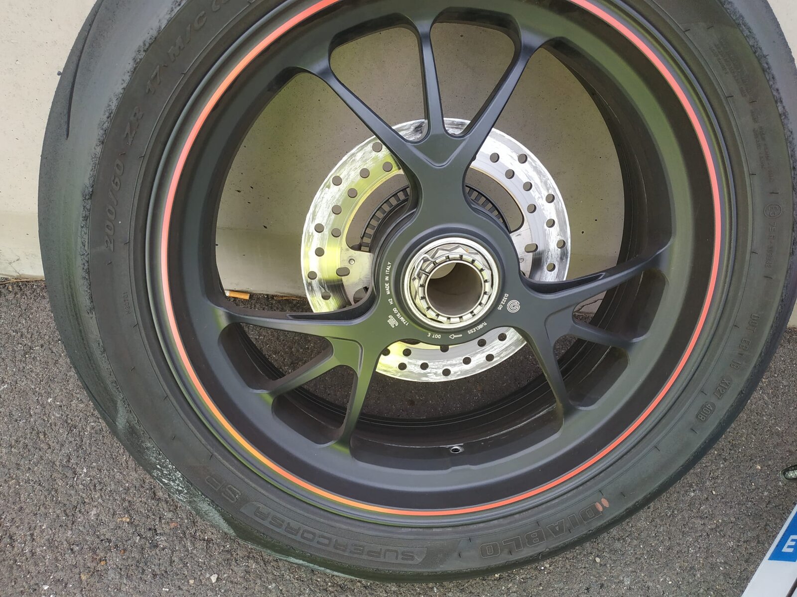

  5. Appears to have failed at the bearing face within the hub. Is there a badly designed change of section there that has caused a stress concentration leading to early cyclic fatigue failure?

    He’s been giving it some though looking at the rear tyre (which has also had its valve knocked out, presumably on impact).

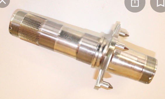

  15. This is 819Z0021A as listed for V4S on the Omaha site.
    I can't do the arrow point thing but it must have failed somewhere between the splined section and the back face of the wheel mounting.

  16. That does look like it failed right at the bearing face on the shaft. I imagine Ducati will want a look at that
