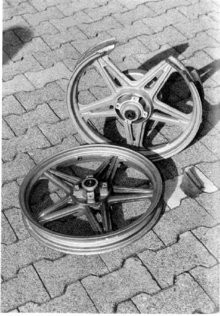

  1. This months Classic Mechanics is running an article on Darmahs and one paragraph has me a bit confused.
    It acknowledges the issues with Speedlines being very prone to cracking but says the Campagnolos are much less prone to cracking and as such safe to use. The bike tested has Campagnolos fitted.
    I thought if you valued your life both Speedlines and Campagnolos were best left as display wheels and if possible get a set of FPS wheels.

  2. A couple of points from my experience for what its worth ?
    The Campag wheels are a much stronger design so not so prone to fail
    Campags i have seen fail have always been unnerving but never catastrophic.
    I have seen campags where a spoke has become detached from the rim ie: cracked round the join to the rim but never structurally collapsed
    Speedlines when they went tended to crack across the rim from the spokes so sections of the rim would drop off which of course was catastrophic .
    It also has to be said that a lot of Speedlines were replaced at the time but not all and most of those that survived are now nearly 50 years old and still going, much like the Campags.
    My view is at 50 its probably time to replace anyway but if in doubt send them of to http://www.tpcs-magnesium-refurbs.co.uk/ and get them checked as its corrosion thats the bigger problem now rather than structural design.

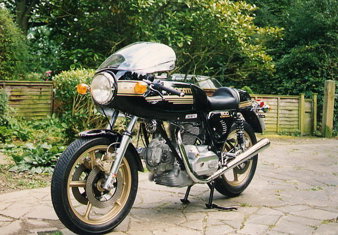

  3. Also bear in mind if you have a tested set of Campags you are sitting on a lot of cash :) 900ss_1.jpg
    My SS had Campags from new and they are worth a lot of money now.
