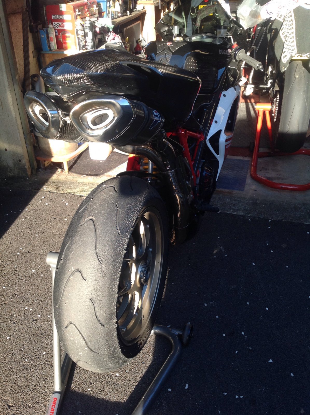

This is a slash cut system (just after said Brands Hatch outing, with killers installed): The killers are a strange non symmetrical shape, a photo would not be sufficient to allow machining in my opinion.
