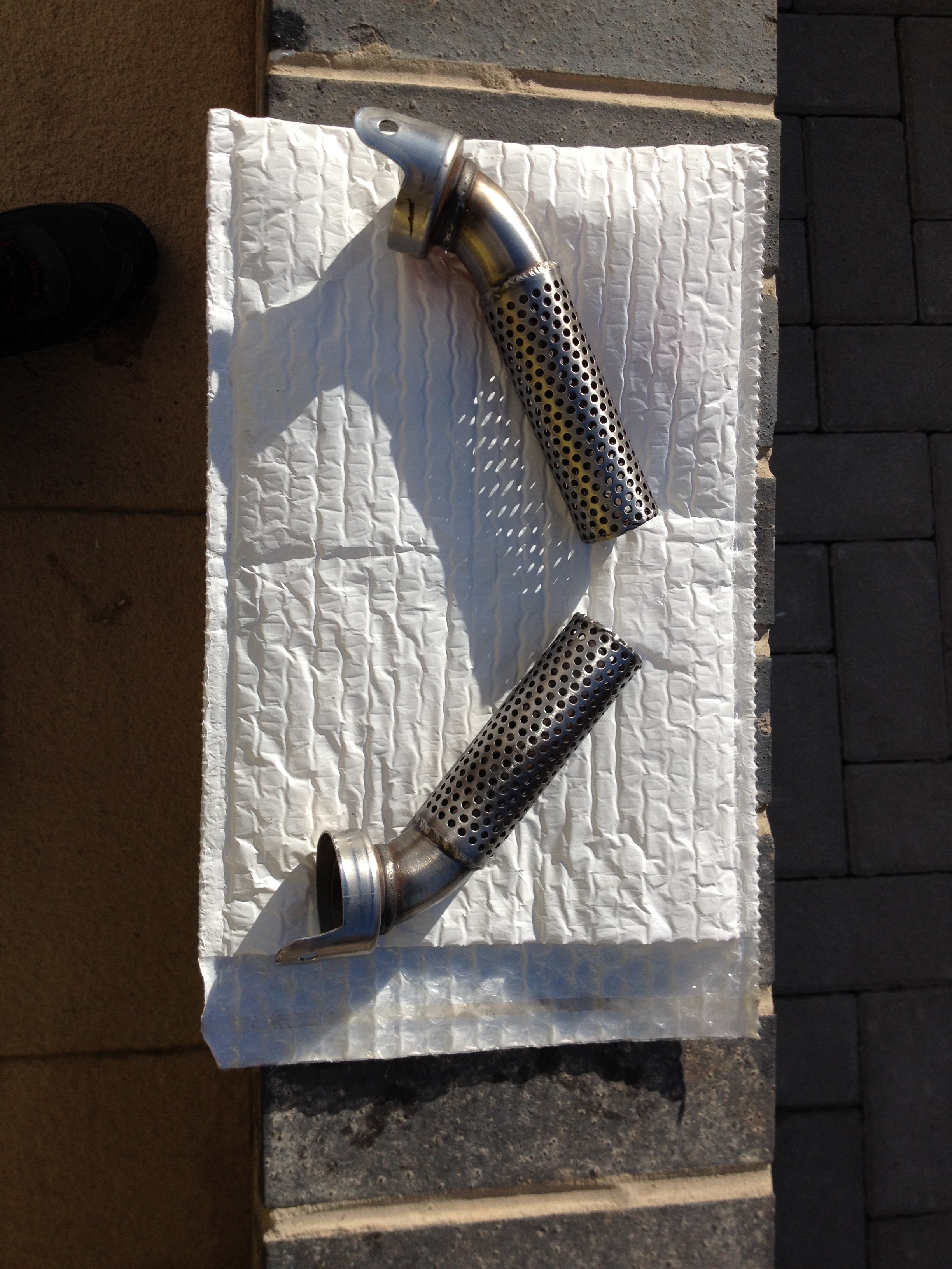

Ran mine at Silverstone full GP circuit. 102db day. They didn't do static test despite saying they would. Just drive by. Put the inserts in my Termi's , and that is a shit job, and no issues all day.
