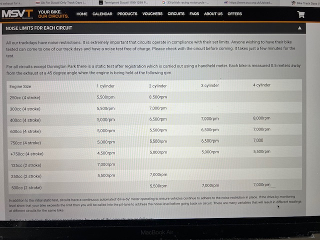

  8. I've had similar with RPM, this is what they should test
