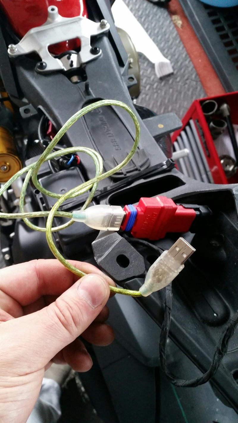

  1. Anyone know if you can buy an extension cable for the DDA module in the rear seat?
    I have just fitted track fairings to my 1299s and cant quite reach the USB once the tail unit is fitted. Would be a pain to have to remove the tail section every time I wanted to plug it in to the PC.
    Thanks,
    Mike
  2. You will have to build one. The connectors are 4 way Sicma Miniseal 1.5mm.
  3. Ok cheers mate.
  4. Could you just put an USB extension lead onto the DDA? Or does it have to be removed to work? I've got a DDA but it lives in a box at home unused.
  5. Hmmm thats a great idea...Why did I not think of that! I'll try it and let you know if it works..
    Cheers
  6. Update: The USB cable extension does not work..The DDA module has to be unplugged from the bike otherwise the PC doesn't recognise it.
  7. If your using the stock seat, the dda connector can be moved down to where the rear of the seat locates. Just need to lift the seat then.
  8. Thanks guys I've bought the connectors to make the lead...
    Nelly - I'm using a track tail unit so have to go down this route thanks anyway.
