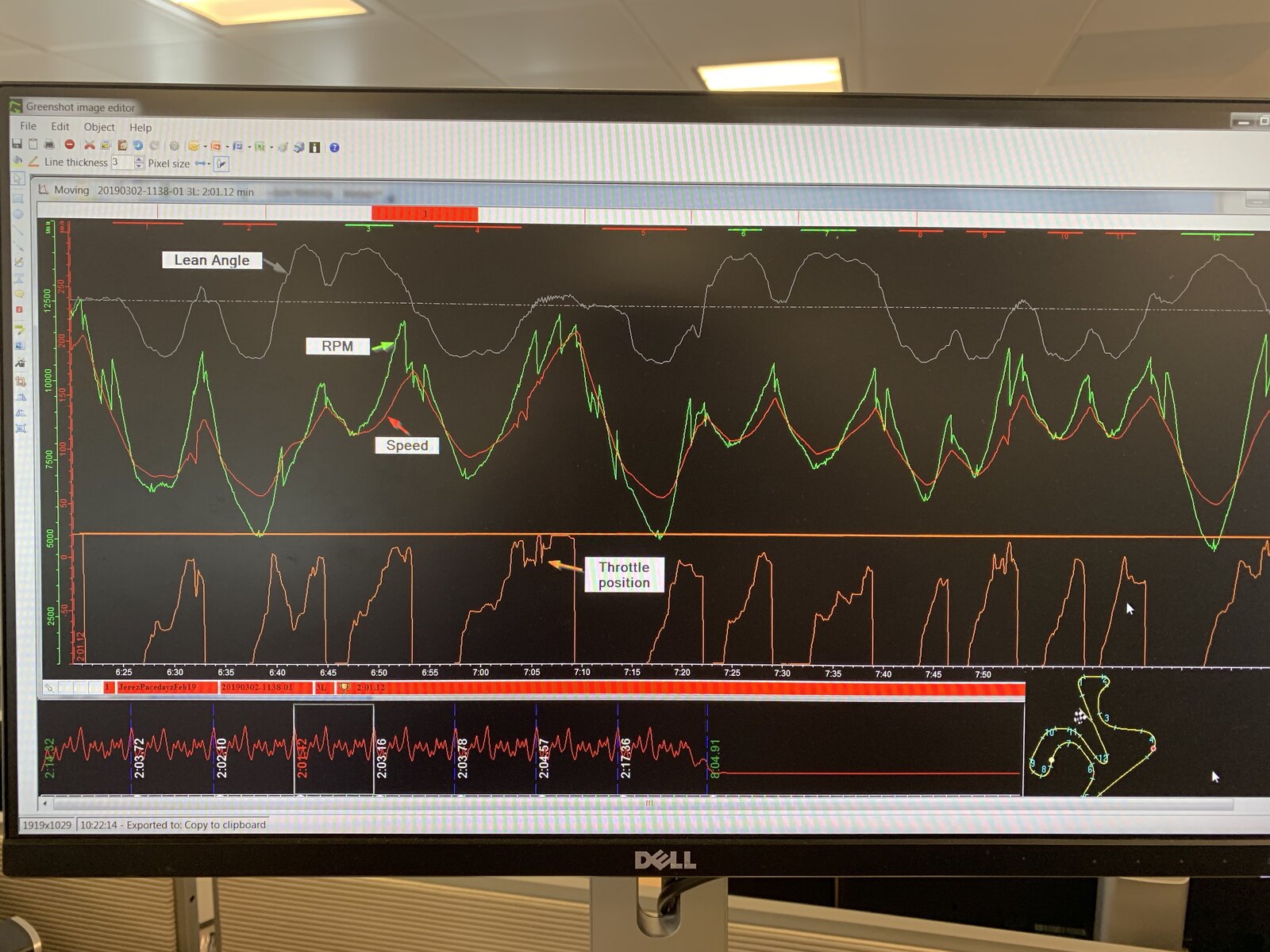

    Here's a great example of how easily you can knock seconds off when you have data from the bikes systems showing your throttle position. I would have sworn I was full throttle on all the straights at Jerez but the data said otherwise!:
    A few sessions working on it and I knocked several seconds off my lap time:

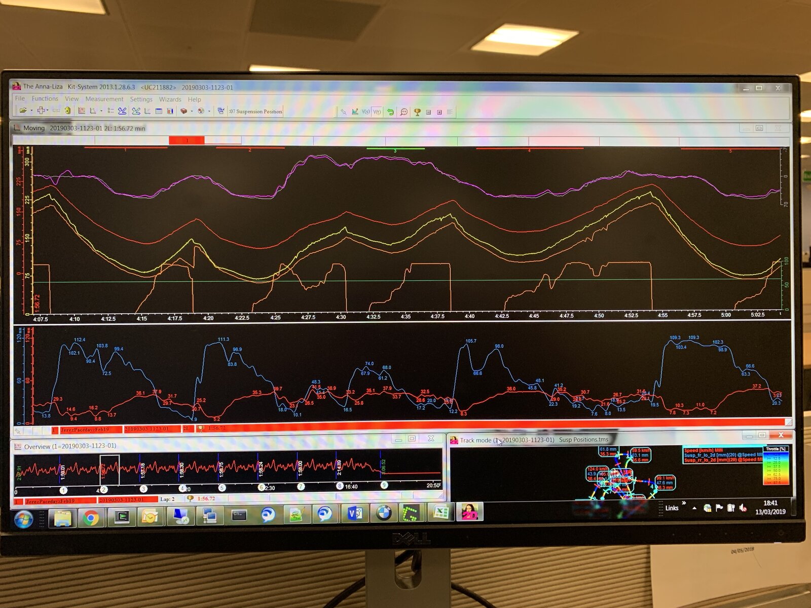

    This is my suspension travel which is an awesome thing to have. I could see from the blue line that my front springs were too hard as I am not aggressive enough on the brakes to use them as they are. Full fork movement is around 120mm.
