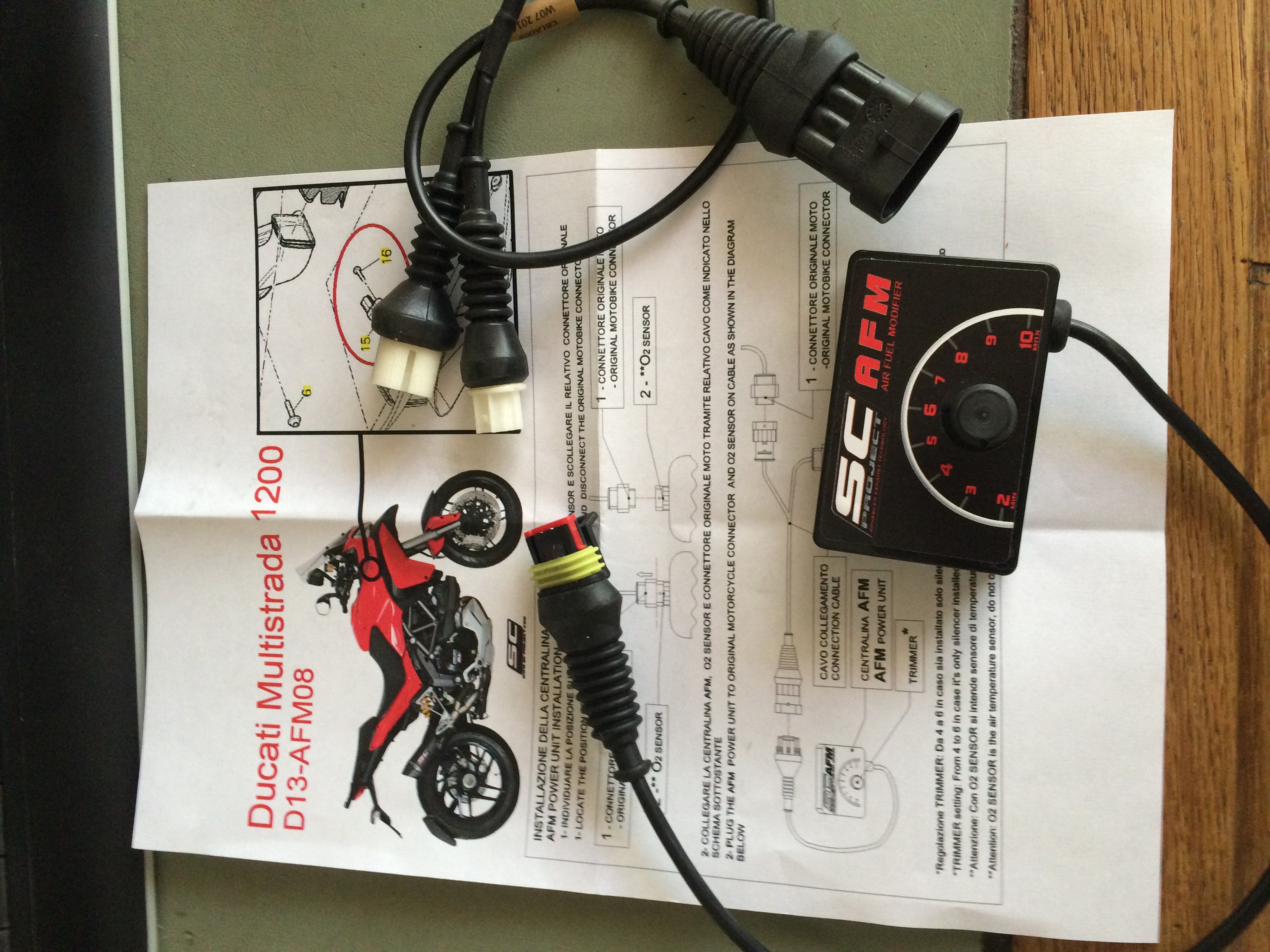

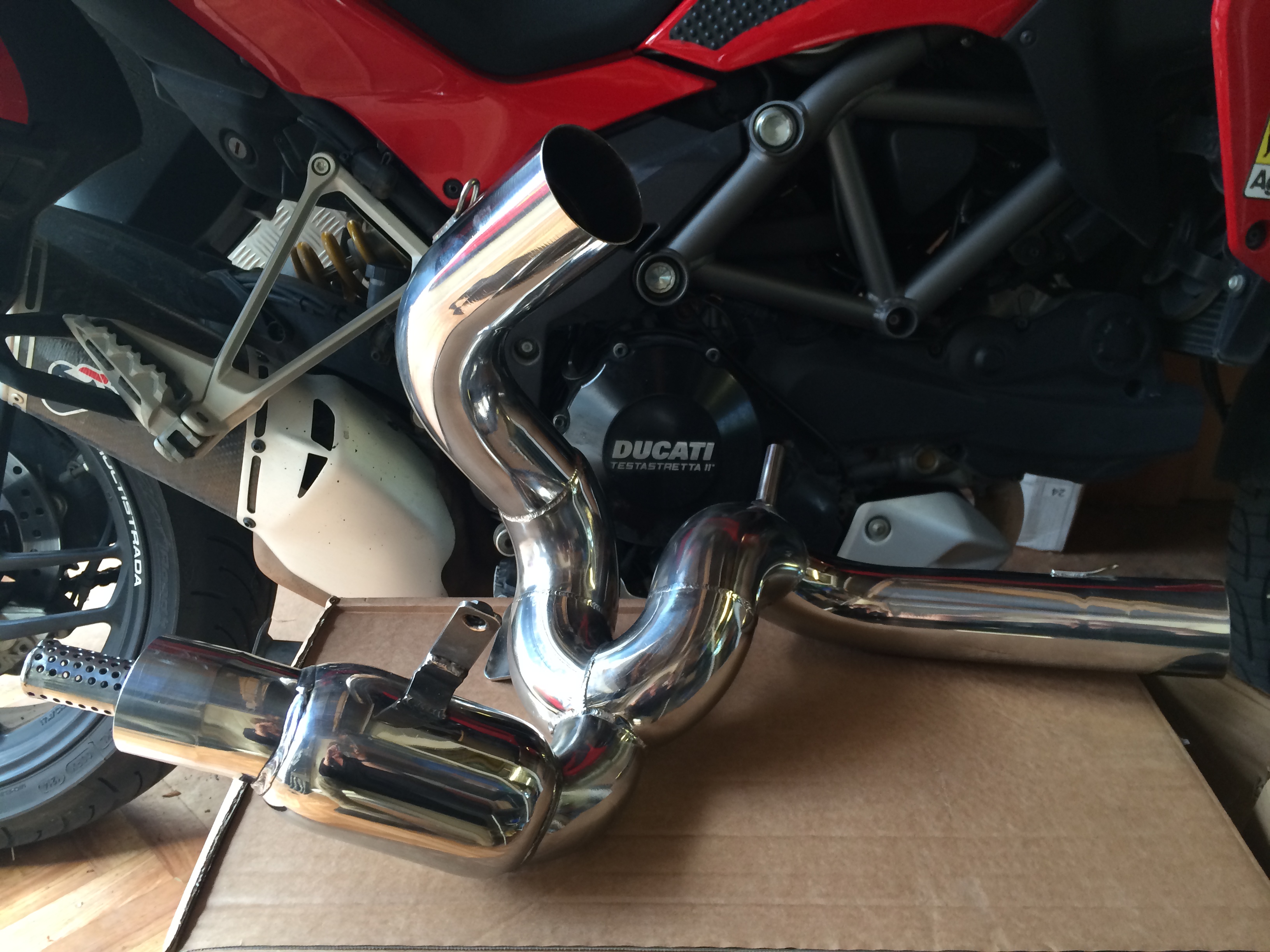

Sorry about the duplicate post!!....its early and I am a cluckwit. Hi, I have just taken delivery of an excellent set of Decat pipes from Ben and would like to fit them to my bike asap with a stubby termi. However I have ordered a plug and play fueller, but this wont be with me for some two weeks and I am a bit worried about the engine running too lean without the cat. I cant have a full retune with you as yet as the bike is still under warranty. In your experience should I wait until I receive the fueller or, for the short term, will the bike be ok without it fitted?? I would be really grateful for your advice here. Should I wait for the fueller, or can I bolt Bens pipes on now? Thanks Ian

Not convinced they will compensate enough, hence the need for fatducs and the like. I tried them on my 2013 but made no to worse difference. In the end I had the remap by CJS. Turns out the front was hideously lean without the cat. As for the fatducs not doing anything, it was believed that this was down to most of the changes to correct things on the dyno were through changing the spark map and not the fueling.
Thanks for the responses so far, well, the pipes are on (fairly effortless) and the new sound is stunning, and with Bens elongated baffle which extends into the Stubby the sound is soooperb. The fuelling does feel a bit 'fluffy' at the bottom end so as a precaution I am going to nail this puppy on to increase the fuelling marginally across the board!!.....I don't know if its if its in the mind or what, but it seems to go like cluck now!!

"Ben's elongated baffle"? Has that been made as a special to fit the Termi stubby and provide more noise reduction? Might be the ideal decat solution.

This system really does look the mutts nuts......... ..........such a shame that once fitted, it can't be seen. I'm surprised that Ben hasn't/can't (?) produced the little front n rear header pipes to complete the full system look. There must be a demand surely? - maybe Andy could suggest it to him????? Having said that, in my mind this current offering is the best option available right now and if I was going to replace my system then it would deffo be this one.
I'll pass that on to Ben, good point although I suspect the demand for the decat alone is much greater than for full systems due to the total cost. That said if Ben produces them on request no issue for him............he'll need to get his hands on a pair of 'full bore' header pipes (e.g. Termignoni) though to take the measurements/dimensions etc. (sorry but I'm not willing to take mine off and loan to him! lol ;-))
Price, £270 (cheaper than MIVV, the cheapest 'brand' decat available) after 10% forum member's discount and quality of build + grade of stainless steel used (way superior to the likes of the MIVV decat for example) - a new small business venture by an experience exhaust system fabricator looking to branch out on his own. As for performance, very likely to exceed or at least match brand name decats - Chris at CJS Racing will be doing a full monty test and tune with one later this month. edit....almost forgot - good service from Ben as reported by all feedback earlier in this thread ;-) Meantime.....queue current users of Ben's decat for further comment.....
