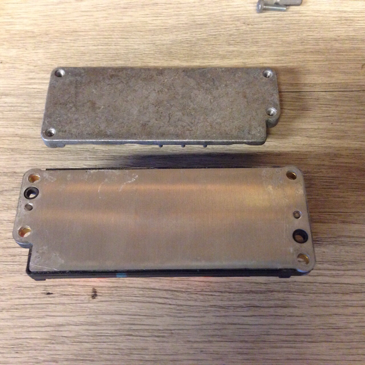

  2. Before you write the DP ECU off, unbolt it from the heat sink (4 torx screws). Clean the back of the ECU and the heat sink with some emery or similar. Reassemble and try on your bike. Remembering the little earth fly lead that goes on one of the bolts. Some have even put a smear of copper slip between the ECU and heat sink.
  3. chrisw: Thank you! Will definitely try that before buying a new DP ECU :)

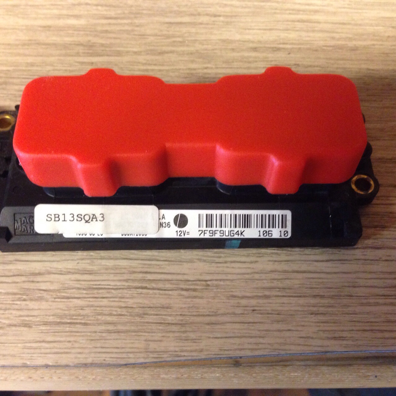

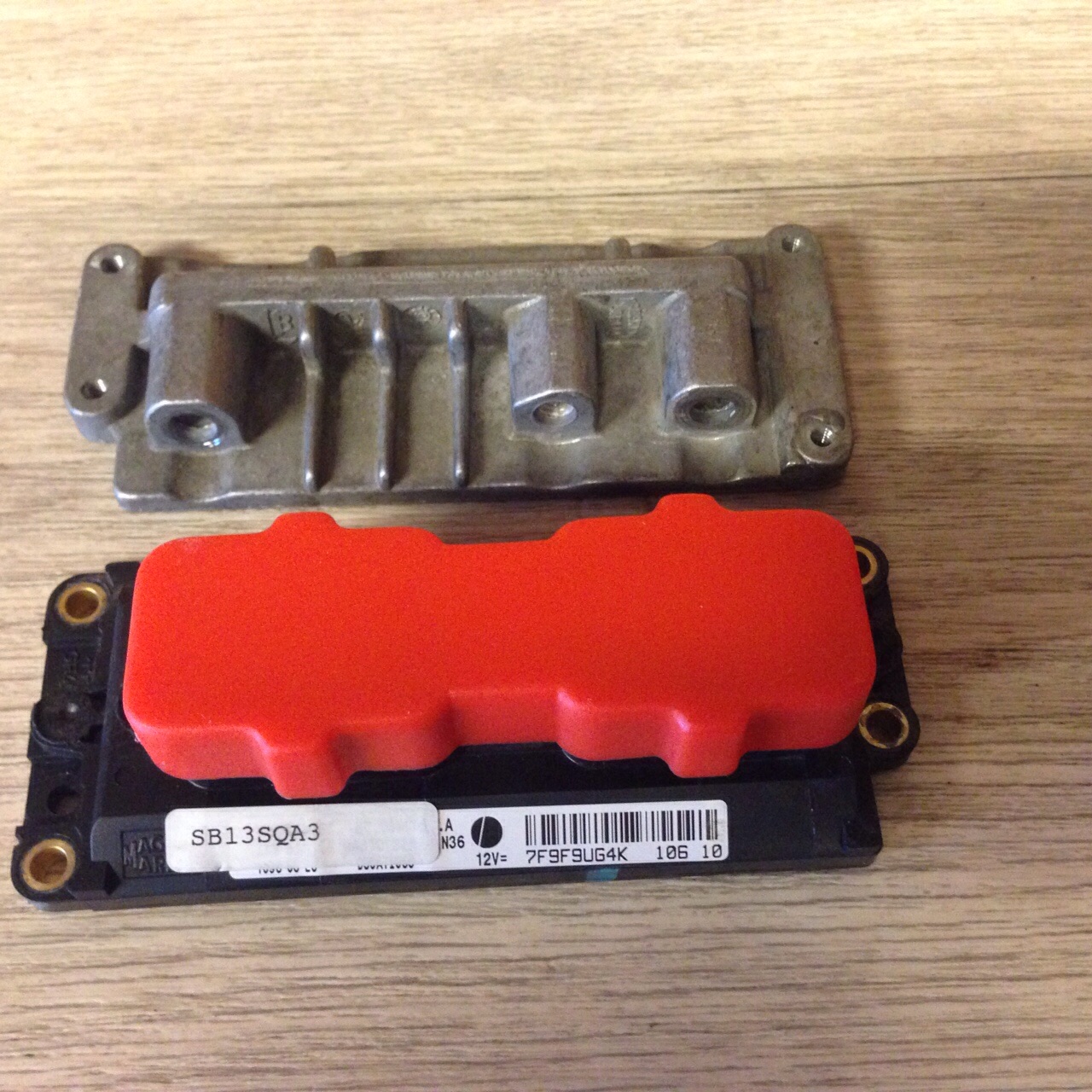

  6. Is it possible to disassemble this DP ECU more? Any obvoius faults?
  7. That's as far as you need to go. Clean the two surfaces in the first picture and reassemble.
    The ECU is the DP 96520309B for the 1198S.
