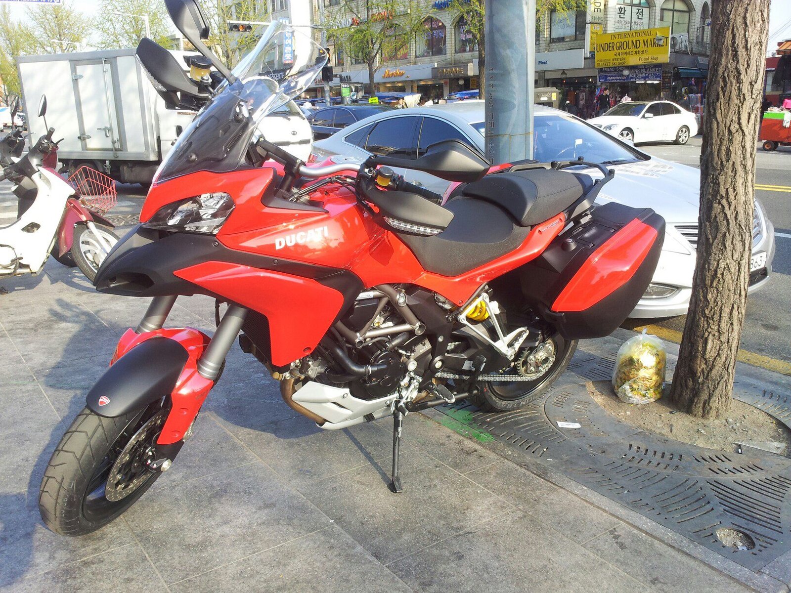

    I'm an American living in south korea and I've got a friend who is in business, and he's got a 2013 1200S Touring that he had put away in storage since 2015... It's got literally 8500 km on the odo.
    And he's trying to get rid of it along with all his other bikes as he's now got to settle down in Singapore for the mid-long term...
    I'm not exactly sure if it's been properly winterized or emptied or anything, but I was just wondering - since this is my first Ducati I've ever considered buying... would this even be a good buy?
    He's willing to let me have it for pennies on the dollar. It hasn't even had it's first desmo service done which I'm sure will cost a fortune :(
    But I'm wondering if there's anything else I need to look out for... It's obviously not under warranty any more. There are Ducati dealerships and service centers scattered about the country, so I'm not exactly worried about part scarcity... but I am worried about the head cam issue I've been reading about. Something about the coolant causing the head cam cover to crack?

  6. Looks in new condition from the pictures. With regards to parts, dealers here in the UK stock very few parts, I have to wait a week for delivery from Italy, I'd imagine it's the same in most countries. The belts will need changing but the valve clearance check is mileage based, not time based so that will not need doing until 15k miles. I've had two of the common problems you highlighted, gear lever return spring breaking seems to happen around 25k to 30k miles, mine went at 27k, very cheap part but you need a few special tools, and the best part of a day to fix it. Skyhook wiring problems again tends to happen with use, I've replaced 4 of the wires, first went around the 30k mile mark, costs nothing to fix if you have a soldering iron and can be repaired in an hour. My 13 is on 38000 miles now and rides like a dream.

  8. The issue with the heads leaking was on the early bikes, the coolant corroded the aluminium casting. There was a recall to change it, so you might be able to check.
    If you start the bike up from cold and see lots of smoke then you know you have the problem, this is what it looks like after being left overnight.
    (Of course if the bike hasn’t been started for a long time it might still smoke!)
  9. Thanks!! would a 2013 MY MTS fall under that category? I'm a bit out of the loop in terms of what is and isn't an early MY
    but yeah now i know what to look for! appreciate it!
  10. First gen is 2010 to 2012. The twin spark with Skyhook is gen 2. Andy
  11. If it’s a 2013 model then it should be the 2nd gen Twin Spark engine, don’t think it affected this model.
    Quick way to tell, has it got LED headlights (1st Gen were halogen) the main beam are still halogen but the dip beam and running lights should be LED if it’s a Gen 2.
