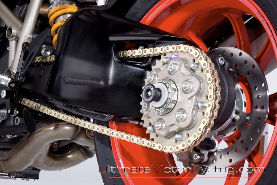

  9. Found this on a 1198

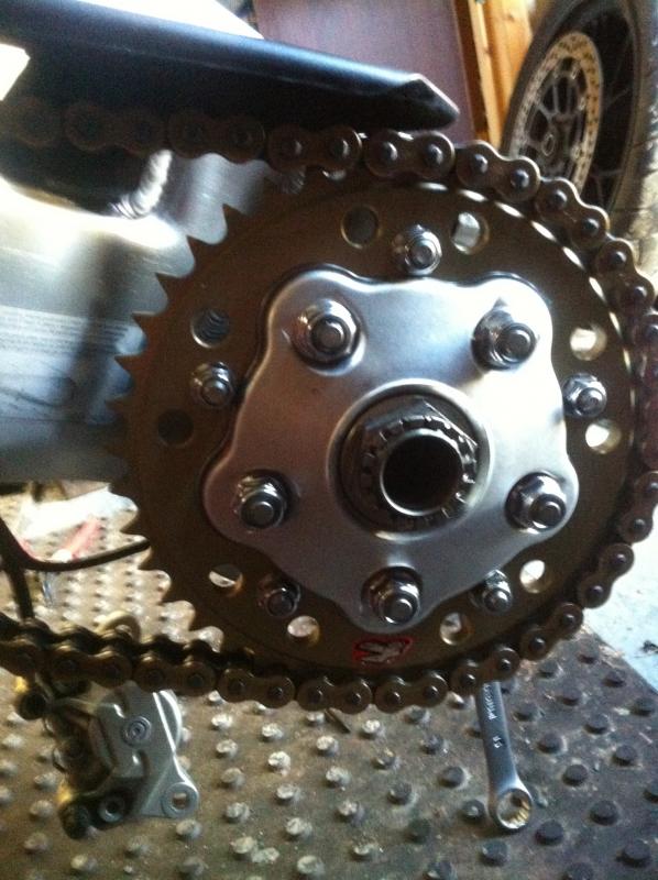

    This is mine on an 848 only a crappy phone pic though
  10. Don't you just love those agricultural orange wheels! Was he colour blind.
  11. Thanks for that Spoonzs. It looks mint against that black frame. I'll keep pondering for now but I'll probably go with the gold chain and Renthal sprocket kit.

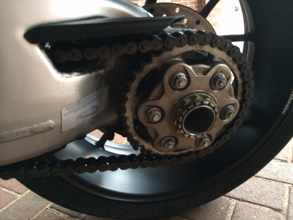

  12. This is the mess I have at the moment. Anything would be an improvement.
  13. Fpmsl it would be cheaper to buy the chain you want, add a renthal carrier and sprockets, decent chain tool and do it yourself. One of the easiest jobs with the right tools, and not too difficult without them
