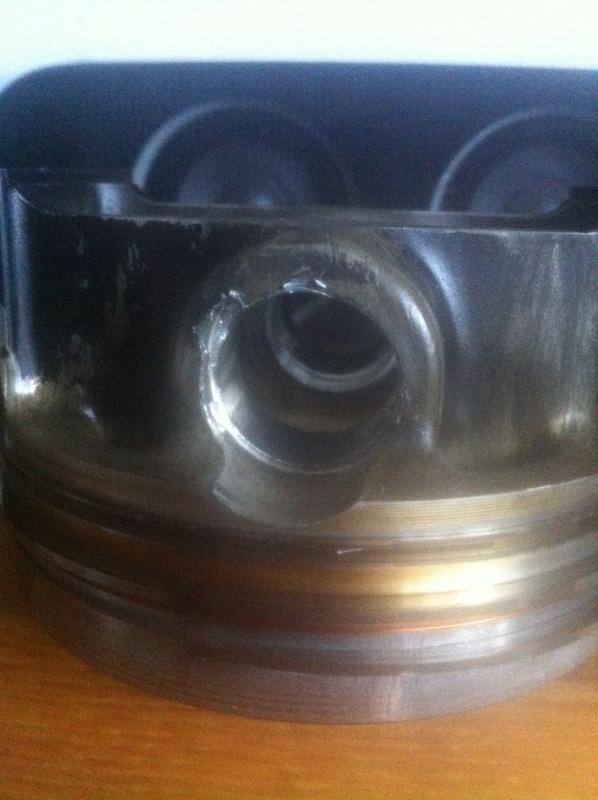

  12. **UPDATE**
    You're all wrong! As was I, I should probably listen to my Dad more often, he got it spot on from listening to it. it was a gudgeon pin failure on the bottom cylinder.
    Which makes a lot of sense as the bike ran fine with no power loss, so it was never going to be valve related. I've kept the engine is top nick, and the tolerances in the heads are still all lovely and there was no contact between valve and piston at any point.
    However! this does leave me one knackered piston and a nicely scored bore. the scraper ring is also trashed so can't reuse that (probably not a good idea to anyway, but at £70 a cylinder from Ducati it's awfully tempting). so they'll have to be replaced. I split the block and the swarf was minimal, bottom end is solid, the plain bearing in the top of conrod took the hit so thankfully the rod is straight and true.
    I hope this helps anyone who encounters this noise on their Supersport, I'll just have to take note to give her a few more miles to warm up when the temperature is only 5 degrees!
    here is a pic of the damage to the piston, what you can't see from the picture is the gudgeon pin hole is oval!
  13. I apologise. 'ChewyTheKneeslider' was right with his diagnosis. and to iterate his thoughts, there was no debris in the combustion chambers.
  14. Glad it's not too bad and with respect Jacques, we couldn't inspect and try different theories 'in the flesh' like you two could though? :wink: also failure of the pin itself is a very rare occurrence (FPE/IMO) - I would love to see more pictures of the remainder of the pin particularly around the failure/break area. I have E-mailed you back re: engine but i don't know if you got reply. Best regards Chris
  15. I'll be a more specific about what failed for those that are interested. If you look at the picture of the piston above, to can see the metal has torn around where the circlip that holds the gudgeon pin in sits, what's happened is that for whatever reason, the circlip has been forced out by the gudgeon pin, and then the gudgeon pin has slid out until it's met the wall of the bore, where it's scored it. The gudgeon pin itself is actually unscathed to look at, the bearing surfaces are actually fine, and the old test of rolling it on a flat surface don't highlight any obvious signs of fracture or misshapenness, but I'll replace it for peace of mind. Also, the circlip was found stuck to the magnetic sump plug, it's intact and not misshapen at all! lucky or what? I wasn't looking forward to checking the bottom end for bits of it.
    So, perhaps it's fair to call it a piston failure? I called it a gudgeon failure simply because it wasn't that dramatic.
  16. sounds more like the actual circlip has dislodged Jacques? - reasons for this can be many but it is a fairly regular 'fail' on engines generally.
  17. Maybe soemone had it apart in the past, and put it back together with the old gudgeon pin circlips? Thats the only time I have ever heard of one failing like that.
    My dad had a Velocette Viper many years ago, which spat out a circlip when he re used a old one after a rebuild.
    Shame, if you needed a 900ss piston, I have a good second hand one of those knocking around which you could have gratis.
  18. Was just about to post the same! :biggrin:
    For the sake of a shoe, the horse was lost...
  19. It does rather look like the piston has failed on the outer edge of the circlip groove, doesn't it?.....You can actually see the shape of the end of the circlip 'cut' into the piston.
    Otherwise, there was some thrust on that gudgeon pin.....
    A circlip that has been reused; badly fitted or the groove not cleaned before the clip was fitted are all quite understandable; but being pushed out unscathed seems a bit bizarre.
    AL
  20. my thoughts exactly Arquebus, very bizarre.
