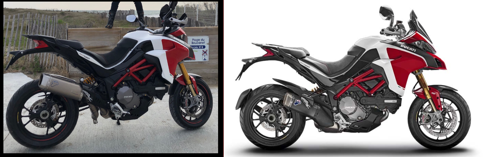

  6. There's really four things at play:
    Tone is improved
    Weight savings is significant
    Increased power is improved albeit marginal
    Look is worse than stock (relative to a Pikes Peak).
    I agree with those that wrote that the full Termgnoni is not overly loud. Certainly more civilized than the SC-Project on my Monster.
    I would love the weight savings and uncluttering the bottom end of the bike.
    My issue is a personal one and highly subjective. I can't get past the look of the full Termi silencer.
    I find the titanium silencer huge (nearly 2X) and not as good looking as the Pikes Peak Carbon Fibre Termignoni.
    And then there's the price.

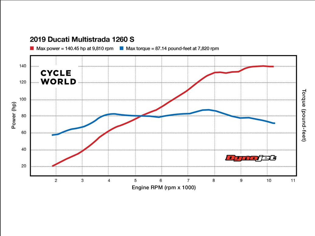

    The fuelling is not an issue on the stock 1260 like it was on the 1200 DVT.
    It would be nearly impossible to improve the flatness of the 1260 torque curve as this dyno chart shows.
    However, adding a full Akra would require a Rapidbike.

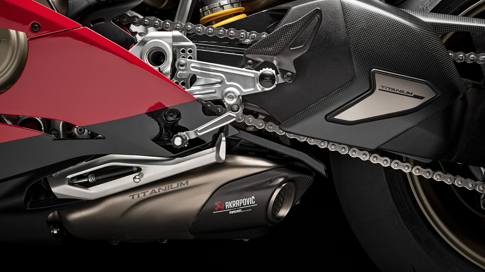

    I don't want to start another thread as this topic has been beaten over real good.
    I would like to simply De-Ugly the Cat with ceramic coating.
    There's some great info on this forum about the work some of our brothers have done in this context.
    The ugliness and the weight of the stock Cat-Box are its major points of contention.
    This has been solved with the stock OEM titanium Akra fitted on the Panigale V4 25° Anniversario 916 as shown here:
    It's not going to happen but out of curiosity, how many of you would have agreed to buying a homologated titanium & aesthetically finished Cat-Box if it had been (or was) available?

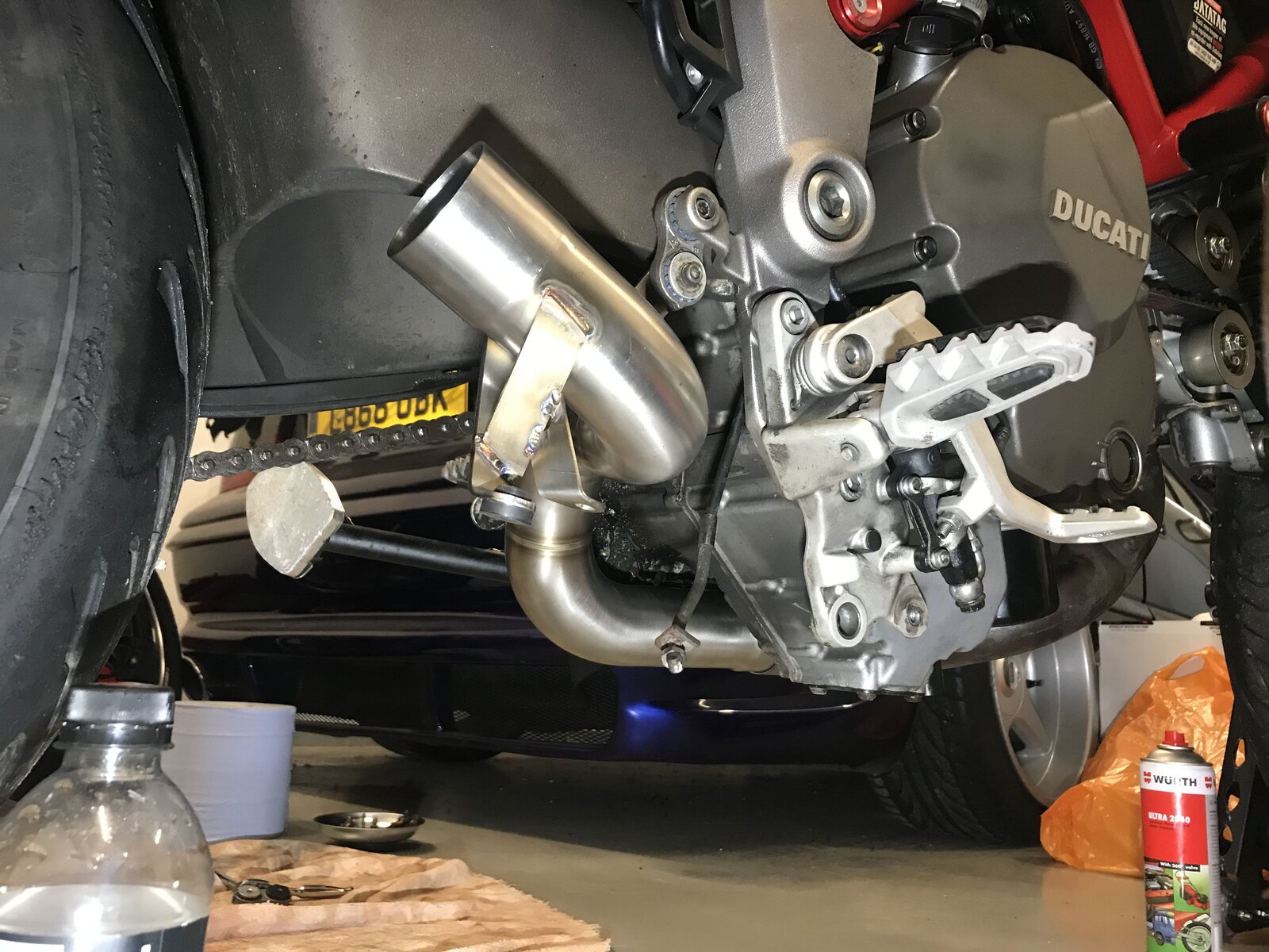

  12. Job done in 2h , the cat is out 5Kg lighter bike :D... I tried to upload video with sound but its not possible here :pensive:
    for me its not too loud ... I actually really like it !! But for MOT and longer touring trips I will install db killer from Ebay..just need to find the right size .
    I test ride it today and can say that throttle response improved !!!! And it feels like the bike got more power now!!
    Do you guys think i need to get id dyno and remap now ?:thinkingface:

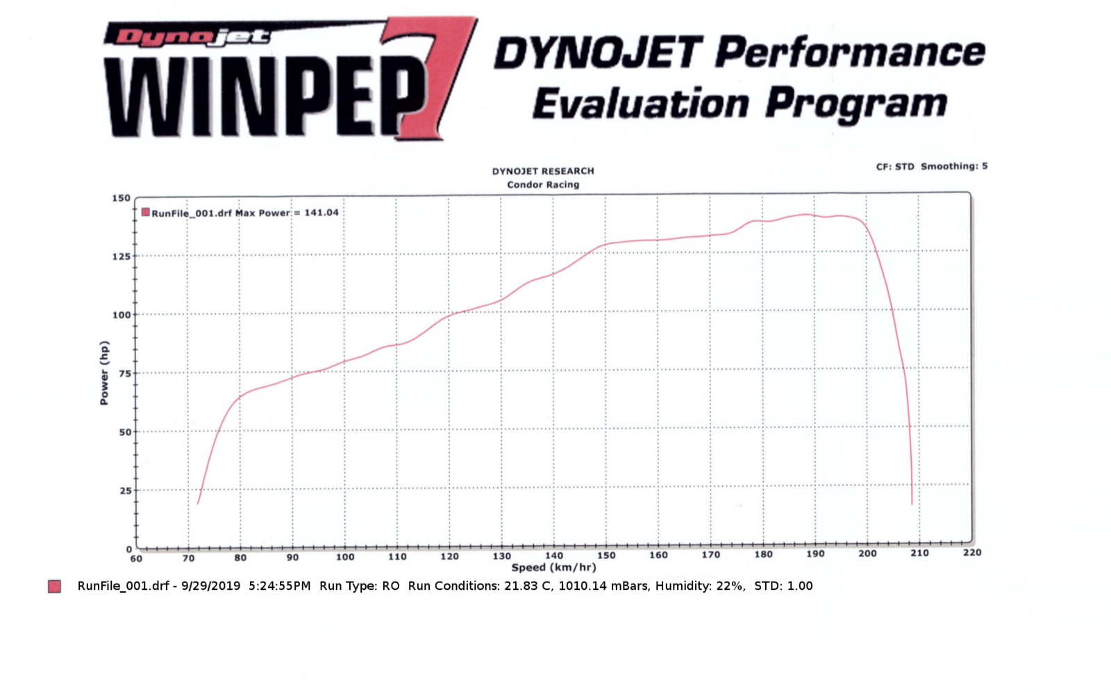

  14. I've put my 1260 on the Dyno without having changed the exhaust like you have.
    On a 1200, I would Definitely buy 1) a Rapidbike unit and 2) put it on the Dyno thereafter for fine tuning.
