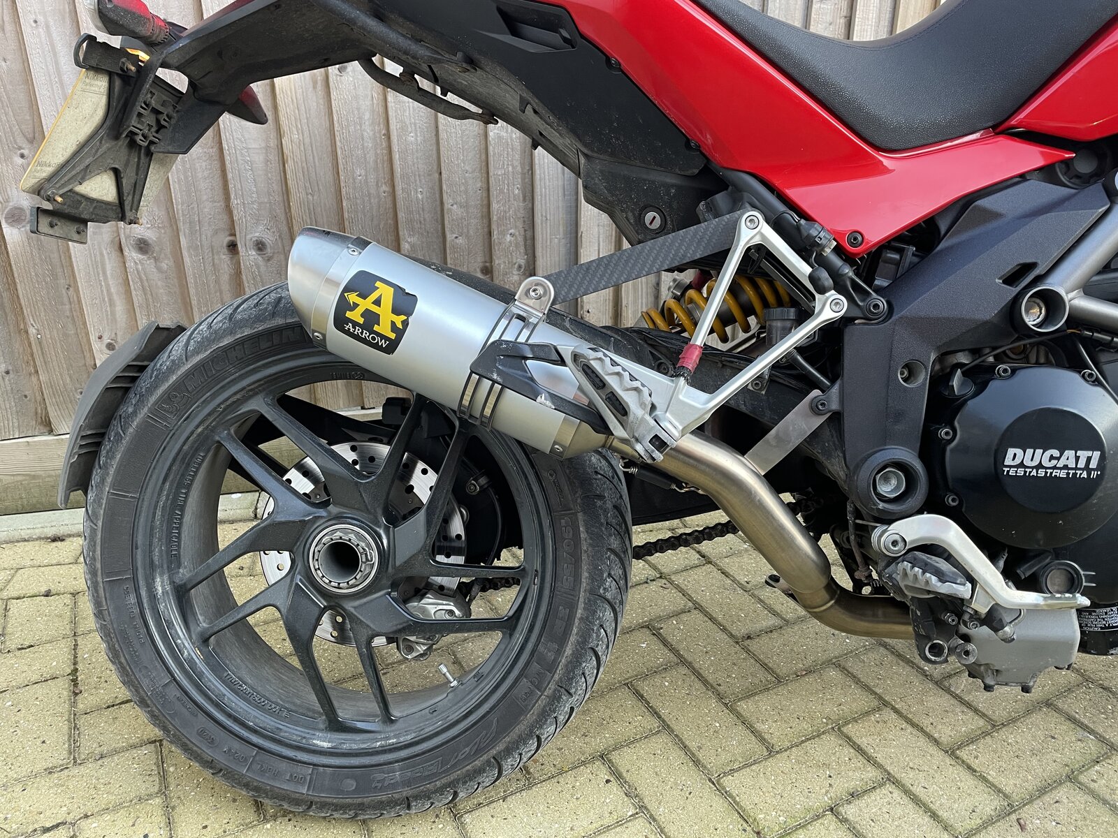

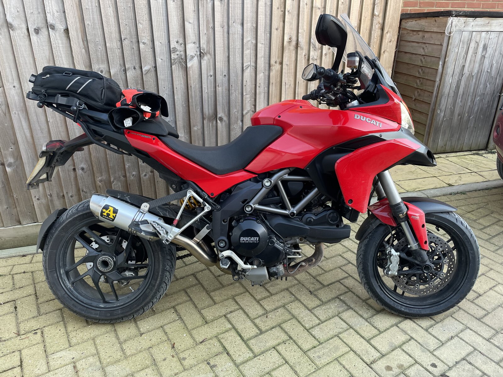

  10. I went for the Arrow Thunder. In aluminium. Not arrived yet
    well this arrived and is fitted, quick ride out today and it’s miles better sounding than the GRmoto silencer. Not taken the baffle out yet so I’m expecting it to be loud. As it is though, it adds a nice deep sound which is not offensively loud. All good so far.
