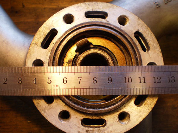

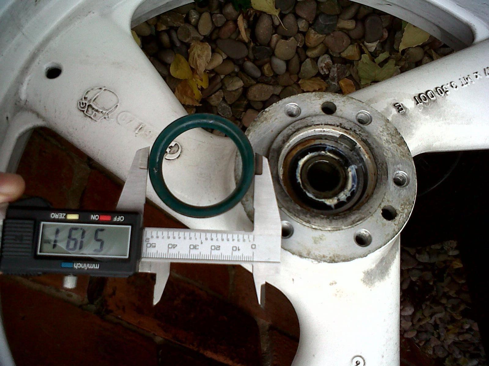

  4. I meant to say, the front wheels differ because of the speedo drive diameter........the easiest way to tell if it is early or later, is to look at the central brake disc 'retaining ring lug' on the speedo drive side........Early wheels; the lug is approx 6mm wide and later wheels it is approx 4mm wide......
    Top pic = later (shows the thinner grease seal as well)
    Bottom pic = early (courtesy of Chewythekneeslider)
