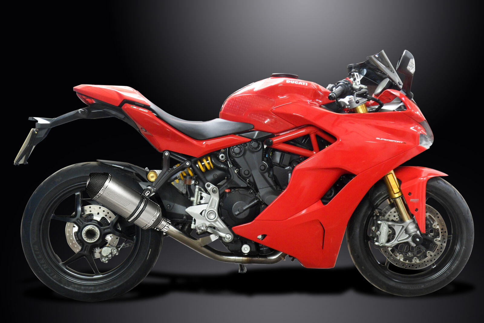

Hi, I am thinking of investing in one of these exhausts as it includes the CAT delete. Great value at £330. as far as I know from other bikes their quality is good. It may not be the most attractive on the market, I don't mind it and the you tube video shows it has decent sound to it has anybody else used one on their Ducati ?
The forum search function only gets 1 hit for a Diavel back in 2016 and that’s a simple, I fitted a Delkavic. Quoting db levels is about as reliable as quoting rear wheel hp figures, so take their claims with a bit of caution. My girlfriends ‘17 SS has the full, wheelbarrow Akrapovic and that is ear bleeding loud without the baffle. You would also need to source a gizmo to delete the exhaust valve error message on the dash. I ran my Multistrada with a decat and the O2 sensors coped pretty well but got it mapped in the end. Andy
Cheers, So the de cat will throw up an error then, does anyone know how and what the gizmo to cure that is ? I did a search and saw the other thread but no detail as you say.
It’s just a small plug in for the servo motor wiring, there was one for a 959 for sale on here last week, https://www.ducatiforum.co.uk/threads/959-healtech-servo-eliminator.84496/. Pretty sure Healtech aren’t the only ones who do a gizmo. Andy
https://www.vizi-tec.com/servo-exhaust-emulators/ Ive had one of these on my previous multi and worked with no issues. I think @nelly on here sells them. Also https://www.healtech-electronics.com/products/ese/ I've just recieved one of these for my 1260 but not fitted it yet
