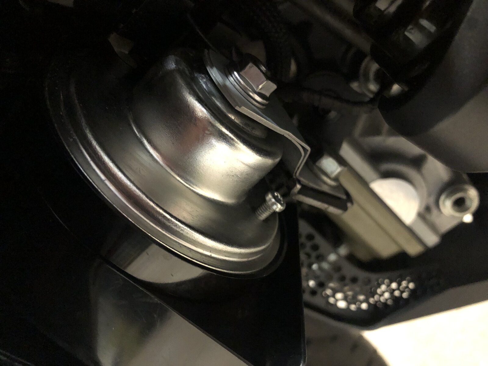

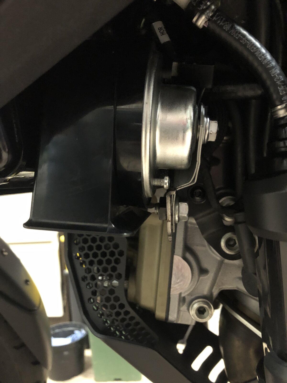

  2. Well I've fitted a DSB horn to my 1260, using the original location and other than slightly bending the mount to accommodate the larger body of the horn, as far as I can recall, no other modifications were required.
    Simply plug & play.
    I'll re-check my comments by taking a closer look at my bike tomorrow and let you know if anything I've said differs, however, I don't think it will.
    If you want, I'll also take a photo of the horn + mount to show you what I've done to enable the fit.
  3. It would be brilliant if you could take a pic and let me see how it is.
    I take it you have fitted the mini soundbomb version?

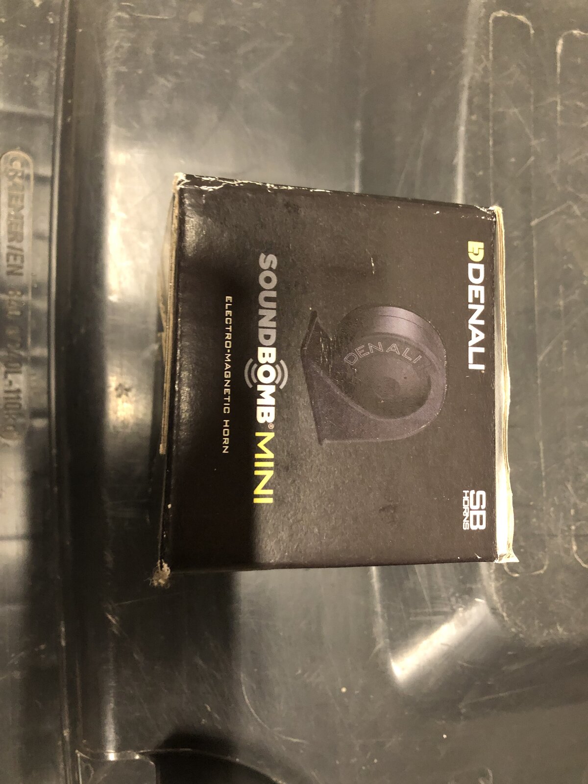

  4. Leave it with me and yes I'm pretty sure it is a mini version as fitted. I've still got the packaging with the original Ducati unit stored inside, so will be able to verify either way.
    I'll attach a photo or two tomorrow FYI. :upyeah:

  9. TL, here's the photos I mentioned I would send over to you and yes as some of the guys have said above, the DSBM is a big improvement on the stock horn, noticeably louder and deeper too. IMG_2387.JPG IMG_2388.JPG IMG_2389.JPG
    Mine is not a 'perfect' fit, which will no doubt drive those here on the forum with OCD absolutely barmy, but it can't be that easily seen and performs functionally fab', well for me at least.......:grinning:

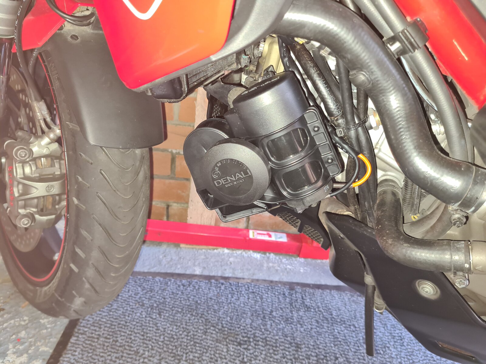

  14. After reading the threads on this post, I fitted a DSBM to my 1260S at the weekend.
    Really quick and easy to fit, it’s supplied with a double bracket, so I left the OEM bracket attached to the OEM horn as the DSBM bracket requires a dog leg setting in the bracket so the new horn doesn’t knock the radiator, nice and loud, and a lower tone than the strangled budgie supplied by Ducati!!
    So thanks for all the info on this posts and the pictures, most helpful.
