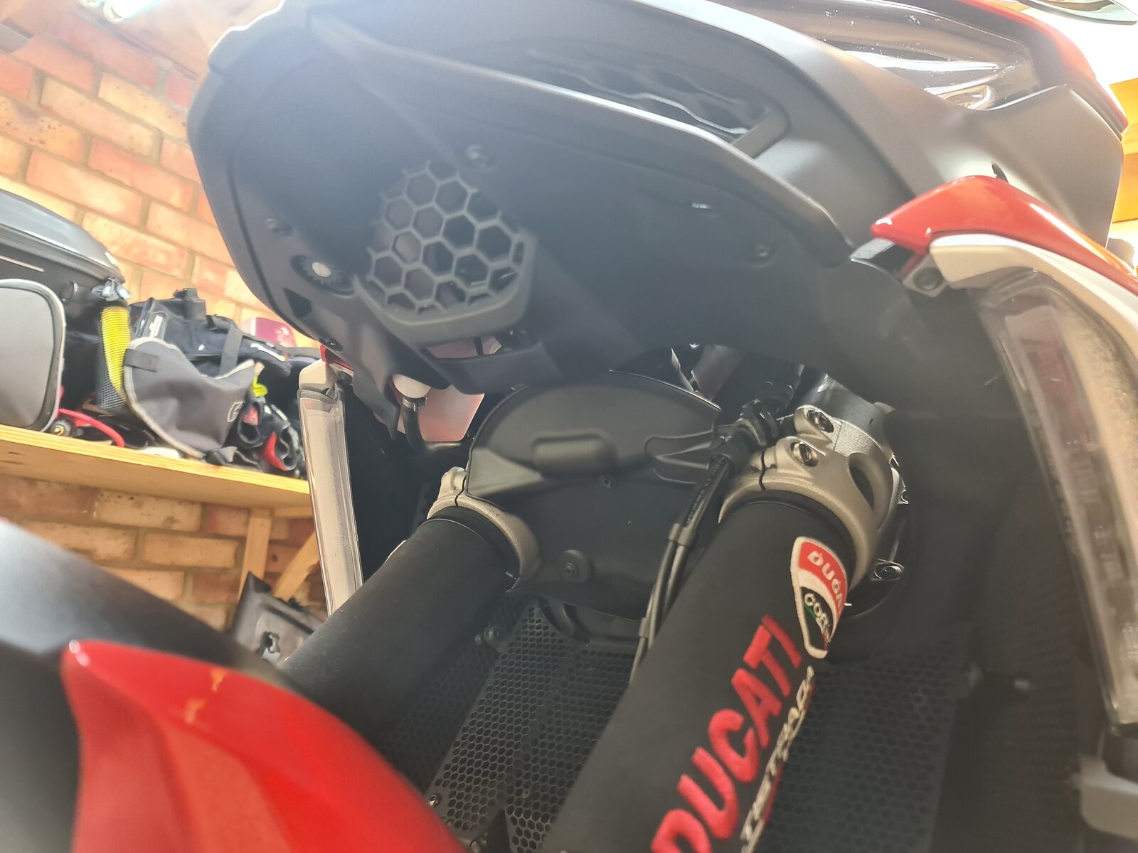

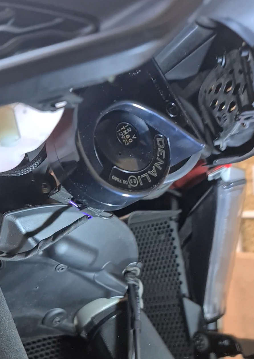

  1. For those that aren't sure whether to or not, I've fitted one to my V4S Sport. It took 5 minutes and I left the original bracket where it was and the original nut was also re-used with some threadlock. I took some video for the sound comparison but the site forum doesn't allow direct uploads.

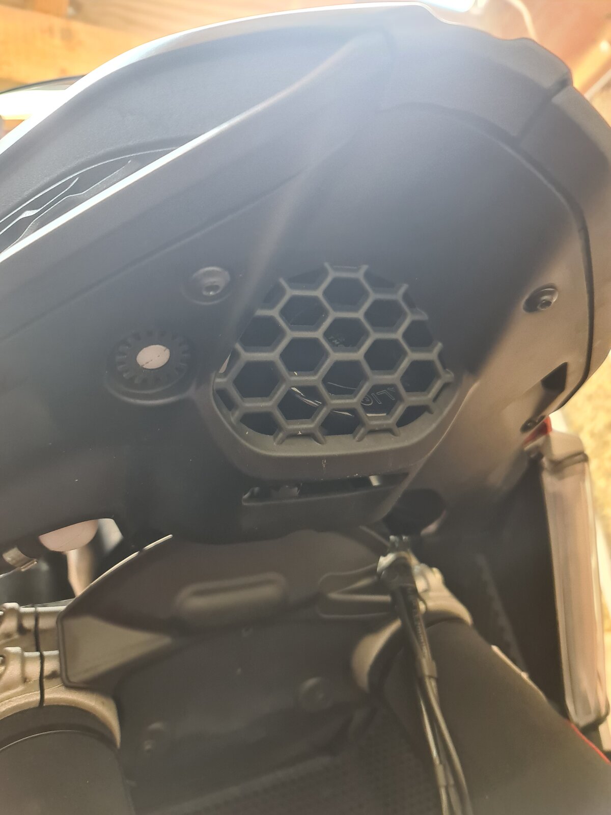

  3. Do I just remove the bolts visible under the front beak if I want to do the same then ?
    Thanks for sharing.
  4. Yes, there's 4 screws, undo them and remove the black plastic cover underneath the beak. Then you only need to remove the 10mm lower nut and the 2 wires. Repeat in reverse for the new soundbomb but you may need to rotate it to make sure that the cover doesn't hit when replacing.
