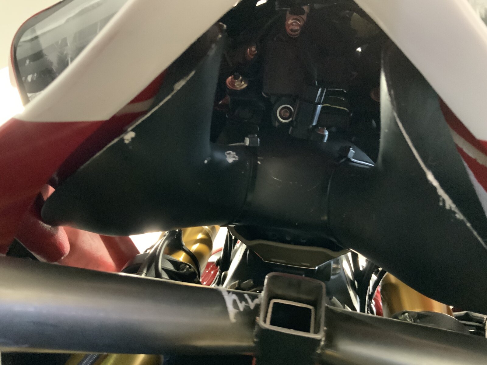

This is the sensor not sitting correctly in the air duct which is above the front wheel. A common problem when track fairings fitted
