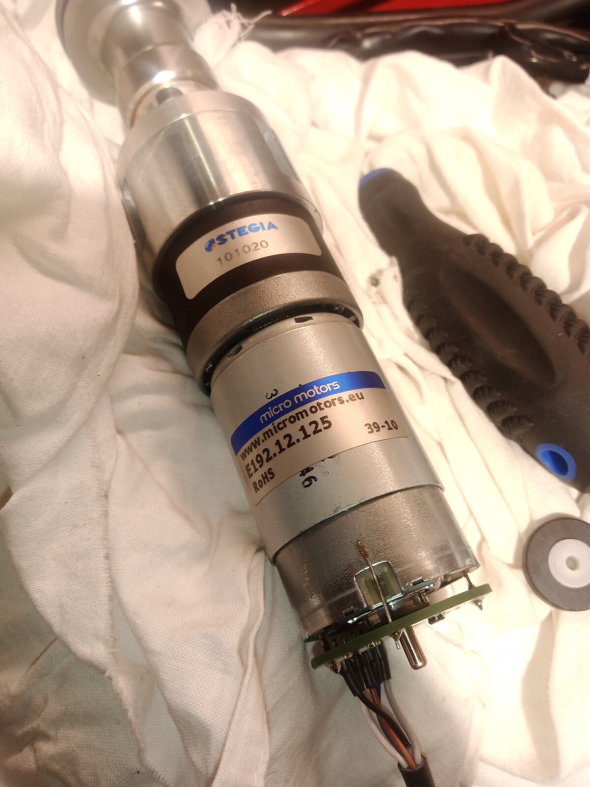

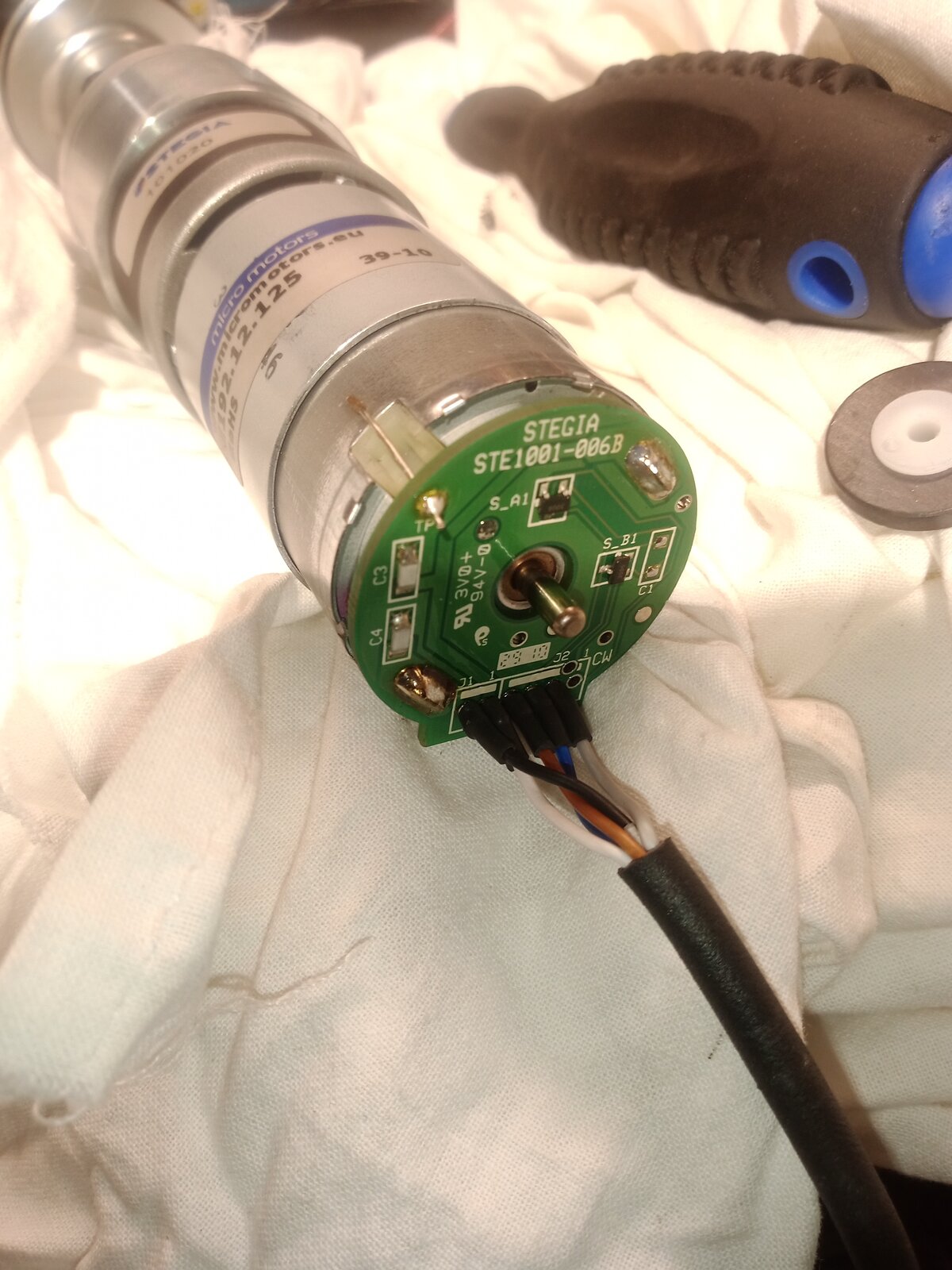

  14. My MY2011 Multistrada 1200 S has now two rear (2010-2011 36520952A) shocks with electronic failure inside hydraulic servo pump tube. I have also Öhlins SCU semiactive 35000-03 update installed.
    Both rear shocks do calibrating procedure just fine after reconnecting battery. Preload stays at highest level after calibrating sequency. After that nothing happens: preload setting does not change by setting riding modes and preload settings.
    I checked cables and connectors; everything ok there. After that I punch with rubberhead srewdriver to the side of the pump tube: Everything works now! (Edit: only 15 minutes failure was back)
    So there is/was something loose or jammed inside servo pump tube...
    What kind sensor is used for tracking movement of the hydraulic piston ? Could wrong installation angle of the pump tube could cause this kind of failure when driving bumpy roads?
    Has anyone open this "worm can" and fixed it DIY ?
    I have studied whole internet and only information is that new 2012 version rear shock 36520953A has been improved and is not affected by this kind of failure. But what has been changed/improved...
    #14 maja2, Jul 1, 2023
  15. I soldered all components on PCB and cables also, nothing special there... I measured from PCB to Ohlins SCU connector: every 5 cables and connections ok. Tested also without magnetic disk: calibration cycle stops in a second so missing pulses are notified just fine by Ohlins SCU. So maybe the problem is dashboard and communication towards Ohlins SCU? Dashboard get all errors from Ohlins SCU just fine but cannot send DES setup changes to CANbus?
  16. Flashed ECU to standard and once again with Tuneboy version. But ignition on without any Öhlins SCU-> shut off-> battery disconnect->reconnect battery->put Öhlins SCU back-> ignition on->everything works. Both preload servosystems works just fine. ????!!!
