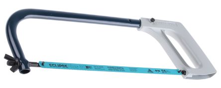

  2. Spear and Jackson :thinkingface:
    Sorry, I'm just taking the Mick but I don't know :D
    Sure somebody more helpful will be along soon
