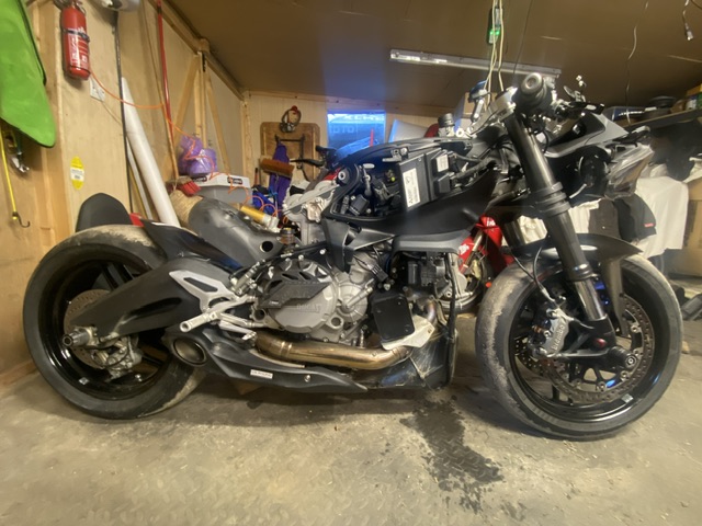

  1. My 899 is having its 15,000 mile service next month.
    Anyone had theirs done with this mileage and did valves need adjusting?

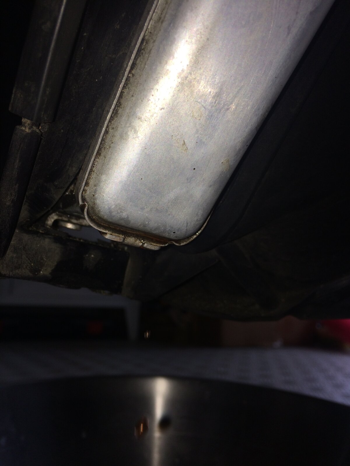

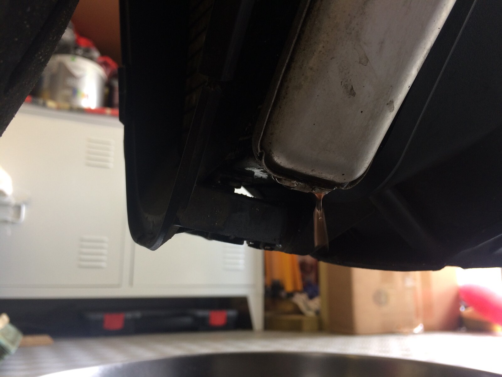

  10. My 899 bottom rad leaked at the side. No damage from any object hitting it at all. Mate’s bottom rad on his Tricolore 1199 went in exact same place. Again no foreign object hit it. Grrrrrrr

  12. I put a aftermarket Chinese one from eBay on the bottom of my 1199 after the original one started leaking on the bottom left corner when sitting on the bike, No damage to the radiator it was more like a weep from a fracture where it was welded,, Chinese one still going strong 6000 miles later
  13. @quik thats exactly where ours went too. Crap weld or crimp.
    @southlondonCBR A new Ducati one was put in. Just south of £400. Bloody rip off. Need to send the old one off to see if it can be fixed.
