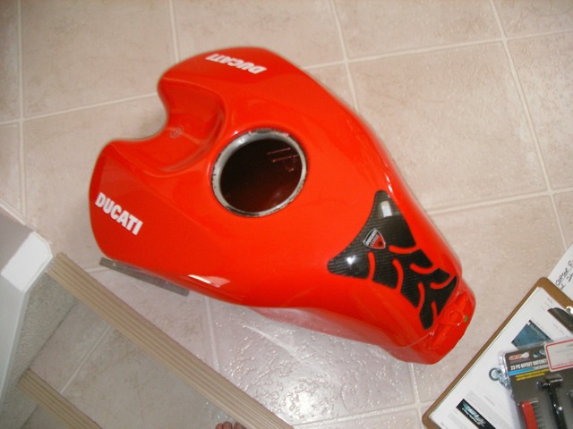

    My trip to Scotland with Ducati Manchester was really helpful as I was introduced to a couple of current and ex-D16 owners, one of whom gave me a lead on a blemished tank for sale. He also gave me the name and number of a guy in Hull who has experience of doing the ally work to enlarge one on another bike. A few phone calls and a bit of Paypal later and I have acquired the tank and it is on its way to Hull.
    I need to get a fuel cap for it (I'll leave the standard locking one in my existing standard tank).
    Any recommendations?

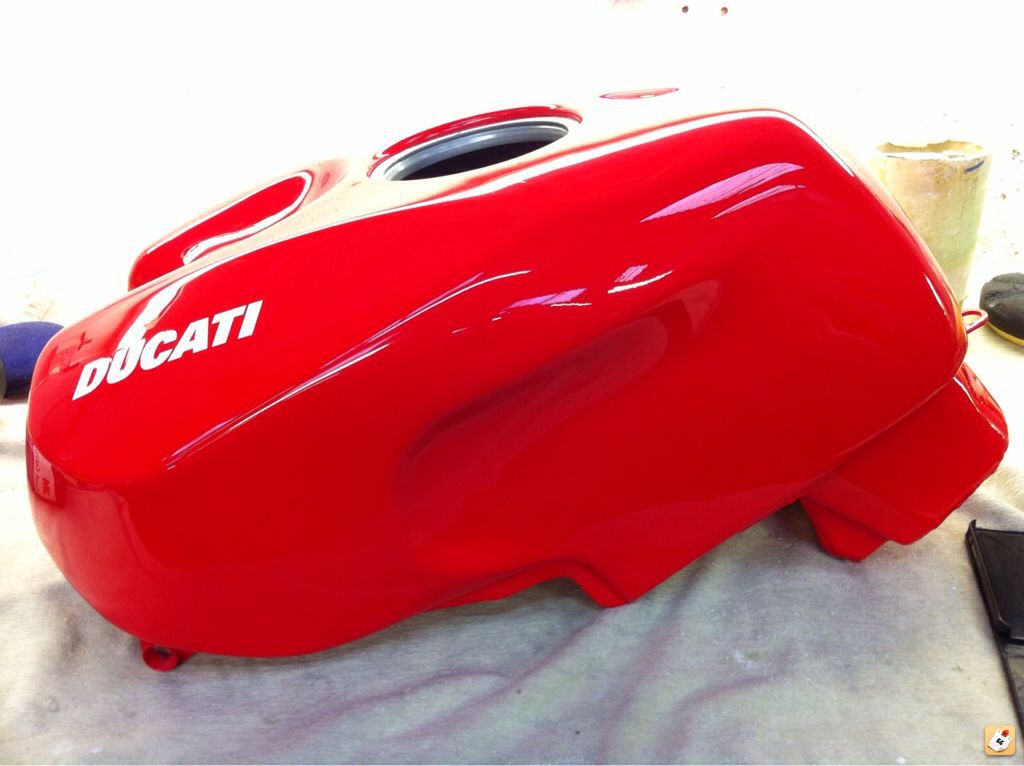

  10. 20130909_100242_zps9dbe7093.jpg this is how it started out.
  11. Can't quite remember why, but it didn't work out. I got this one from a contact I made on the Ducati Manchester Jockland trip last year.
    Blimey! How'd you get this pic then?

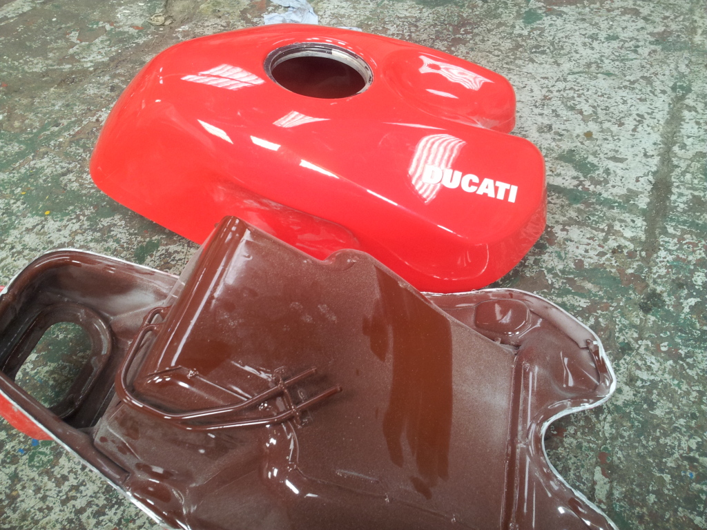

  12. I did the fab work on the tank and the other one you mentioned.....looks nice finished have you fitted it yet??

  14. not sure to honest,the first one I did I was asked to enlarge capacity without the tank looking out of place

    By the way nice work rcv4.My MS Production carbon tank is different shape to standard for my 916.Not sure it holds much more though as although it is wider it is also lower than standard fuel tank.That DR16 tank you enlarged looks like the perfect solution to me.

  18. Like this titanium one for a cool £600!?! :eek:
    Actually I have just moved the standard locking cap over.

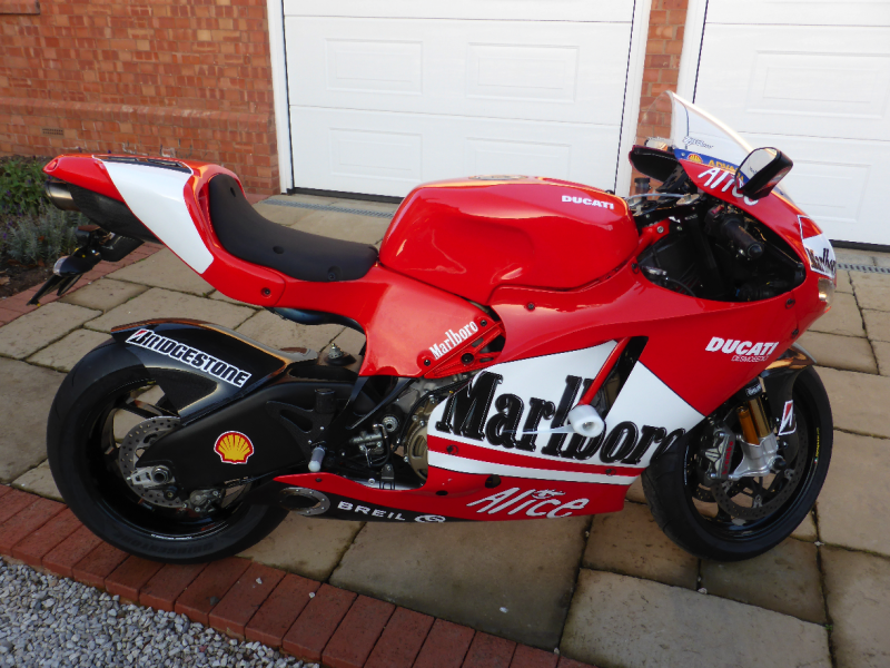

  20. Ok, here is a pic of the bike with the enlarged fuel tank fitted. Looks fine don'tcha think? Still haven't filled her up or ridden her (salt is down on the roads around here) but I will file a report just as soon as I have.
