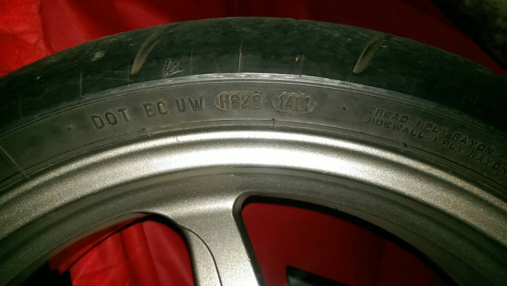

    so they will be well past useable grip by now.
    Can you read the date codes on them ?
    4 digit codes.
    Ie: 2314
    Week 23
    2014
  3. May explain the spinning up, it's quite exciting, will check tomorrow.
  4. F: 1711
    R: 1411
    So 4years old, should be ok still.

  7. Blimey i thought they stopped making them way before 2011!
  8. Unless I'm looking at the wrong bit.
  9. Nope you read them correctly
    They must have been stored in daylight or extreme temperature.
    They might improve with more miles
