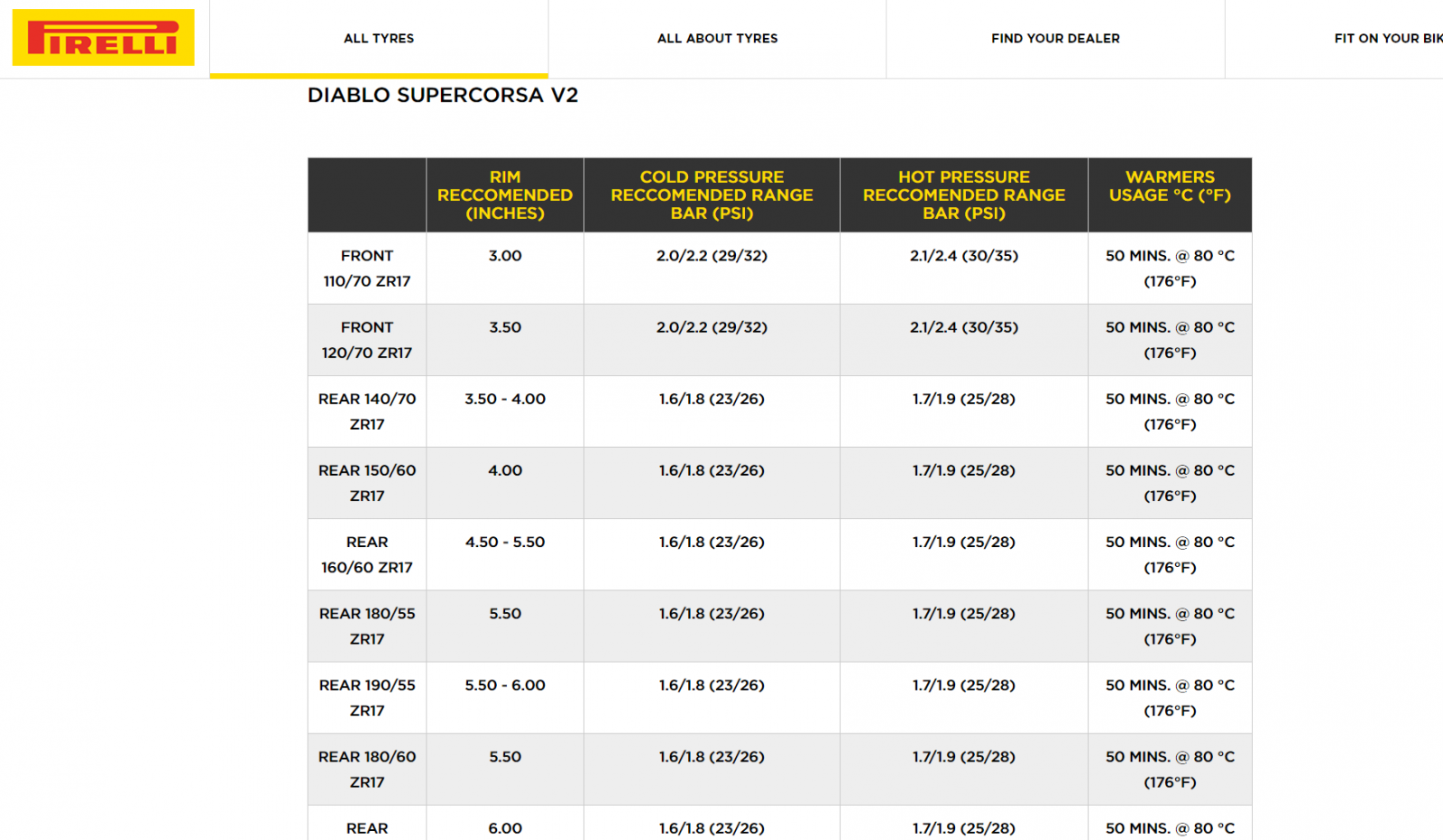

  18. Too much air in the rear especially if it doesn't usually happen, you haven't changed the bike's settings, and you're used to these tyres. Either that or being greedy! :imp:
    (these new emoticons look sooooo crap!)
    I guess you've got the maker's recommendations?
    Edit: 200/55 as 180/60
  19. Ah. I don't have SC. Didn't realize Diablow were SC too.
