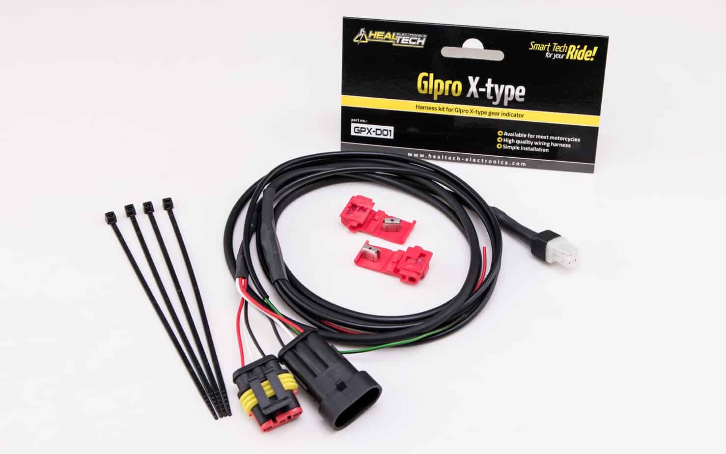

  4. The four pin connector is for later bikes. You need this type of connector as far as I can see.
