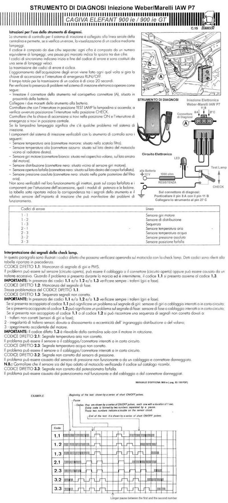

  1. Anyone know if this can be used on an old 888 with p7 ecu?? How much info will it pick up??
  2. If you are referring to JPdiag, no it can't. The only way I'm aware of is to use the test light circuit and read the flashes from the LED. ECU test light.jpg
  3. Almost definitely not. All the bike listed use the IAW59 or IAW5A ECUs.
  4. Cheers, Any idea if a test light thingy is available to buy like the one in your post??
  5. I doubt it but all the info is there to make one yourself.
