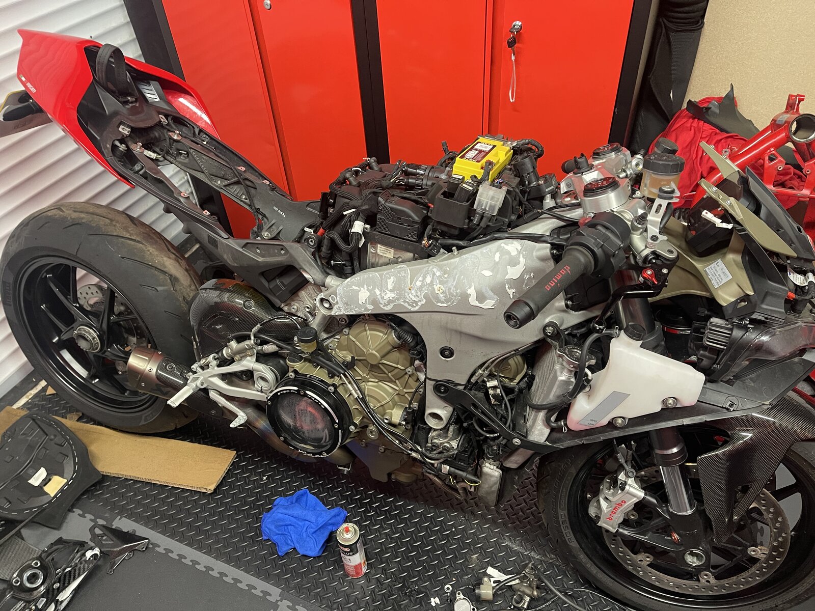

  1. So, been wanting to do one of these for a while, bit of a record all the little bits and bats I end up changing, how I did it and where I got the bits from, hopefully might help some people convert their road bike if that’s what they want to do. Or for no one to read but at least I’ll be able to revisit it :laughing:

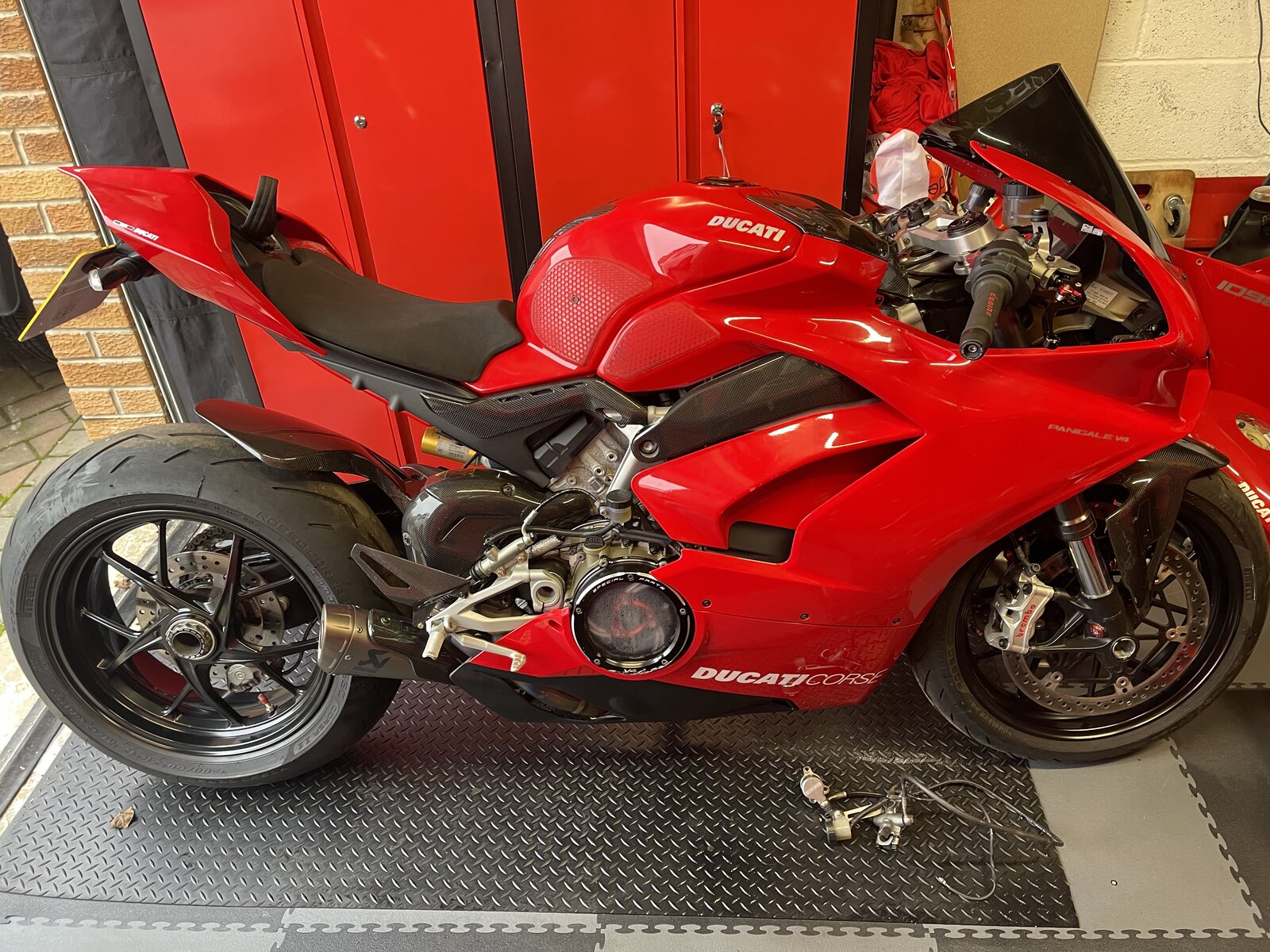

    In December 2022 I picked up this 2018 Panigale V4 with 10k miles on the dash but apparently the engine only has 3k ish on it (the seller couldn’t evidence that however)
    first things first, get the full akra, gloss carbon and Ducabike clear clutch cover off the bike. The exhaust is too loud for most of the UK so that’s going to be sold when Phil at Storm Performance has finished using it to make a track friendly slip on for some of his customers.
    I’m not a massive fan of gloss carbon so that’s all gone on ebay.
    And the clear clutch covers :thinkingface: each to their own but it’s not for me. I want a dry clutch conversion but that might be an addition for next winter
    I love having to remove silicon adhesive from motorcycle frames : unamused: some WD40 a plastic wrap applicator and some elbow grease to get them cleaned up

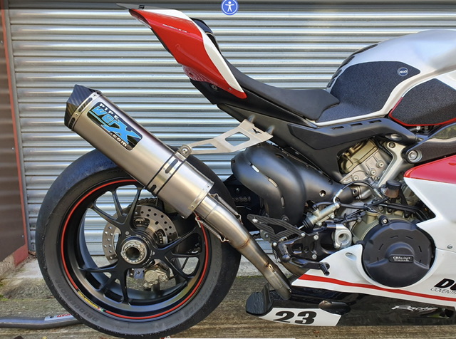

  9. I’m getting one of Phil’s (Storm Performance Fabrications) underseat systems. The Tesco friendly cans and the obnoxious euro cans :grinning:
    I’ll update with performance and weights when it’s fitted and mapped. :upyeah: Might be a couple of months off that tho
  10. I saw the 89db as well as the potential HP gain and thought - how are they performing such voodoo?
    And looking at the more traditional design I now understand! Ducati has a tendency in certain areas to go with form over functional and Exhaust design is definitely one of those areas! (won’t mention single sided swingarms)
    @bradders - you might believe some of the claims if you see the designs - obviously the bhp gains claimed by any manufacturer are utterly spurious and subjective as Dyno results are so wildly variable and seemingly dependent on the the day of the week and where the moon is and what star sign the operator is! :D
