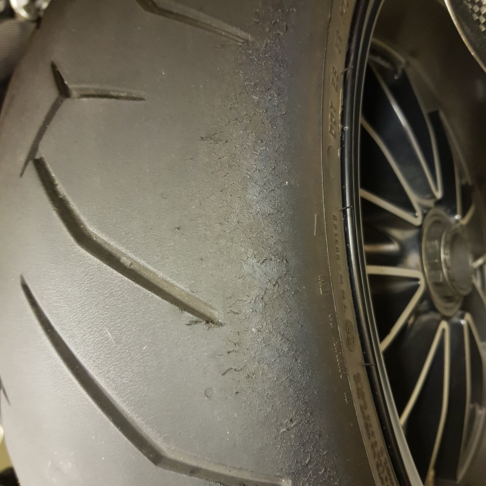

  10. Not in a 240/45/17. Andy

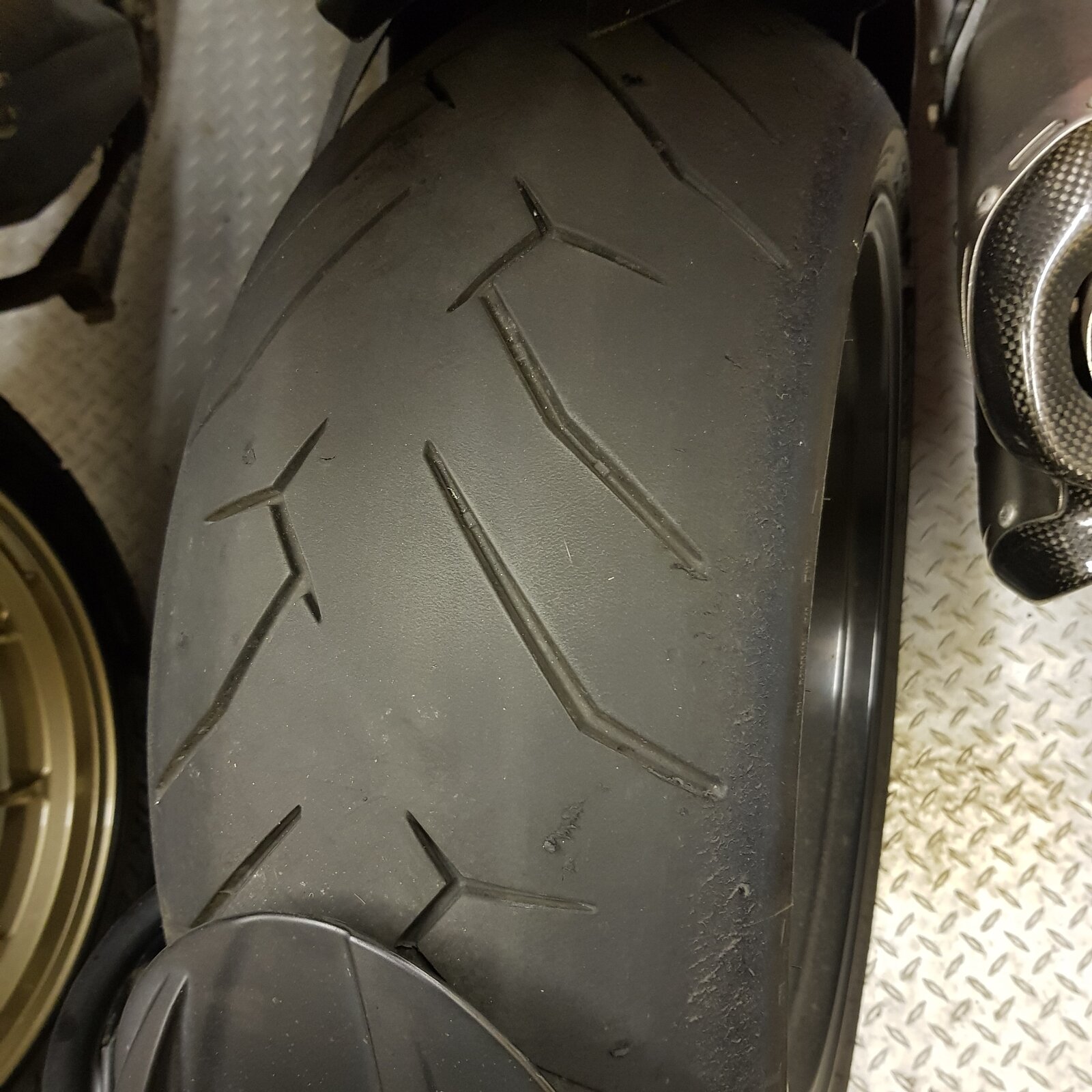

  12. 1000 miles wear including a track day on a Rosso II. I'd say good for about 3000 miles total. Andy 20190710_181724.jpg 20190710_181751.jpg
