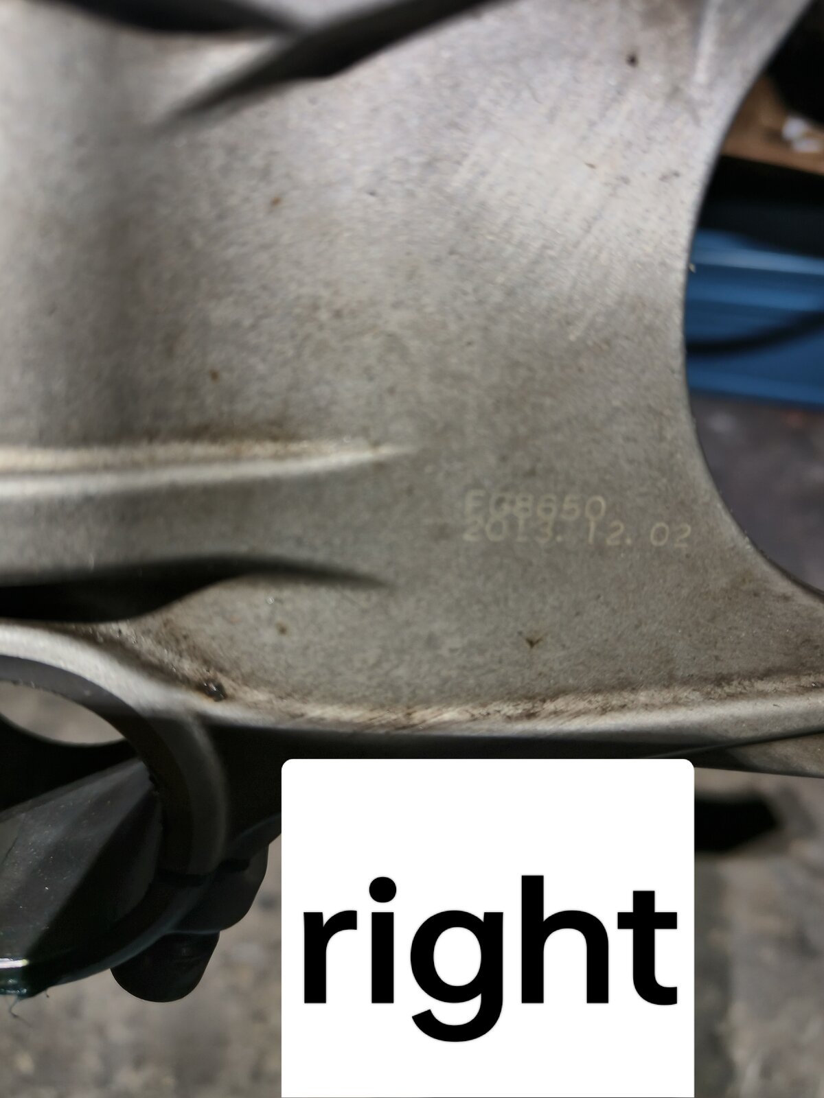

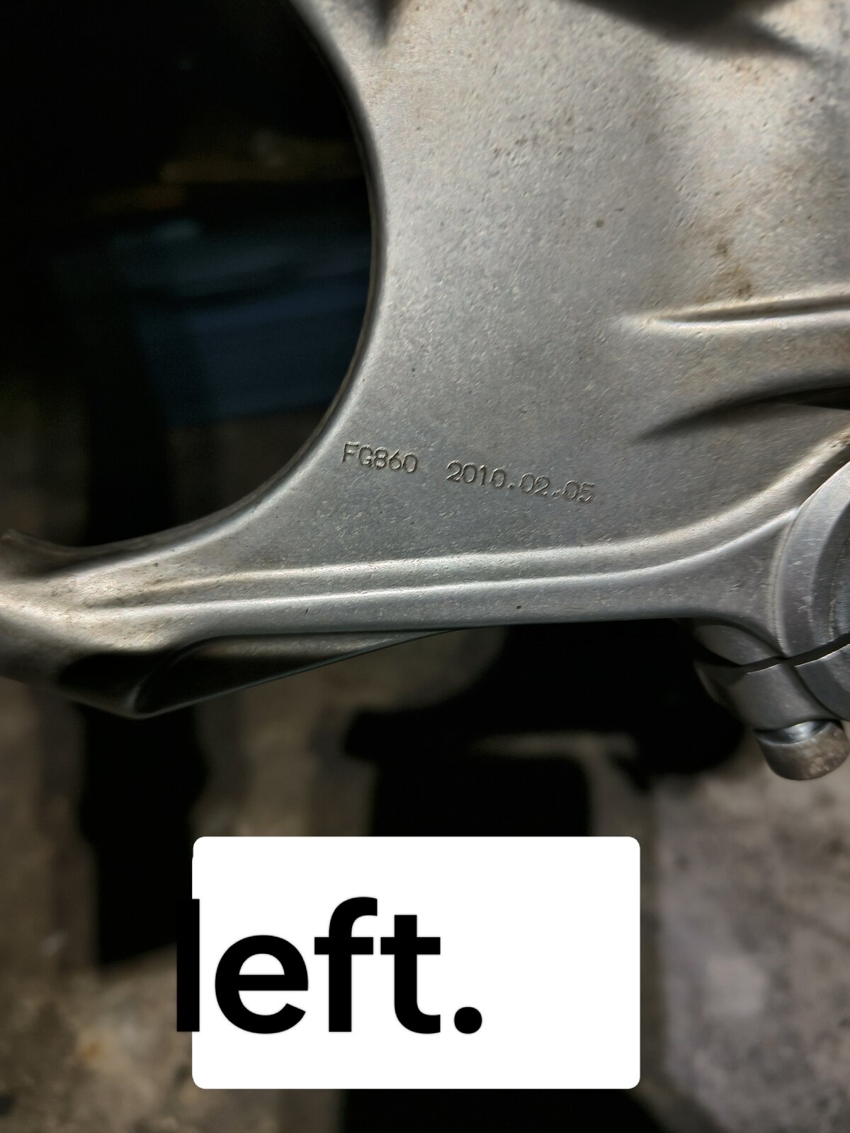

    I've removed my front forks to service them and I've noticed the model number is different on each leg.
    Is this normal or something I should worry about?
    Just a little more details. I bought the bike second hand so not really sure if something strange happened before.
    The right one if you're sitting on the bike marked fg8650 has been the one that has given me problems. Even if it seems to be the newer one dated 2013.
    Leaking twice in the span of one year.

  2. So it looks like they may have changed the old right fg860 with the newer fg8650.
    And ironically enough( not for my wallet or state of mind) that's the one causing trouble.

  5. Their different product numbers to indicate the difference between left and right fork bottoms.
    Unless decent quality seals such as Ohlins, SKF or NOK (who I’m sure make Ohlins seals) or Athena are used Ohlins forks are very prone to leaking. If the mechanic used a cheap AllBalls kit they’re bound to leak.
