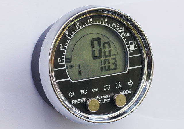

  2. Have a look at the offerings from Acewell, I believe they do a small pod mounted speedo/ tacho. The speedo operates off a hall sensor which they supply as part of the kit.

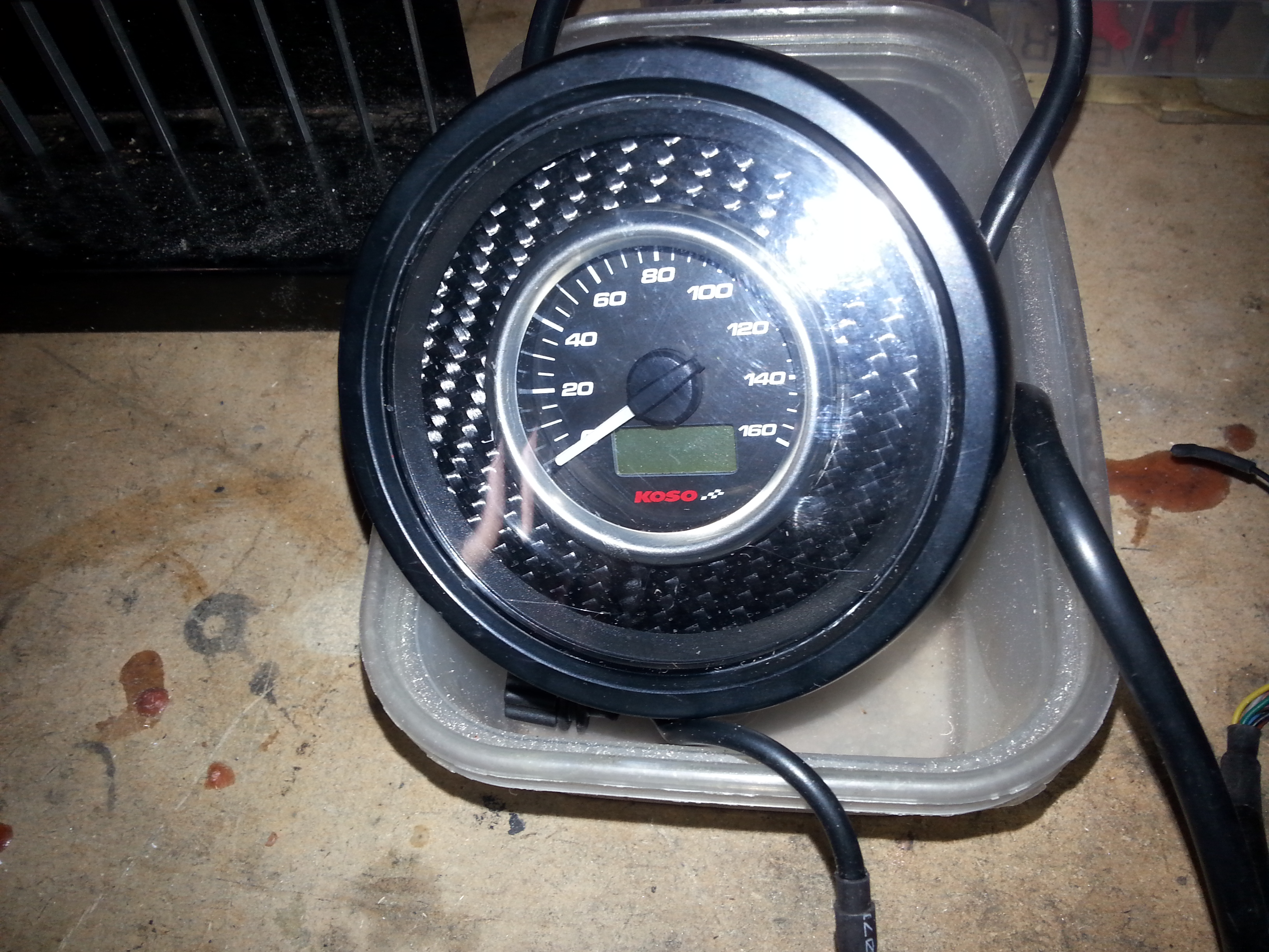

  4. hi borgo , i put this electronic speedo into 748 clocks ,just opened up the original and replaced the innards,
    a bit fiddly but fairly straight foward . cut out from sheet of carbon fibre . hope this helps
