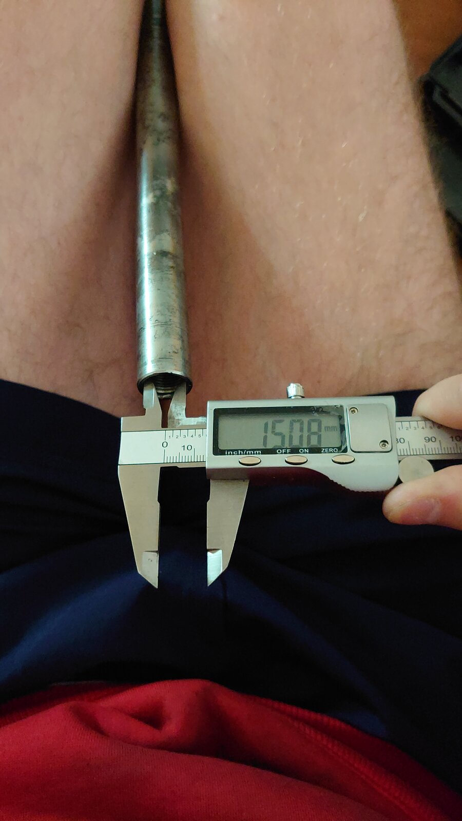

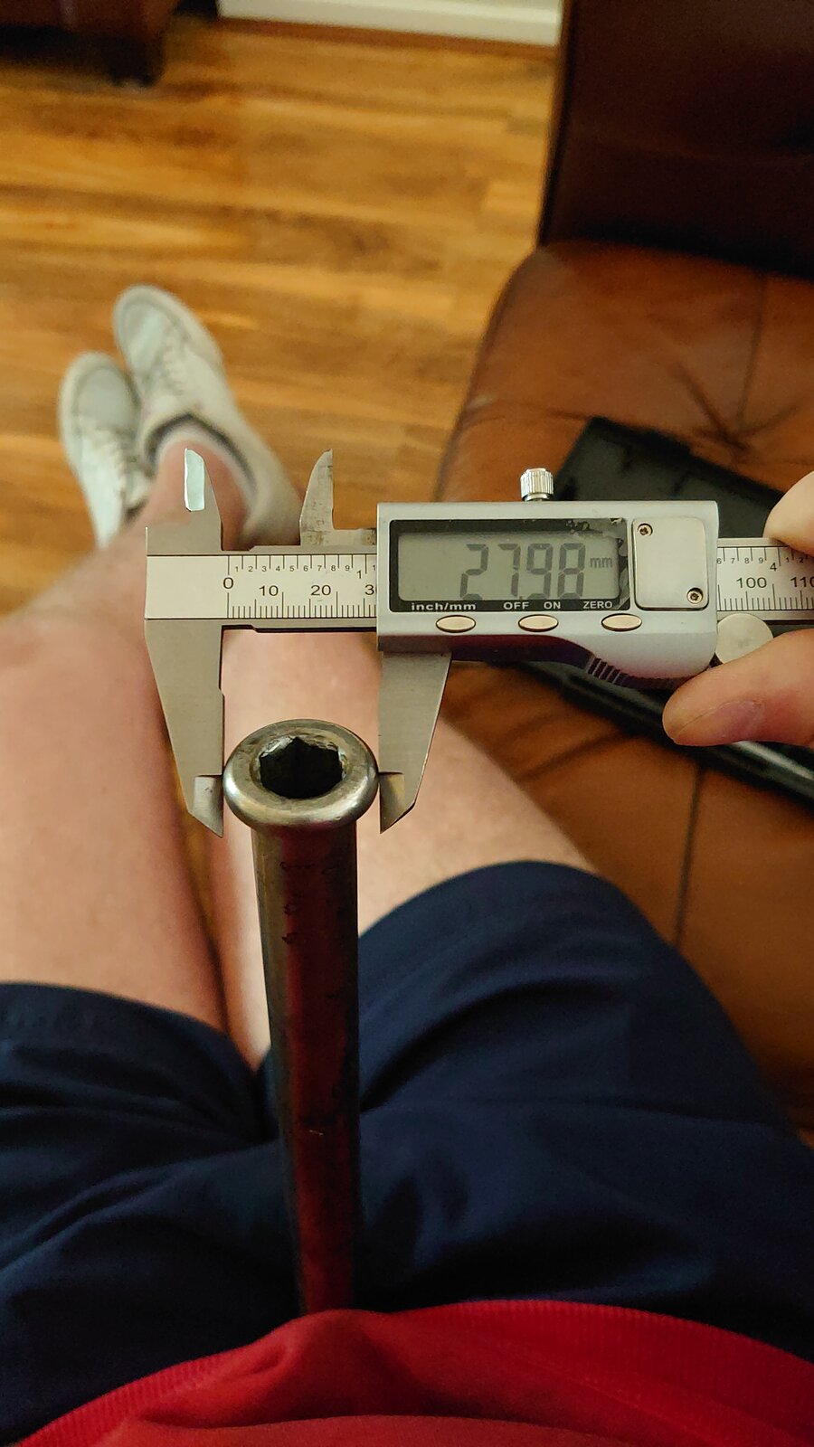

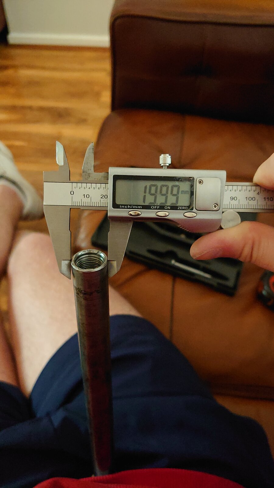

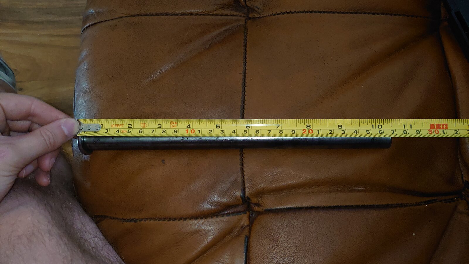

Diameter shaft - 20mm Diameter end - 15mm Diameter shoulder - 28mm Length shaft - 260mm Length shoulder - 5mm I think the thread pitch is 1.5mm but don't quote me on it as my Vernier isn't that accurate after the decimal point. Hope this helps bud.
