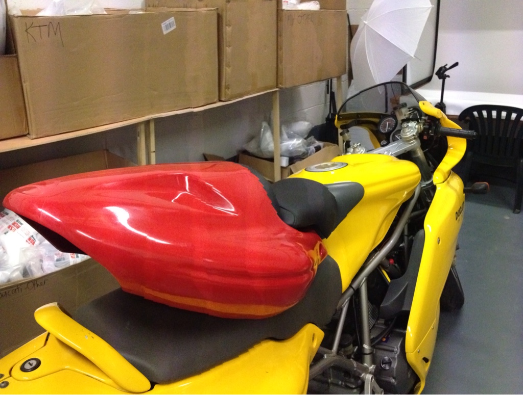

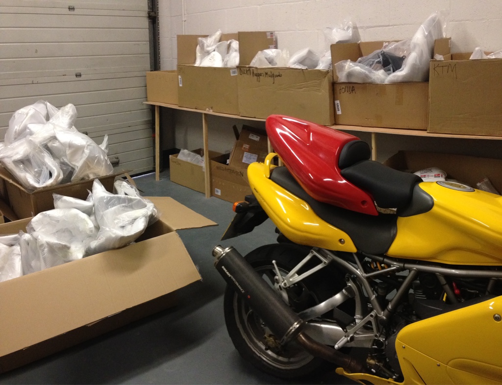

  1. So I am going to update my bike aesthetically and also make it look more sporty. Single seat unit is the first change.
    First thoughts are great I don't need to have the fake exhaust air vent grills as you need to cut the holes out and put the mesh on.
    But then I thought it may look odd having scoops without vents. And actually it does get a bit hot under there sometimes anyway.
    More later on weight saving, ease of fitting and overall satisfaction but for now, cents or no vents?
    [​IMG][​IMG]

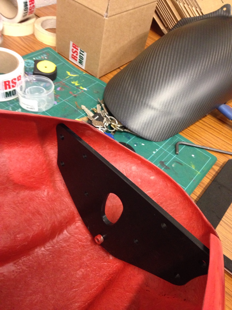

  4. Tell you what though the fitting on this thing is like a rubiks cube. You can't seem to get the under tray back on without blocking the access for the lights and rear mounting bolt. And if you put the lights on first you can't access the mounting points for the under tray

  6. Done the weighing in and there is a massive 1kg saving on this unit compared to standard, so the saving is really in the removal of the grab rail, which weighed nearly 1kg. Quite thick compared to the ricambi Weiss stuff and the base on the seat seems very thick.
    Comes with a good mounting point for the lights which fits well
