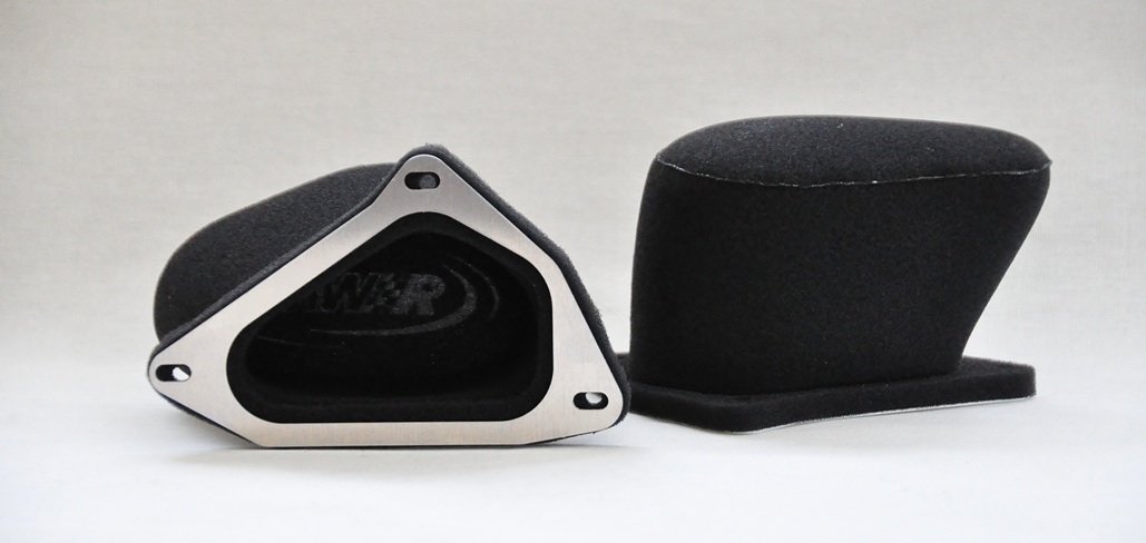

  6. Hi, I've run most filters out there, the only one that keeps the inside of my airbox spotless is the MWR individual filters.
    K&N with it's extra end seals wasn't too bad but all the rest let loads of dirt past. If you don't wan't to change filters,spray an oil based chain lube on the inside surface of the airbox to trap dirt that gets ingested as it tends to bounce of the inside surfaces first, but you'll have to clean the airbox regularily.

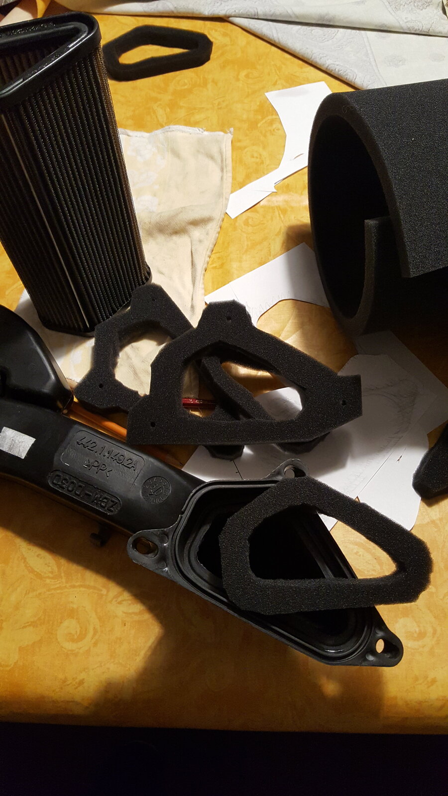

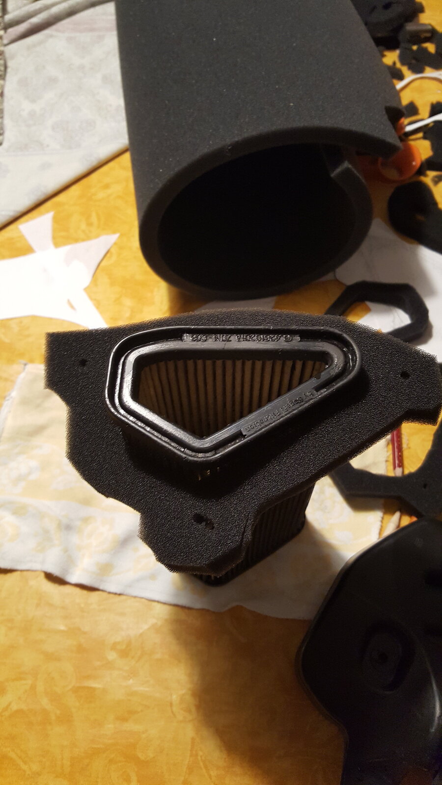

    I opted therefore to build my own gaskets/seals, as shown in the images below. On each side, one gasket seals the gap between manifold and filter, the other seals the gap between the manifold and the airbox.
    For 7EUR, I bought a raw air filter foam mat from Louis and cut it myself:
    https://www.louis.de/artikel/variante/luftfilter-matte-universal-750x500x14mm/10050855

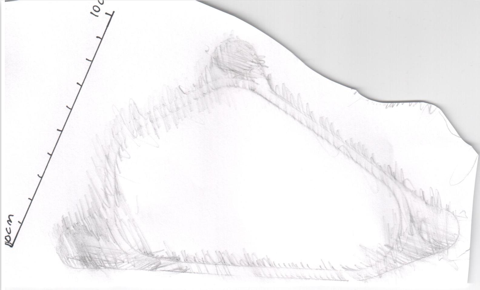

    I include a blueprint of the manifold with a 10cm reference scale which can be useful to cut out the parts before taking apart the bike. I hope this can be useful for somebody.
    The inner gasket:
    The outer gasket:
    The blueprint (see attached pdf for printing correct scale):
