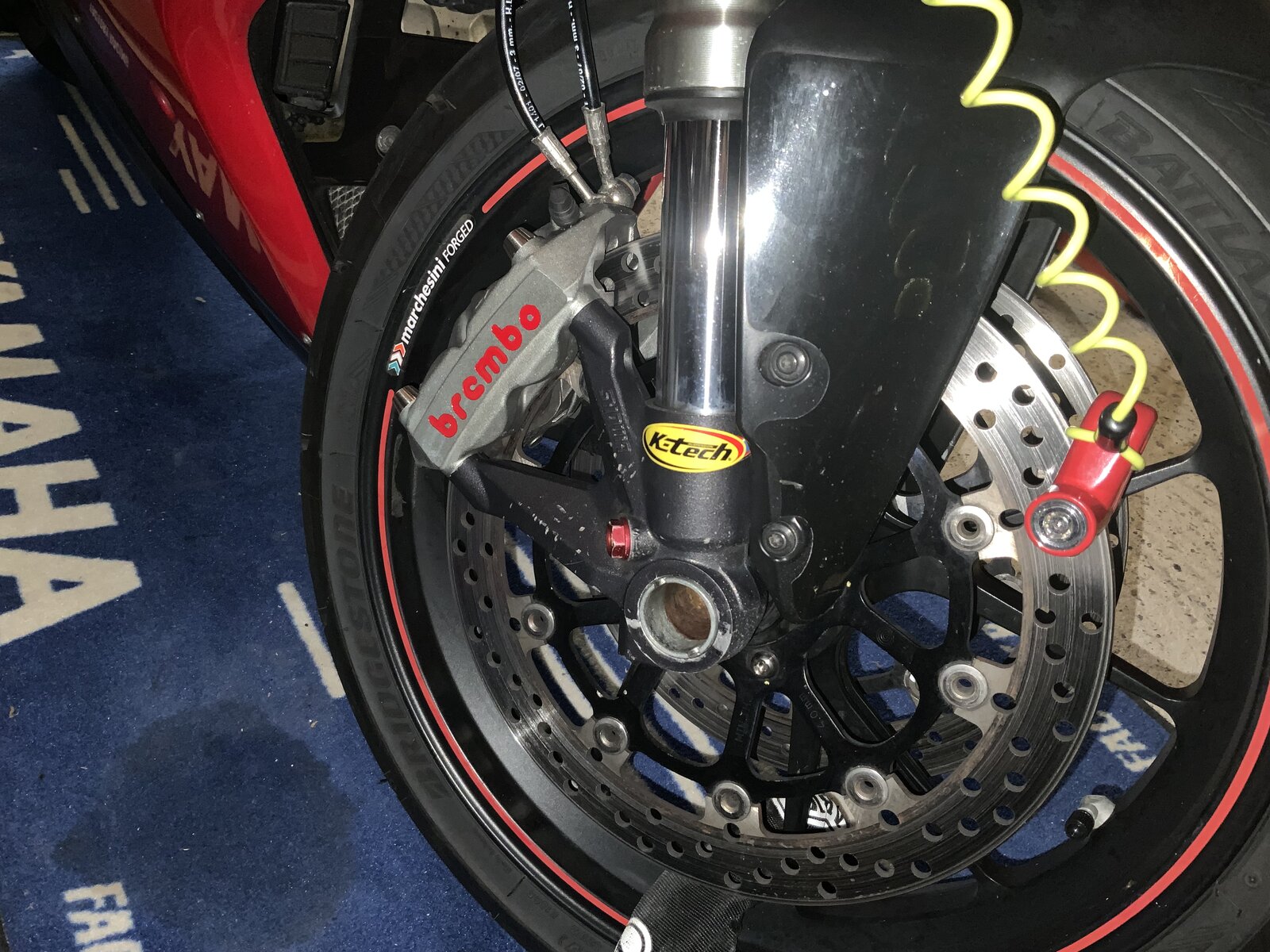

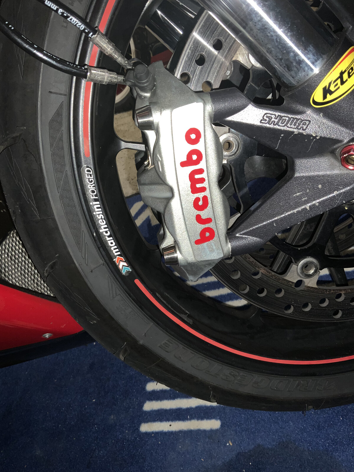

  8. Am I correct in thinking they are not standard callipers?
    0F32BBB4-6DC1-476A-A94E-6E0A2A212795.jpeg 62B66C07-8D39-416A-B69E-ADCD37C31092.jpeg 3E2B40E1-0D17-4284-BA98-57FCE745BA32.jpeg

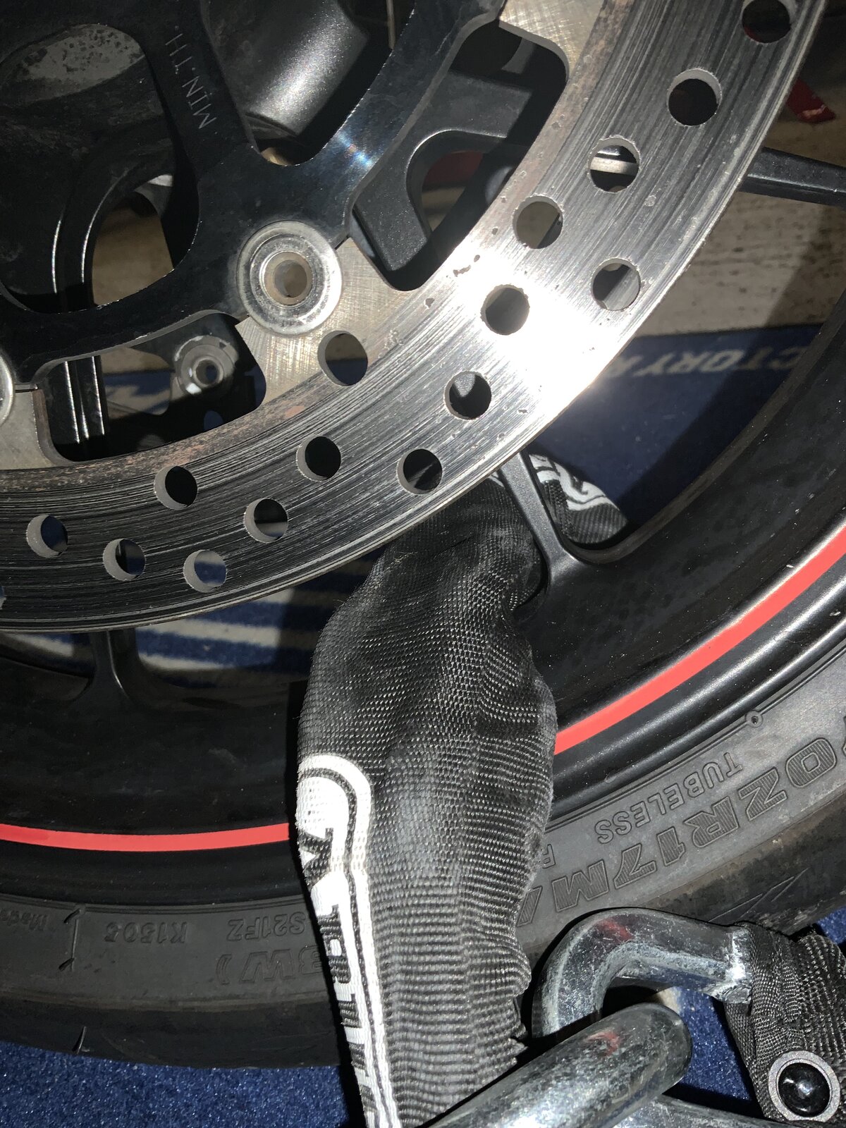

  9. I'd be inclined to compare that inner 5mm or so of disc surface, which looks as if it isn't being swept by the pads, with the same area on the other side, and the same again on the other disc. I don't know how this should look with these brakes, but it's not uncommon to see car discs, especially on the rear, which have a scabby stripe around them where a chunk of pad is missing, or whatever. It's easy enough to check the pads anyway. Otherwise my inclination would be to treat this as mainly a question of cosmetics, although I'd check the disc thickness in a few places with against whatever the minimum specification is.
  10. I’m planning on a full strip down over the winter, I’ve got a new master cylinder and hoses to fit so I’ll take a look at the pads and check the piston movement ect then.
    I do like the bike to look it’s best but I won’t compromise on parts that look better than they perform if that makes sense.
  11. M4 calipers are standard on 848 Evo.
