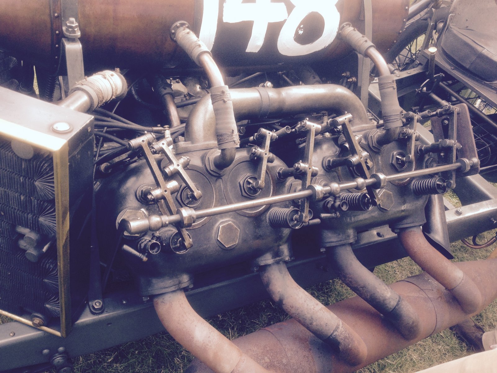

    but then again what would a motley crew of hill climbers know when up against a god-like eminence of knowledge on a Forum such as this?

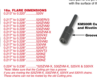

  8. I have the one in the Bickers catalogue reference number 5914609, which I think is the Powerite one.
    Used it twice so far, seems to do a perfectly good job.............but as Duke Desmo says, grind the old link rivet heads down first to avoid unnecessary 'damage' to the tool.
    If the chain is DID, the attached image might be useful.....
