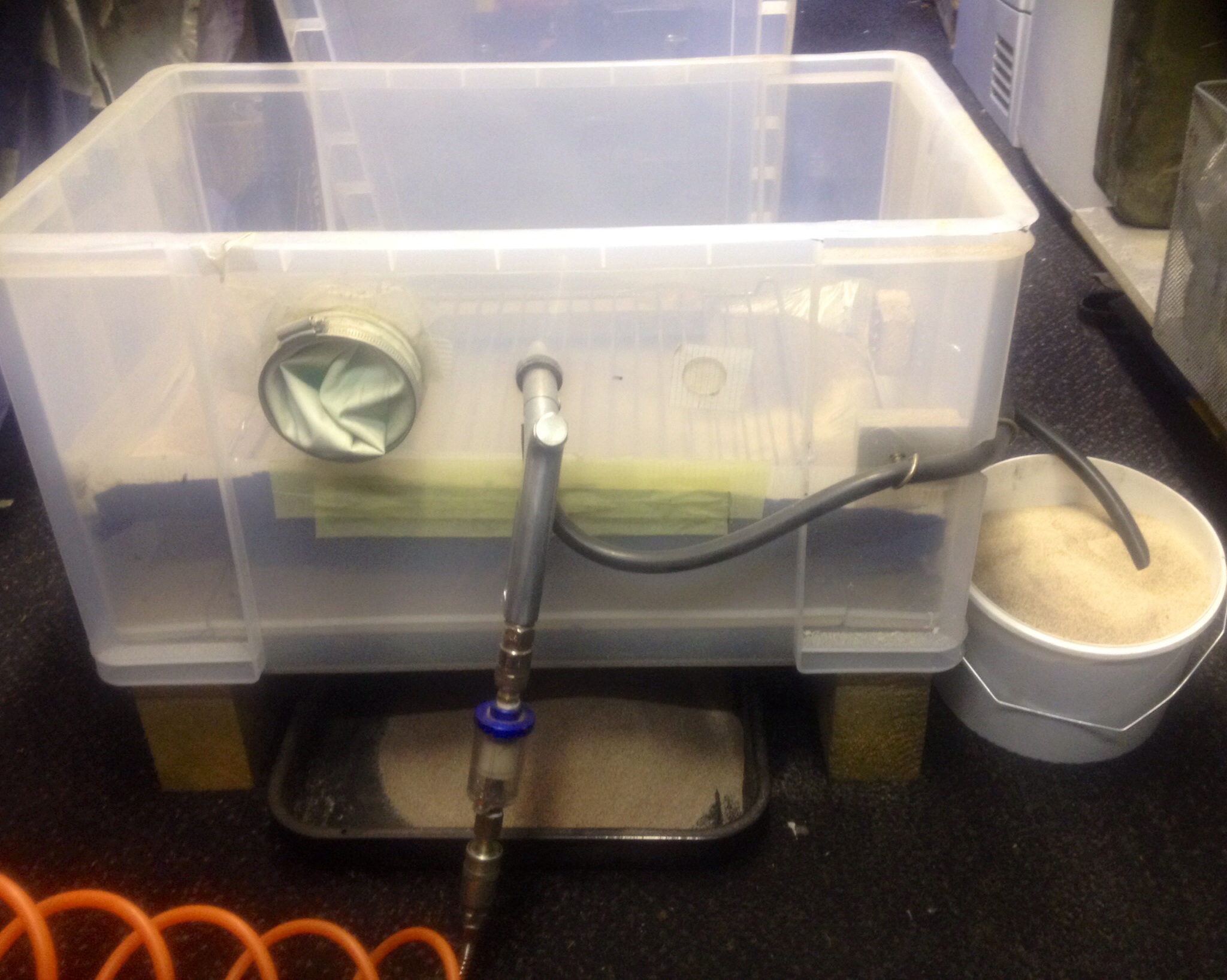

    After covering the entire neighbourhood with a dusting of sand I decided to set about building my own sand blasting cabinet to clean up parts during my current restoration..
    The great thing about the box is it allows me to clean
    Parts inside my workshop now rather than outside, with no goggles or air
    mask required, plus, your grit keeps nice and dry, which in itself is vital..
    Took 3 hrs to build and minimal cost..
    Started with a £20 B&Q storage box, fitted two wooden legs on the base.. Cut a small hole in the centre of the base and fitted a small plastic funnel to drain out the sand ( optional) fitted a couple of wooden runners inside the box and attached an old oven grill to it via two small picture frame hinges.. Cut a hole in front panel and fitted a rubber grommet to allow blast gun in... Also made it so if I want the whole gun inside the box I can.. Cut A 3.5 inch hole in front panel, using an old gravity spray gun pot I cut the top inch off and used this to attach a rubber glove to via a large jubilee clip.. Used an old baking tray underneath to catch sand .. Also used draught excluder here and there to seal tight.. Attached pipe to air line with water trap... Connected dry grit line to gun... image.jpg

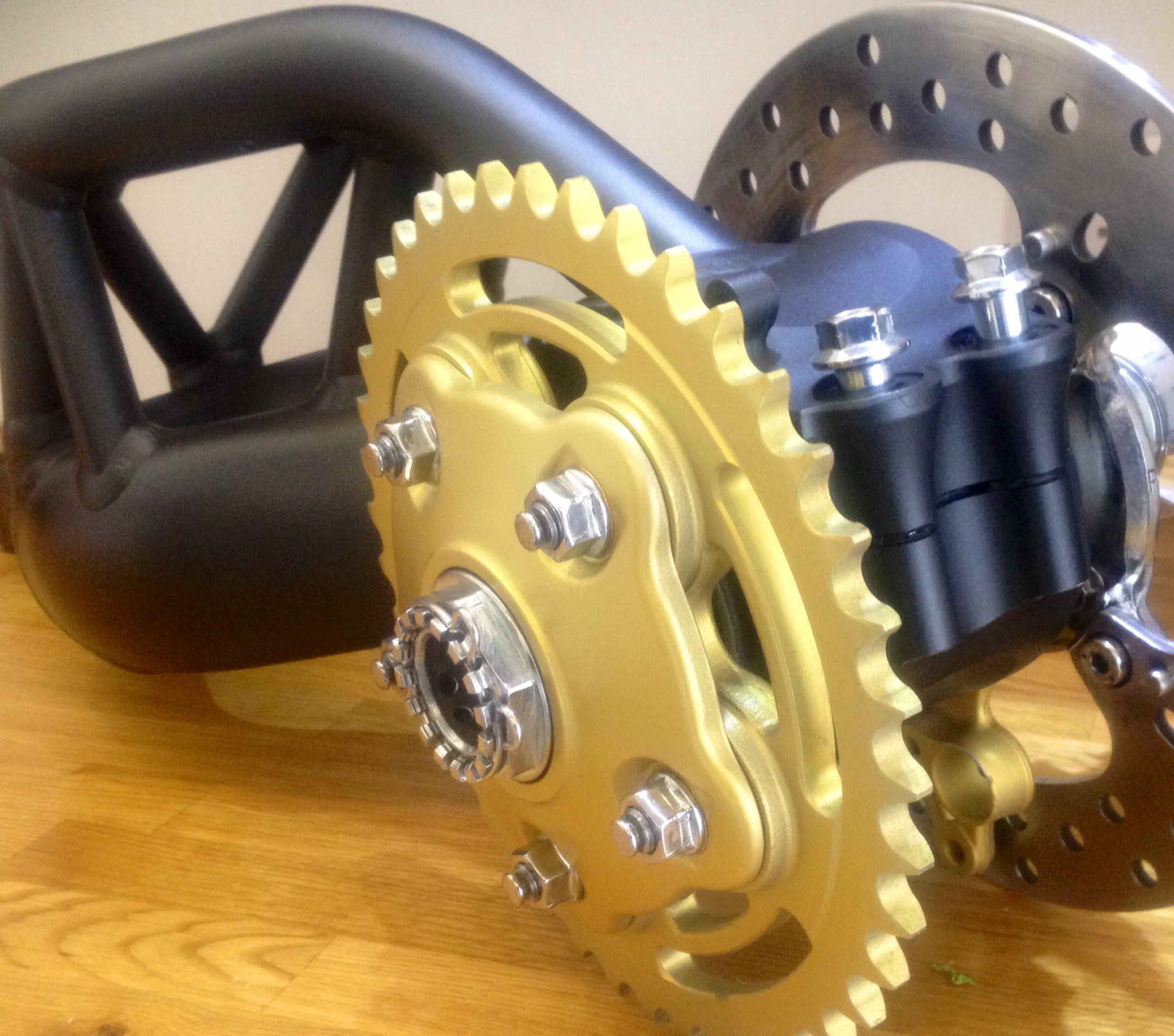

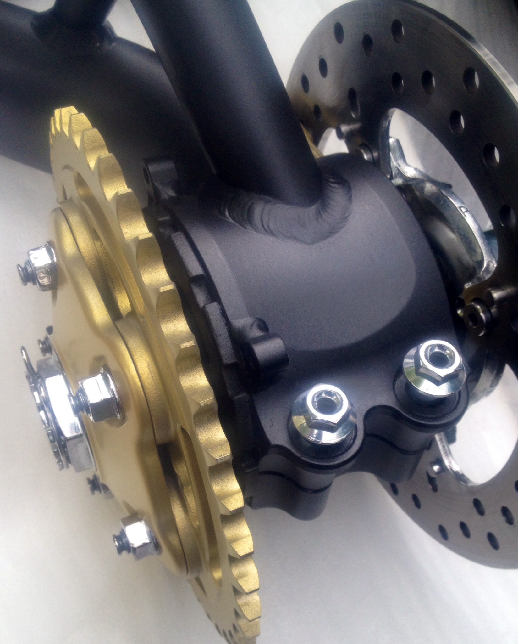

    This is the paint and primer stripped sample..
    B&Q Box
    Front view
    Glove attached and hinged baking tray.. image.jpg Gun and glove attached
    From above.. Plastic lid of box off.. Hinged grille open.. All ready to go..
    The only mod I'm going to make is to cut out a window in the lid and insert a glass view window as the plastic makes it difficult to see..

    I have a little sand recycling system going.. The used sand goes in the tray underneath.. It's then poured into a large funnel with a fine filter fitted to get rid of foreign debris.. From there it exits to another big tray which is heated.. The sand/grit is warmed up before going through the process again.. This way I always have dry clean grit ready at hand..
    I don't seem to be getting a dust cloud to be honest.. The lid seals well and the sand goes out the bottom down a pipe and into the tray.. When I put the unit in its perminant home I'm going to fit an exit pipe which leads to a sealed lid container with the pipe entering via a sealed hole in the lid.. That way there's no escape at all ...

  9. It's a 2.5 hp compressor.. Which is jus about fine.. A little bigger would be better.. ( that's what her in doors says lol)
    I'm going to put a piece of Perspex or glass in lid yes..
    it works like a dream.. I'm now going to make a rectangular shaped funnel from an old printing litho plate ( thin polished alum) to allow the grit to just funnel out of the box on its own, from there, down a plastic pipe and into a sealed plastic container which also has the pick up pipe in it for the gun with a t piece in it to heat the sand and remove any moisture...so it will then be a fully recycled system..

  13. Yes I had a demo with one of those at a well know tool store and a bigger one at 150 quid.. To be honest they were very poor... That's why I thought I could do better.. With mine I can have the freedom of using the gun in the box.. Attached to the box and completely outdoors too.. Can completely recycle, filter and heat my sand too.. Plus it's bigger.. 86 ltrs and very lightweight.. Just put it on my bench when using and store all the sand in the box when not in use and put it away under my bench...

  17. image.jpg Glass is going in as we speak.....
    It prepped my swingarm and sprocket etc nicely though...
