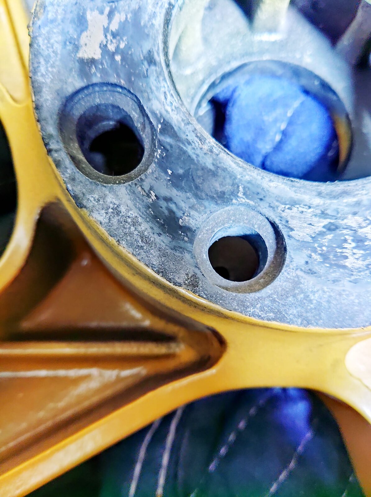

  1. I wouldn't normally start a thread like this, but I've found some wheels on a FB group that I really like. I was ready to pull the trigger until a poster on FB was worried about potential corrosion as well as the axle locating pins being ovalized.
    What do you guys think? Normally I wouldn't be worried but it's a fair bit of money (about 1200 quid) and I have no way to inspect them beforehand.
    285996462_8459005934124925_168489901577603615_n.jpeg 285865037_8459005964124922_4033333630018148181_n.jpeg 285820126_8459006030791582_8725215668362047677_n.jpeg 286292917_8463874860304699_7738412964195727521_n.jpeg

  3. The holes don’t look oval. They’re just the other 4 you’d use in between. As far as Mag Wheels go, they don’t look bad but for piece of mind, you’d need to get them crack tested first.
  4. I personally wouldn't go near period (old) mag wheels, unless they'd been recently refurbished and tested.
  5. The oval holes are just coring out to reduce thick sections and uneven shrinkage in the casting process, but as the other guys have said, they need to be tested thoroughly for cracking and any other damage
