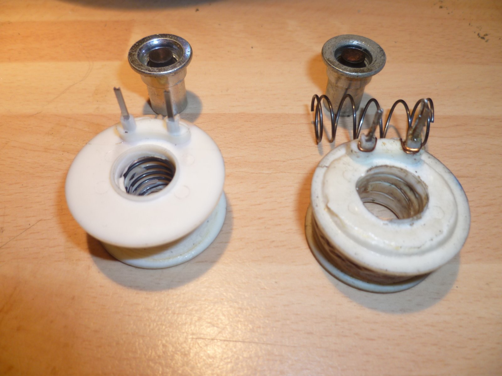

    The Bike stopped on the way to work, I had it dropped to my local dealer who diagnosed the fuel relay, (one of the three that rot out) and then told me the bike was not charging. They swapped out the regulator but then told me it was the generator. Not having £500 to invest in the bike before Christmas they returned the bike to me with the original regulator fitted and the bike was charging.

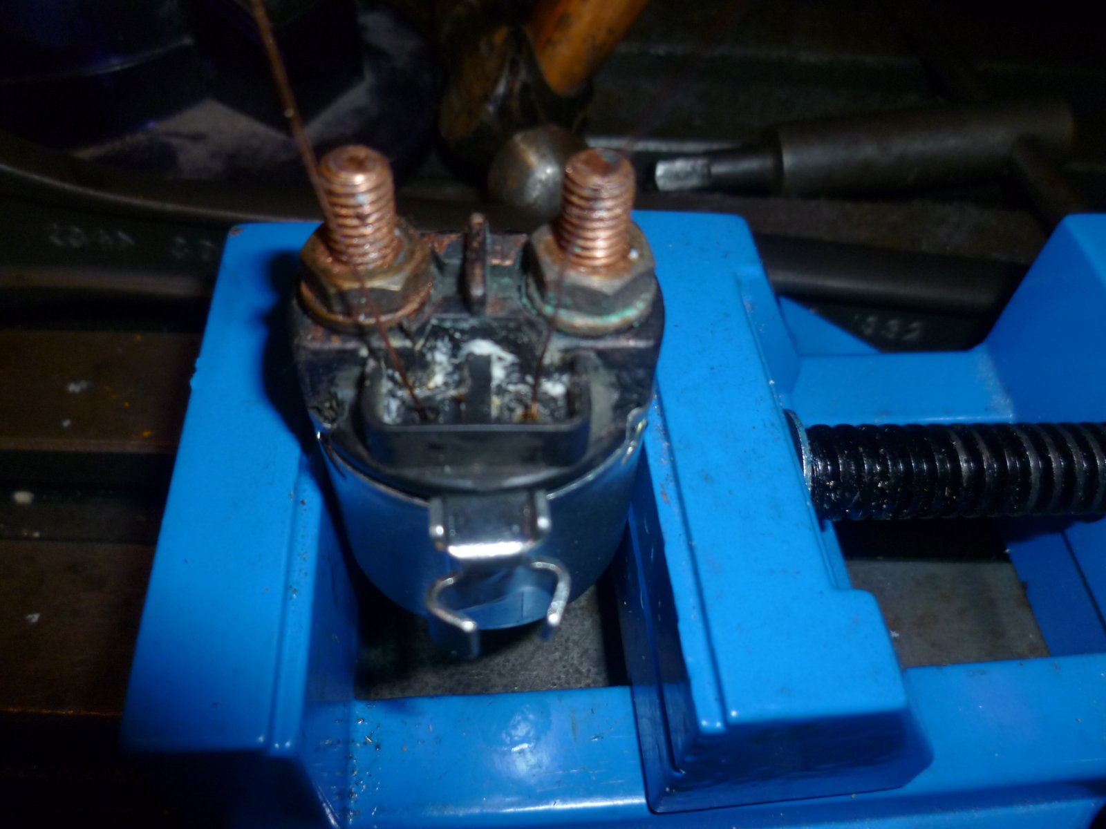

    The following day the bike would not turn over and code 19.2 came up which is the starter relay. on investigation the coil had melted jamming the solenoid I did a quick fix and got the bike going again. It did not last long, I fitted a replacement but this burnt out within 48hours. With the new solenoid fitted the bike started and ran fine but it would run on for a bit when turning it off with the key or kill switch. The battery is kept fully charged on an optimate, I believe the solenoid is still getting power when the bike is running not enough to energise but enough to heat and melt the armature, it is possible that this drain was enough for the apparent lack of charge reported by my dealer.
    It is the ECU that energises the solenoid so my thinking is that the ECU is not getting an engine running signal If anyone has any ideas it would be appreciated.

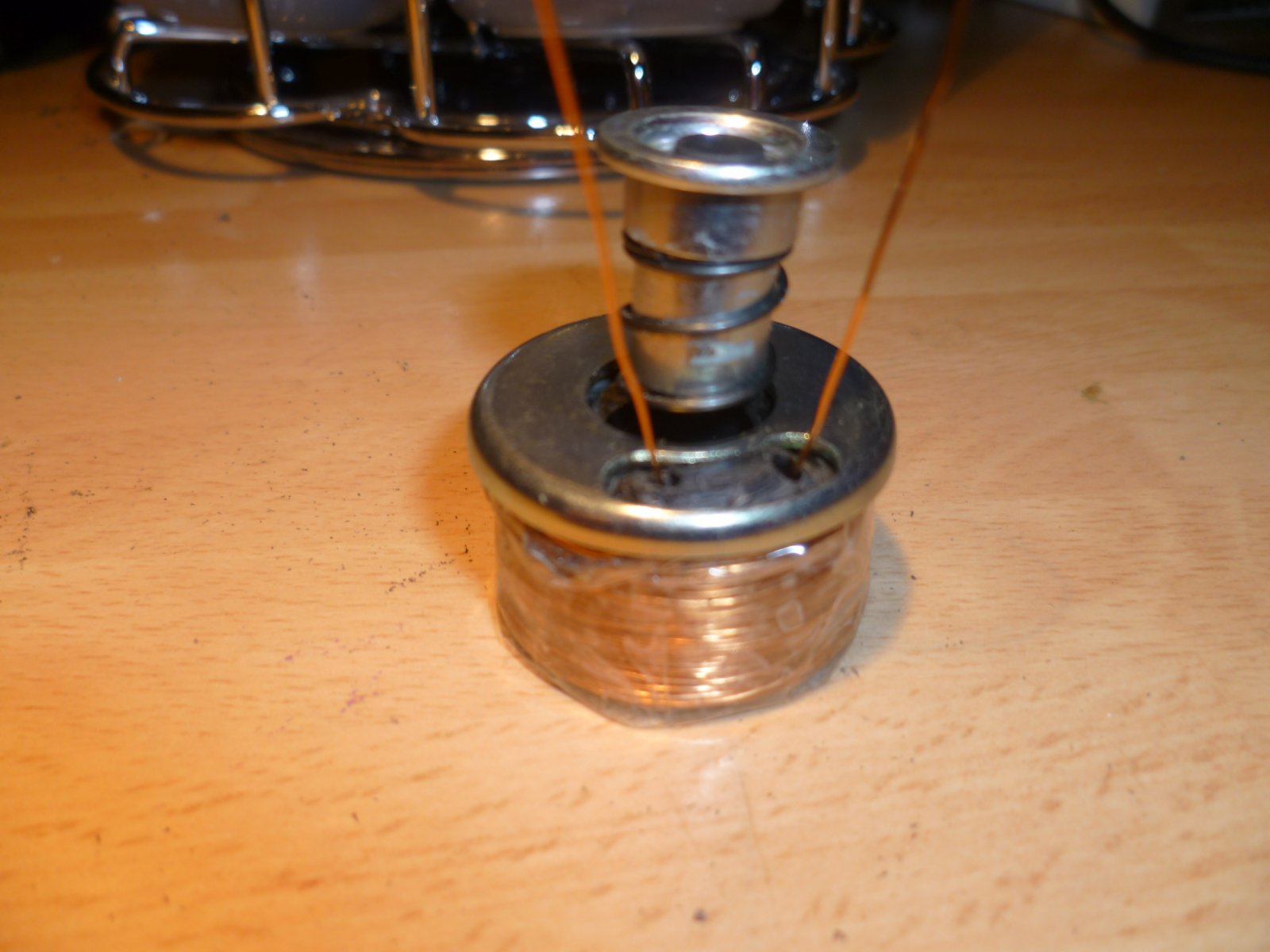

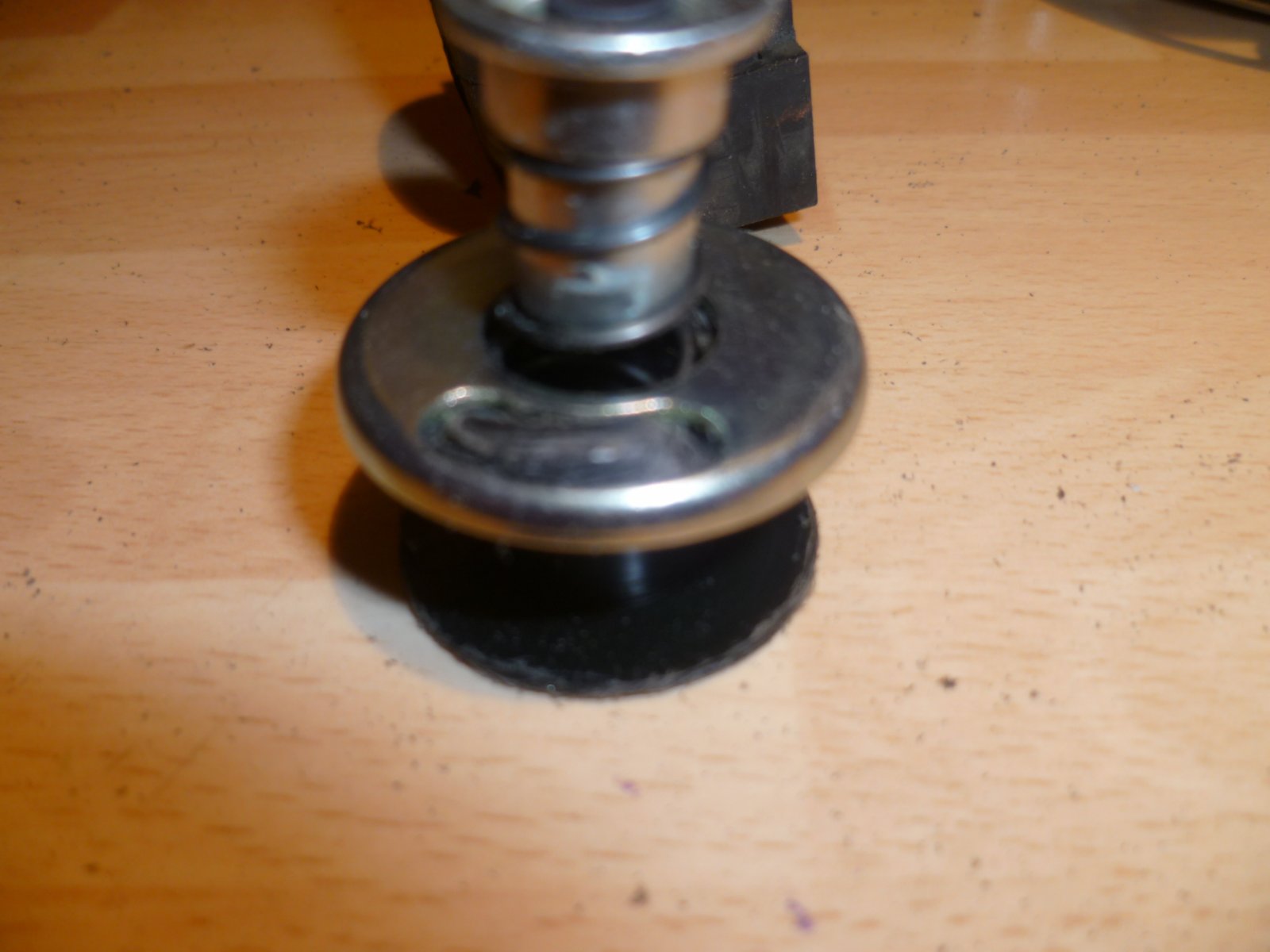

    Having already burnt out one replacement relay at £63 I am rewinding one and intend on wiring in tails so I can attach a multimeter will let you know how i get on.
    Cheers Rob
  13. I have rebuilt one of the solenoids with a home turned coil and built in test leads. The bike starts and runs the starter disengages but 12v remains on the coil whilst the bike is running.
    Now I need to find out why, my thought remains that something is not telling the ECU that the bike has started but then I would not expect the bike to run properly, I also do not understand why it does not keep the starter motor engaged.
    Any thoughts appreciated cheers Rob
