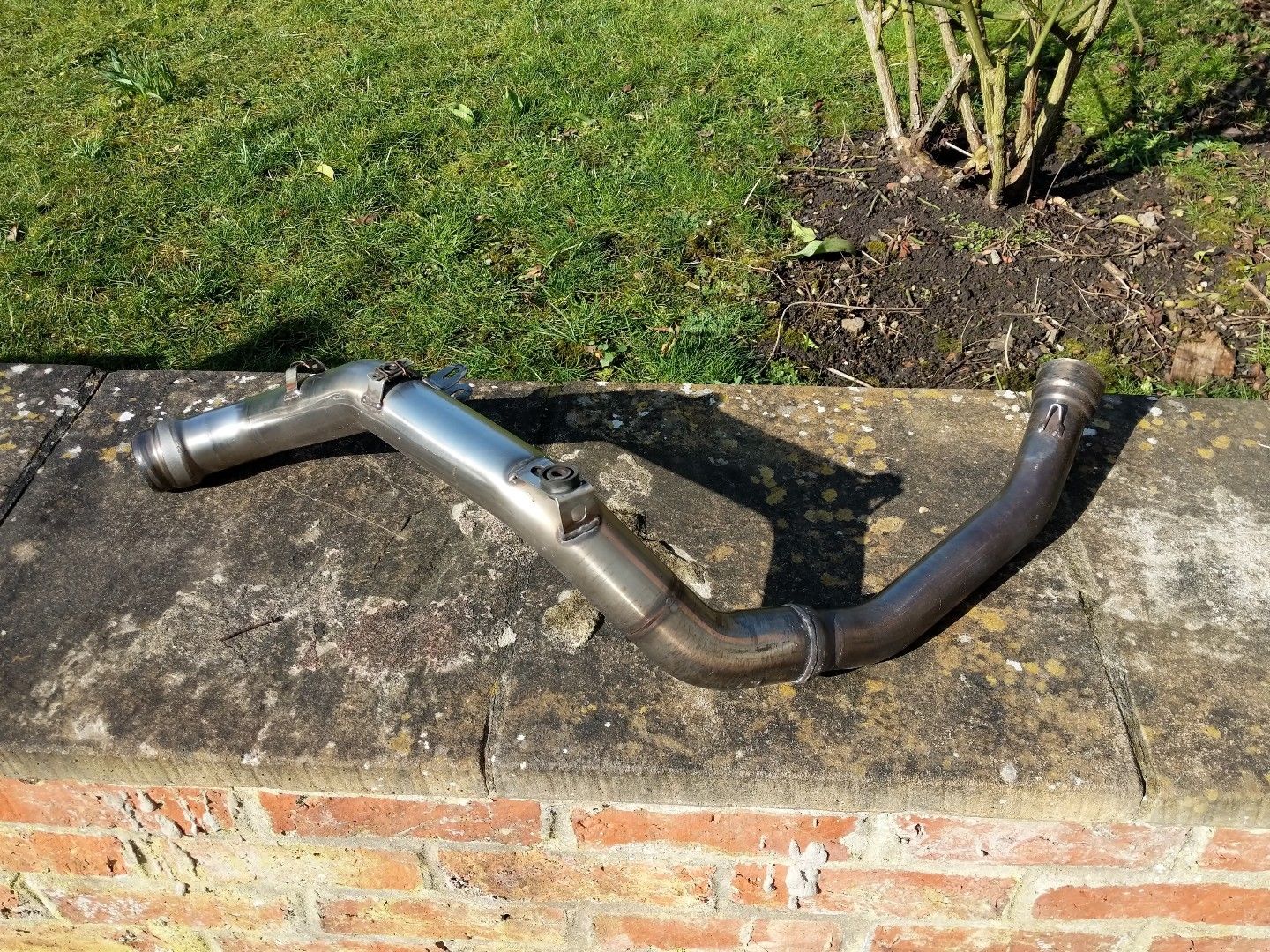

Thanks. Would it fit when I replace the horizontale pipe by this one? https://www.ebay.com/itm/Horizontal...793101&hash=item342da58062:g:MKIAAOSw6~dfJ8us

That is a stock link pipe with Cat. You need the non-deep sump front link pipe with no Cat. Think this is the correct one

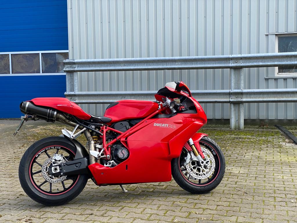

My 749S has currently a hand made system on it and I want to replace it by a Termi (just for the looks..) And the point is, a termi system for sale is quite rare. This is the only system in Holland as I can see now. Current system installed:
Just to complicate things. You need the later front link pipe for the 749/999 with the black swing arm. Good luck.
