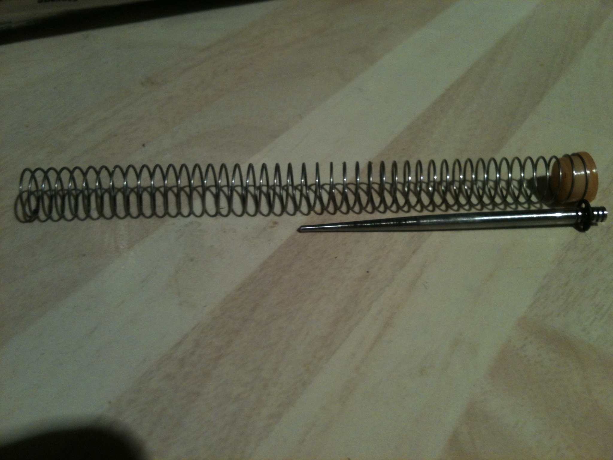

  1. Hi all,
    As per title really, does the pic look like a dyno jet kit?
    I suspected that my 600ss had a dyno jet kit fitted and was told that it does, but the carbs were never stripped to prove...
    So can anyone tell me if it is or isn't from this? My thinking, looking at previous posts etc is that if it is, it'll fit the 750

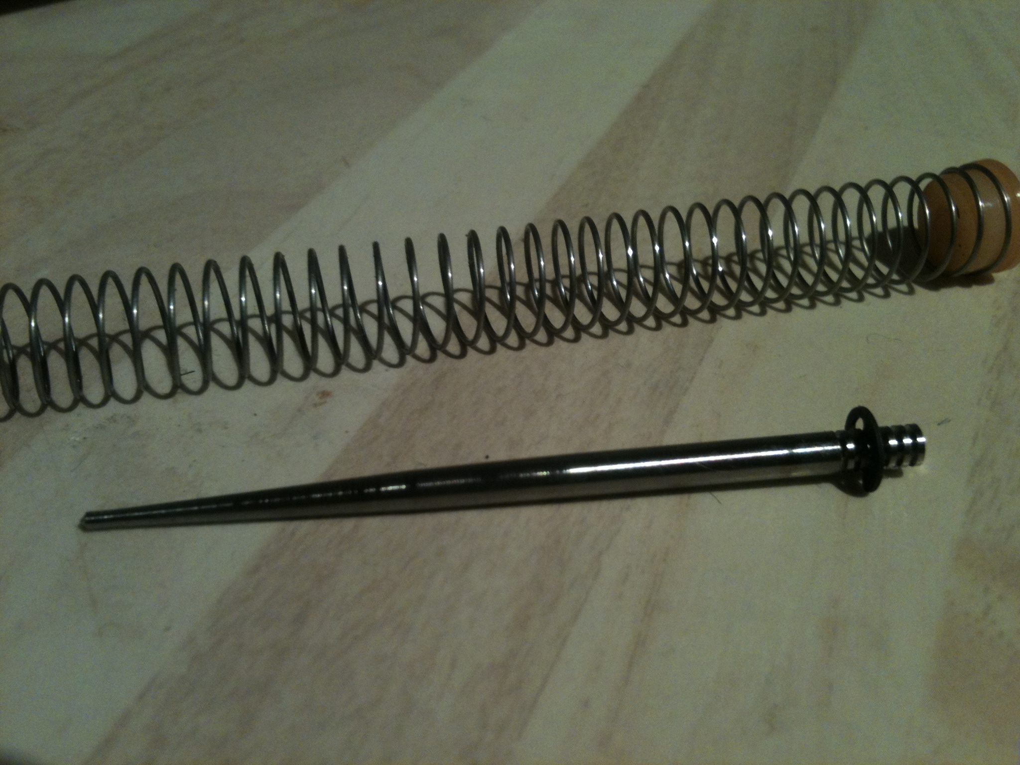

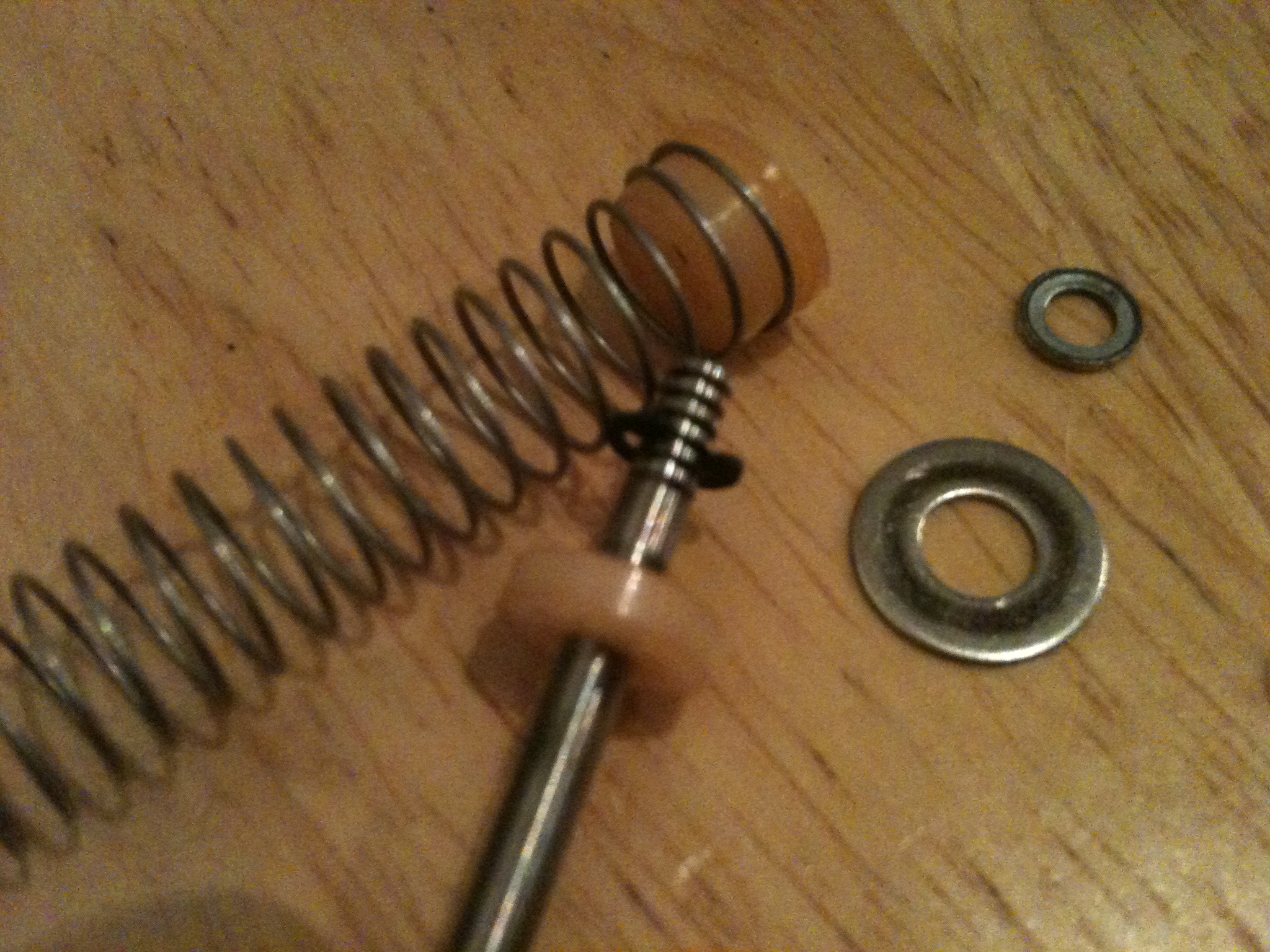

  2. Not at home to look but clue is no markings on needle and a darker colour than standard and a pointy end that is more pointed than standard generally (depends on spec of course). Spring is thinner gauge, less windings and longer than original. The spring does look like a Dynojet version but couldn't commit 100%
    Edited description due to memory failure

  3. No markings on the needle, not sure on colouring though as I've not much to compare to!
    Thanks for the help :)

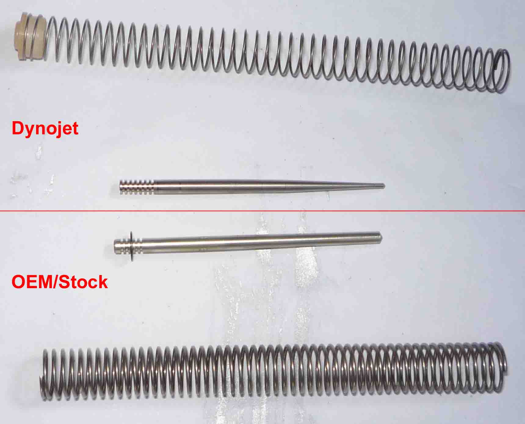

  4. Here ya, Ben...............make your own mind up.....;)
    AL
  5. Awesome :) cheers Al! That's made the winter mods a damn lot cheaper and easier :)
