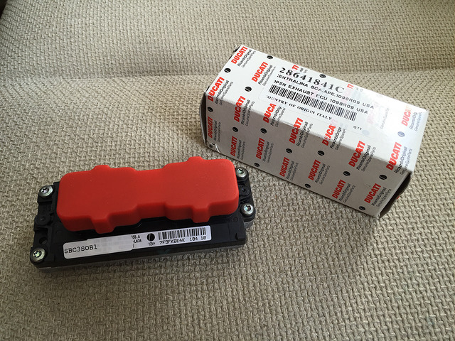

DP 1098R Race ECU that came with the 70mm Termi full system. Brand new, never used. Can be reprogrammed by the likes of CJS/MotoRapido etc. £65 incl delivery in the UK. Payment by BT.
Nope, not "as is" without a remap, 1098R mapping is for twin injectors per cylinder, yours is single injector. It will physically fit though and will be ok after the correct map is installed.
How much for a remap do you think? Otherwise it is good for my 1198s? Thinking as a spare since my old DP ECU died the other day.
From memory, anywhere from 200 for a std DP map up to 450/500 for custom mapping depending on who does it. These rates might be out of date nowadays though? You used to be able to do it yourself with a set of OBD interface cables and DucatiDiag software but AFAIK you can only use this software for diagnosis now and are unable to upload maps anymore as the map library has been shut down due to some licencing issues? Link below to freeware site if of interest to anybody: JPDiag
